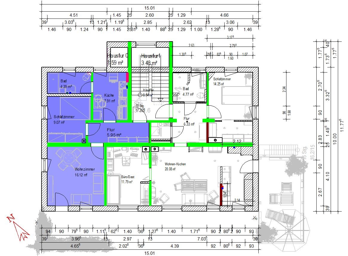

I live alone in a 66 sqm (710 sq ft) apartment and work from home. The apartment includes a combined guest/work/ironing room, all with nicely concealed storage, a bedroom with a walk-in closet (just over 300 cm (10 ft) of wardrobe space), a "large" (28 sqm (301 sq ft)) living/dining/kitchen area, a small bathroom with a spacious walk-in shower, and a small storage room for laundry, supplies, and vacuum cleaner. The hallway has enough space for my 2 to 3 season jackets used alternately, a large shoe cabinet, and to welcome guests. There is also a large 24 sqm (258 sq ft) terrace — more like a balcony since the apartment is on a hillside — with my garage located underneath.
It is a renovated old building that I rent, which was renovated according to my preferences.
Floor plan:
Floor plan:
