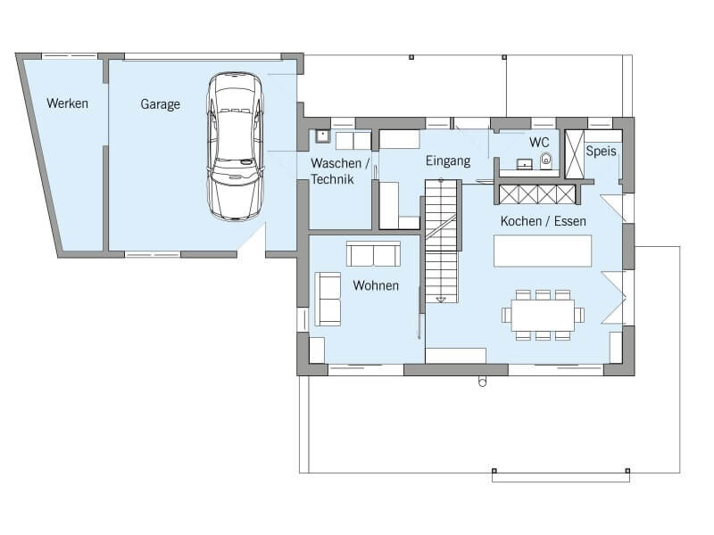

I have been quietly following for some time and would now like to take the opportunity to gather some tips and advice. We are currently planning our house and would like to share our initial drafts with you.
We are completely flexible in the planning and want a functional home for 4 people. Important features for us are a kitchen island, fireplace, and walk-in shower on the ground floor.
We would appreciate any tips and suggestions, as we have never planned or built a house before.

icarus123 schrieb:
The bend along with the bend protection strip also needs to be installed Where is it?
icarus123 schrieb:
It definitely looks great, but we are only allowed 12m (39 feet) in depth… Ah, okayyy... but you still have to leave 5 meters (16 feet) clear in front of the garage, right?
The house has the same modest dimensions as your planned one. The walls are aligned above each other, and there’s no unnecessary detail anywhere. Except for the porthole window... okay, that caught my attention 🙂
I
icarus1239 Mar 2023 15:03I
icarus1239 Mar 2023 15:44K a t j a schrieb:
In front of garages and carports, as far as I know, only 3m (10 feet) are required. Exactly, according to the development plan, 3m (10 feet) to the access road.
I
icarus1239 Mar 2023 15:51K a t j a schrieb:
As far as I know, only 3m (10 feet) is required in front of garages and carports. But be careful with sealing. The floor area ratio of 0.25 is taken very seriously, I’m afraid. Exceptions only apply to terraces up to a maximum of 30m² (320 ft²). The 0.25 FAR mostly applies to about 560m² (6,000 ft²) for us, because the bend plus strip has to be deducted here! (We asked the local authority, there seems to be a new guideline)
I find the entrance area in your design unfortunately quite confusing and not very welcoming. What do you think about the option where the staircase separates the kitchen/dining area and the living room? Baufritz has an example of this:
External dimensions: 10.7 m x 8.2 m (35 ft 1 in x 26 ft 11 in)
(You need to imagine the garage removed or placed elsewhere)
