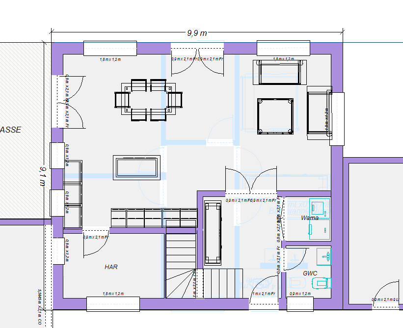

I have been quietly following for some time and would now like to take the opportunity to gather some tips and advice. We are currently planning our house and would like to share our initial drafts with you.
We are completely flexible in the planning and want a functional home for 4 people. Important features for us are a kitchen island, fireplace, and walk-in shower on the ground floor.
We would appreciate any tips and suggestions, as we have never planned or built a house before.

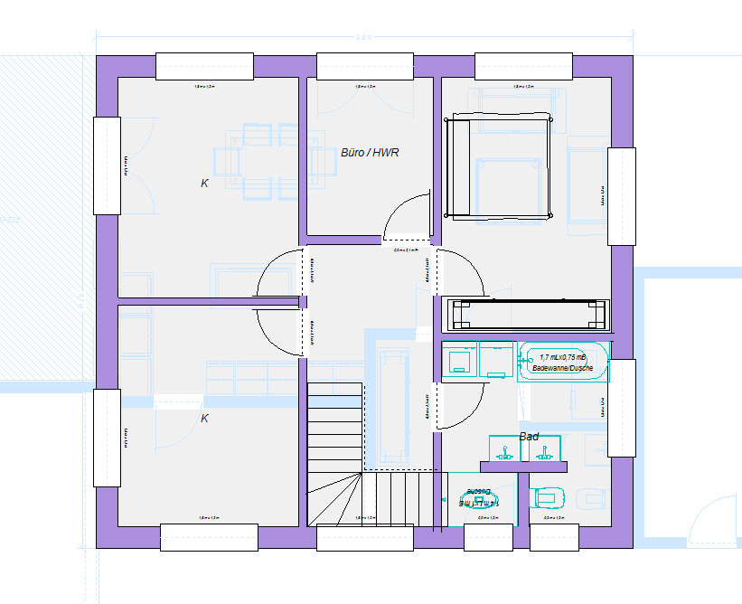

Another draft that stays a bit closer to the original ground floor design.
I’m still uncertain about the best place for the washing machine here. Ideally, it would be in the utility room upstairs. However, the water supply and drainage are more complex there, and the room is actually needed for a home office. Putting it in the bathroom is possible and probably the most likely option, or the small storage room downstairs could be used.
The terrace doors at the top of the plan are for light only. I just want to avoid any confusion.

icarus1239 Mar 2023 07:28K a t j a schrieb:
Here is another draft that stays somewhat closer to the original design on the ground floor.
I’m still a bit unsure about where to place the washing machine. The most elegant solution would probably be in the utility room upstairs. However, the plumbing for water supply and drainage is more complicated there, and that room is actually needed for a home office. Placing it in the bathroom is possible and most likely, or alternatively, the small storage room downstairs could be used.
The terrace doors at the top of the plan are only for lighting. I just want to avoid any confusion about that.

[ATTACH alt="A2-icarus.jpg"]78833[/ATTACH] Thank you very much for your efforts, there are really some very interesting ideas here, including ways to work with the staircase…
However, I also see the issue with the chimney again. We already struggled with that in the original design.
Does that flat-roofed room at the property boundary have a specific purpose?
