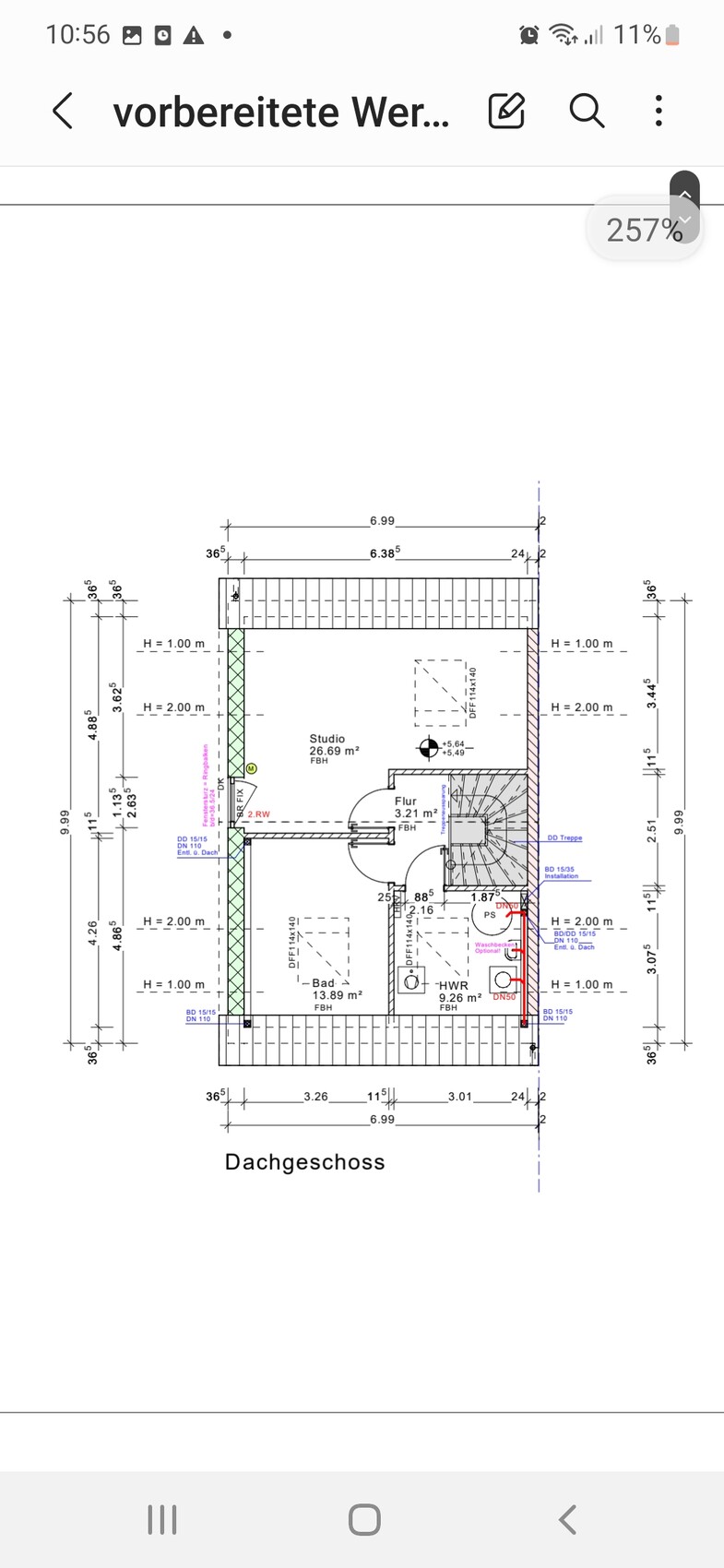

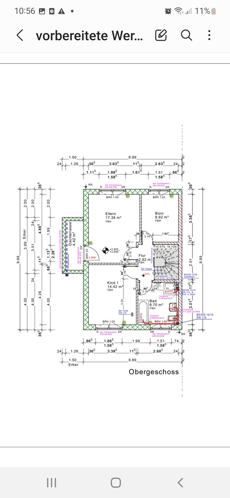

The building permit / planning permission application has been submitted, and now we are moving on to the detailed construction planning. Could you please take a look and let me know if you notice anything? After this stage, no further changes can be made. Doors and window openings, or anything else you might observe?

K a t j a17 Oct 2022 14:39
Bauherrin123 schrieb:
Could you please take a look and see if anything stands out to you?
Ground floor: Cloakroom and storage options on the ground floor are insufficient – a trash area under the stairs seems inevitable.
Top floor: Washing machine and dryer are still placed below the 2m (6 ft 7 in) ceiling height line, close to the 1m (3 ft 3 in) line. The sink is approximately at 1.70m (5 ft 7 in)? This will regularly cause head bumps. Only double casement windows in the bathroom, although dormer windows would be possible.
Everything has already been mentioned and apparently considered unimportant – I’m out. Good luck!
11ant17 Oct 2022 15:37
K a t j a schrieb:
Ground floor: Wardrobe and storage space on the ground floor are insufficient – a trash area under the stairs is almost guaranteed.
Top floor: Washing machine and dryer still placed below the 2-meter (6 ft 7 in) height line, close to the 1-meter (3 ft 3 in) line. The washbasin is probably around 1.70 meters (5 ft 7 in) estimated? That will regularly cause headaches. Only double casement windows in the bathroom, although a gable window would have been possible.
Well, the laundry room in the "attic studio" floor, as drawn, is obviously nonsense. The criticized points (including those from other posts) will probably only reduce the resale value of this interim house but won’t be successfully avoidable. Developers are not good fairies. It’s probably better to use the so-called "bathroom" here, as there is apparently at least a floor opening for a waste pipe planned (even though I do not see it continued in the floors below). I would also accept a gable window there.

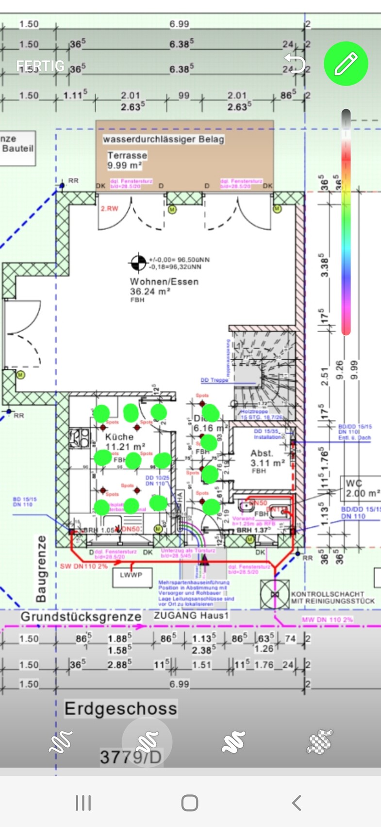

Can someone help me with the spotlights in the kitchen? The plan shows 6. I think that is too few. I’m planning on 9... where should they be positioned?
Thank you
Bauherrin123
17 Oct 2022 23:55
This is my idea... is there anything I should consider? How would you approach this?
I will reconsider the other points mentioned above. Most things I actually want to keep as they are, except for the laundry room in the attic—won't the appliances fit in there, or is there an issue? According to the architect, and from what I’ve seen in another house, everything fit fine.
I am still bothered by the fact that the attic has such a low ceiling height that the floor joists can’t be lowered. I don’t understand why that’s not possible.
