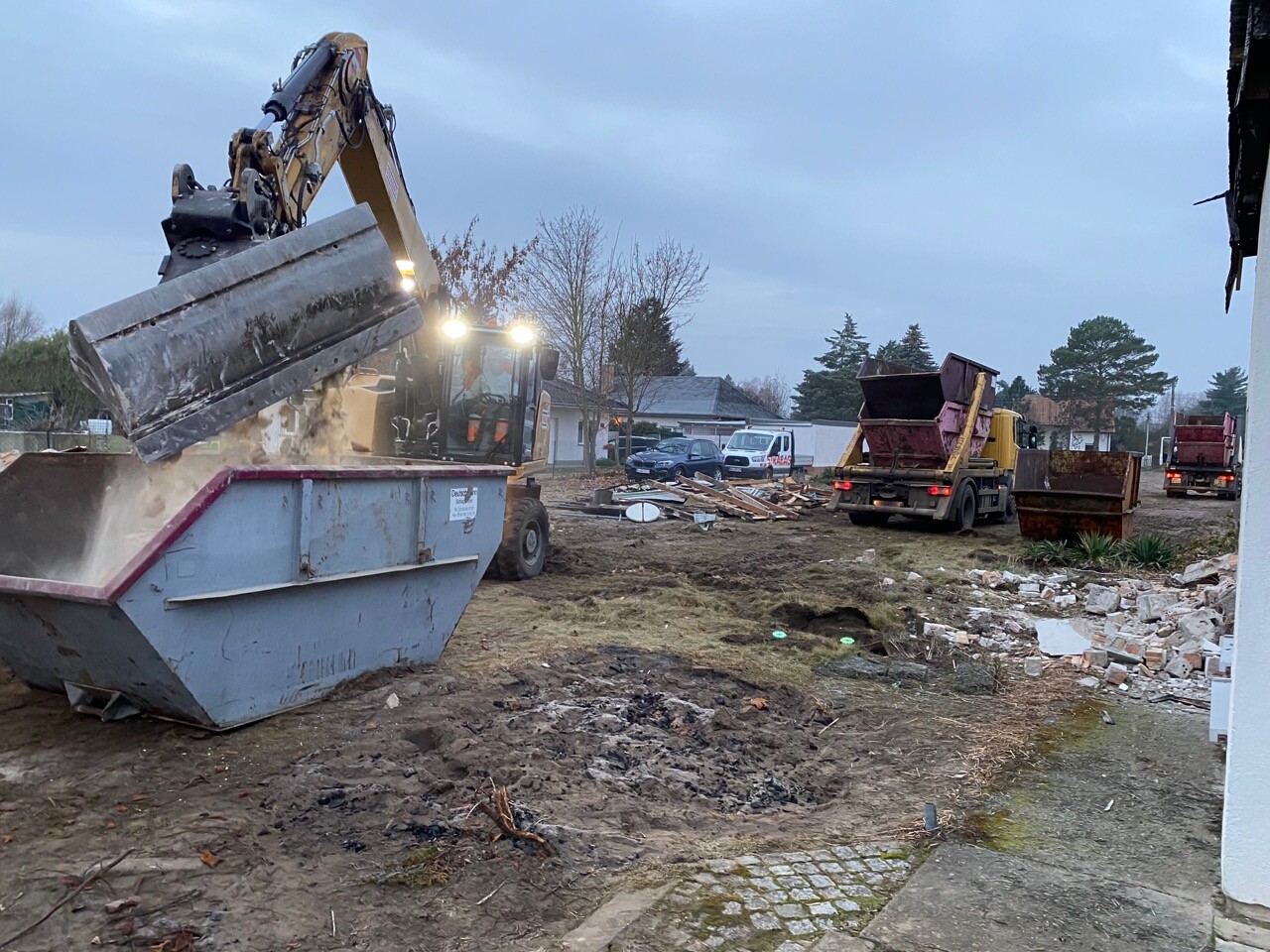

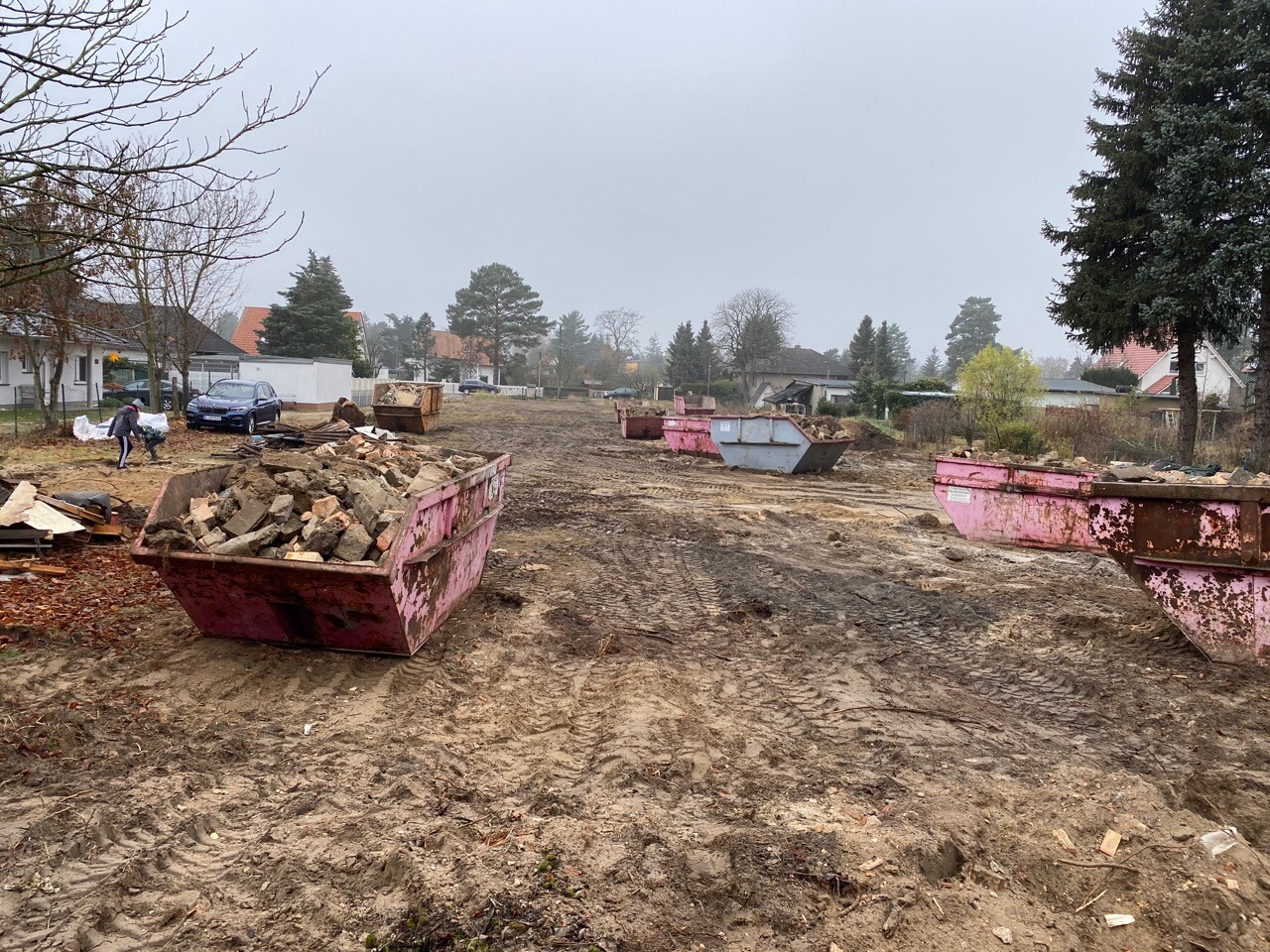

P.S. The building clearance on the plot has already been established, providing space for the occasional campfire.
