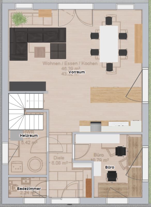

How much distance is there between the sofa and the TV in the living room? If you move it away from the wall as planned, I would estimate it won’t be more than 3 meters (10 feet). I think that’s way too little. It’s better to leave it at the back against the wall.
mambo1988
4 Oct 2019 16:30

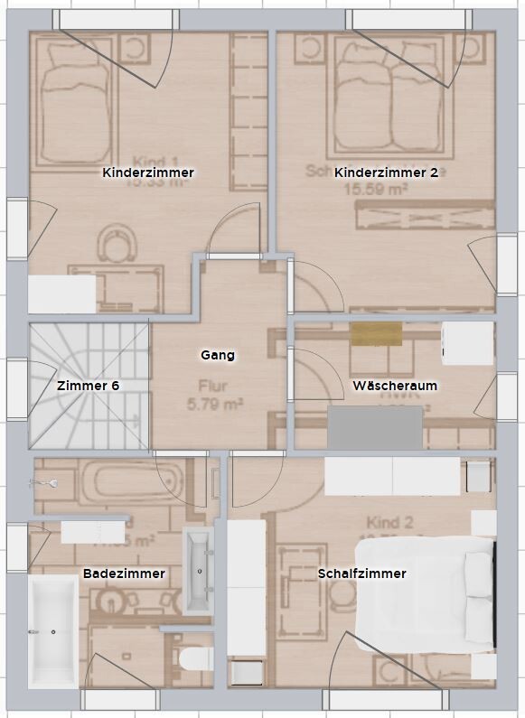

Thanks, kaho, for the new floor plan. After careful consideration, we realized that we would have to make too many compromises inside the house if we placed too much emphasis on the external design of the windows. Therefore, the exterior appearance of the windows is not a priority for us at the moment. We have now slightly optimized our latest floor plan and would like to present this in the next discussion with the architect.
@chrisw81: Yes, the distance from the head to the TV is exactly 3m (10 feet). This spacing is sufficient for us for now. If needed, we can still move the couch further back.
@boxandroof: Unfortunately, we can’t make the bathroom larger, so it probably works better to have the separate utility room on the upper floor.
Attached are the updated images again. Are there any further suggestions?
Thanks in advance!

kaho6744 Oct 2019 16:57
The bathroom is a disaster. It needs to be done differently.
mambo1988
4 Oct 2019 17:06
kaho674 schrieb:
The bathroom is a disaster. It needs to be different.
Could you tell us why?
