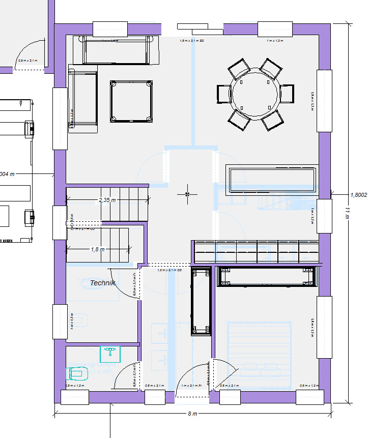

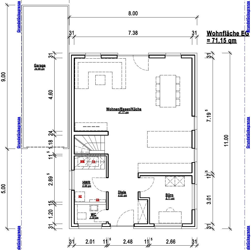

Is the size of the utility room sufficient? Air-water heat pump combined with water heater, washing machine, dryer stacked above washing machine, drying rack

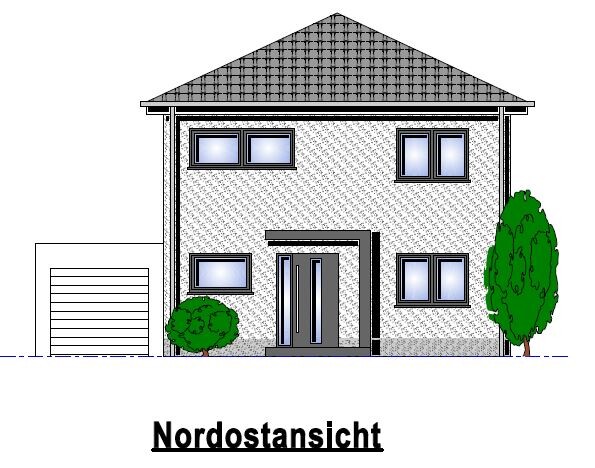

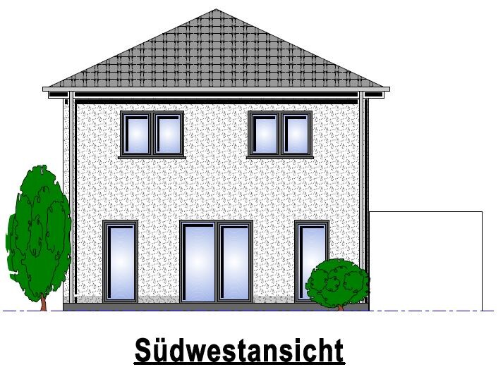

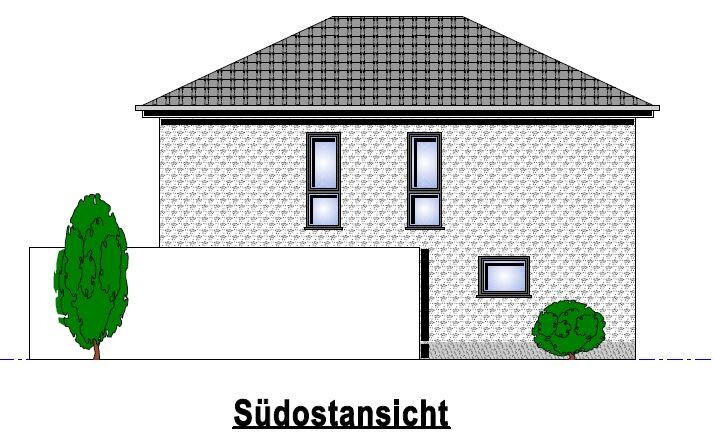

Explanation of the images:
One shows the floor plan with dimensions, the other shows the floor plan with furniture placement. Behind the sofa there should be some space so the children can leave things there occasionally (and to allow more room for surround speakers).
Then comes the house orientation and plot layout.

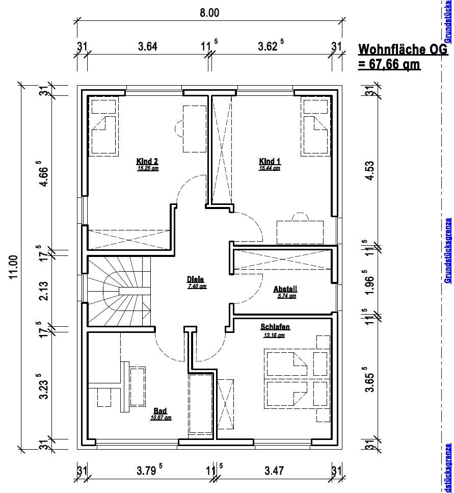

mambo1988 schrieb:
Could you tell us why? Sure: You walk in and immediately bump into the sink. There is no natural light coming from the side at the sink—only from behind or at an angle from behind. This means you can only see yourself in the mirror when artificial light is on. The path to the small window is blocked by a cabinet. The passage between the shower wall and the sink is an unattractive narrow gap that makes the space feel cramped. Also, in new builds (although not always successful), the goal is to have enough room on both sides of the sink for the standard cabinets of a bathroom vanity unit.
mambo19884 Oct 2019 17:35Ok, sounds reasonable. Do you have an alternative suggestion?
We would prefer the shower to be without a glass partition and to have some privacy screening for the toilet. Otherwise, we don’t have any other ideas.

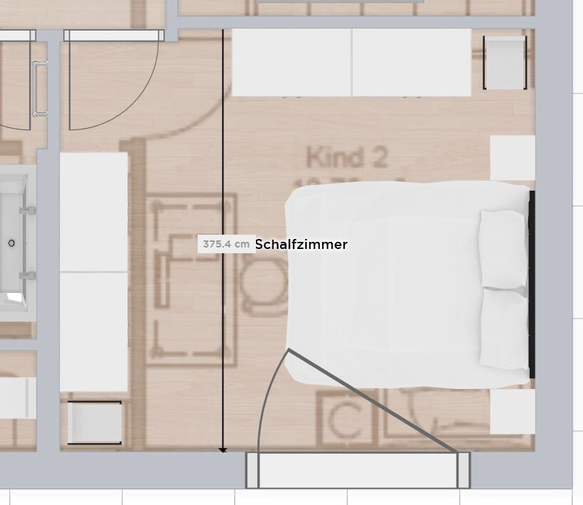

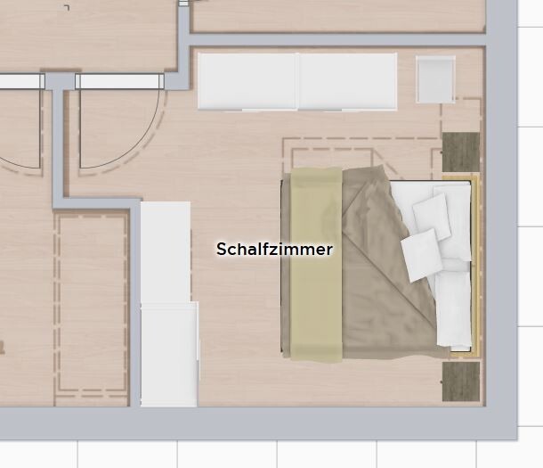

mambo1988 schrieb:
Would you have an alternative proposal?Maybe later. You can also ask something like this in a separate small thread, which often gets more responses. But don’t forget to mention what is non-negotiable—such as the door position, what you want, and what definitely should not be included.I don’t want to be a spoilsport, but with a width of 3.62 RBM up there between the exterior wall and the staircase (bathroom/bedroom), furnishing the new bedroom won’t work if you want to fit a wardrobe alongside the double bed and still have enough space to comfortably get out of bed. Even a small bathtub shown in the bathroom doesn’t help with the limited dimensions.
mambo19885 Oct 2019 17:44Thank you for the comment. The walls are planned to be 11.5cm (4.5 inches) thick. How much space is typically lost due to plastering and similar finishes?
We have adjusted the floor plan to have 3.75m (12.3 ft) clear room width. That should be sufficient for us.
The bed is 1.90m (6.2 ft) wide, and we estimated about 60cm (24 inches) of space on each side. That should work well, right?
