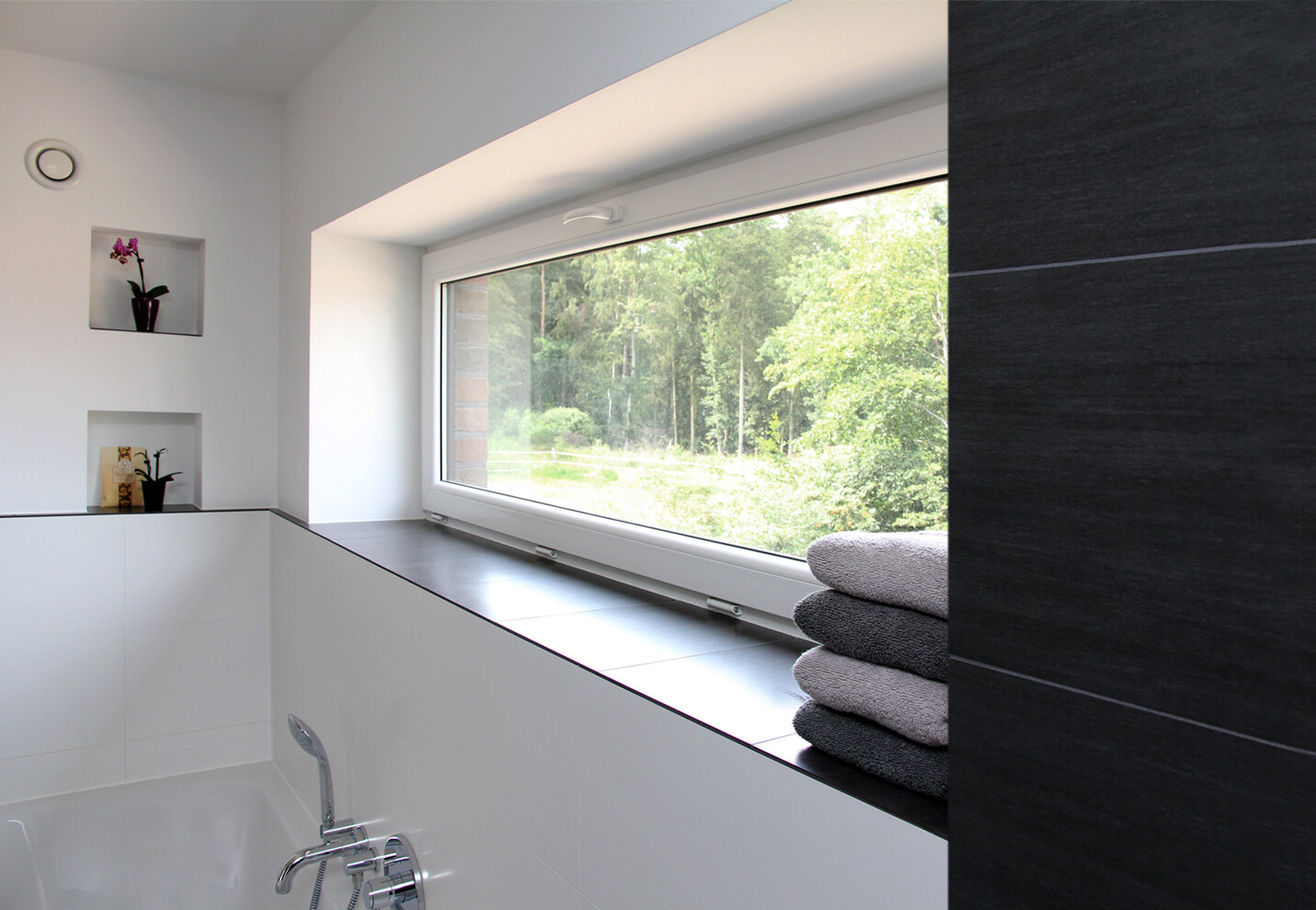

Parents’ bathroom … the toilet space looks very tight, and I also find the bathtub placed too close to the window rather impractical, since the window might be hard to open for bathroom ventilation. The bathtub is not yet positioned at the correct angle. The plan is to use a standard size bathtub, placed diagonally in the corner. This arrangement will create at least 20cm (8 inches) of space next to the toilet. This way, the window will also remain accessible.
Something roughly like this:

I still don’t see a solution for the bathtub window issue. Leaning over the tub is really annoying. I would rethink that, also because the toilet feels cramped in that area.

Seriously? You have a window but prefer to turn on the ventilation instead of letting in fresh air? Is this just laziness, or is there a deeper reason? How long is the restricted ventilation period? I mean, the bathroom here isn’t exactly small. It should take quite a while for the ventilation to remove the odor and bring in fresh air.
