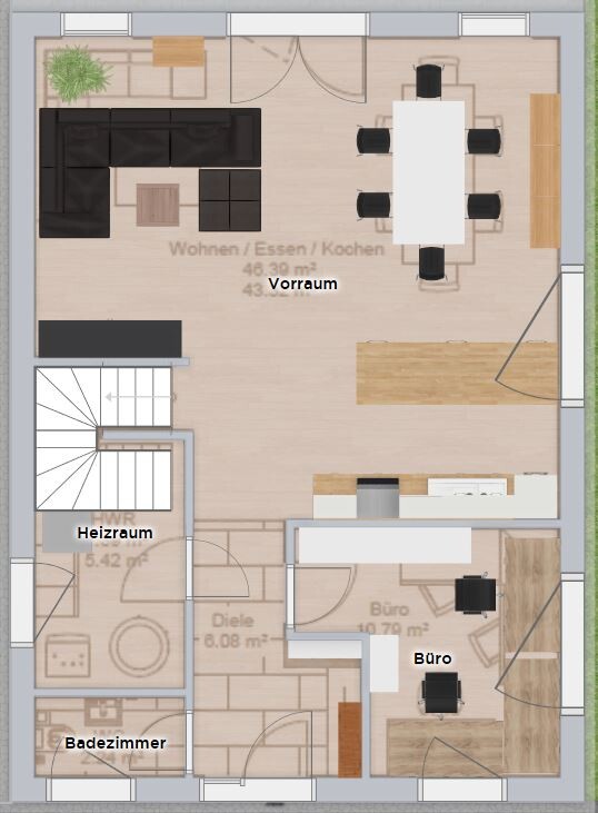

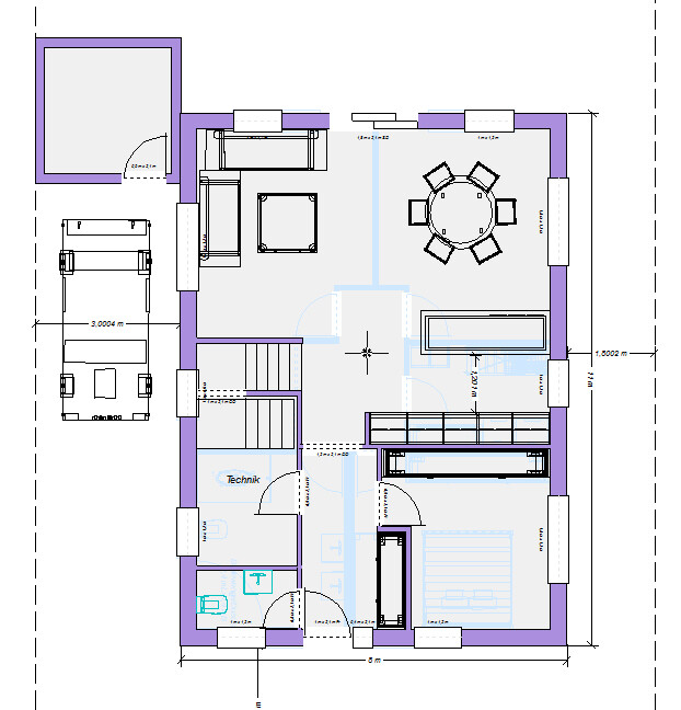

Explanation of the images:
One shows the floor plan with dimensions, the other shows the floor plan with furniture placement. Behind the sofa there should be some space so the children can leave things there occasionally (and to allow more room for surround speakers).
Then comes the house orientation and plot layout.

Is the size of the utility room sufficient? Air-water heat pump combined with water heater, washing machine, dryer stacked above washing machine, drying rack

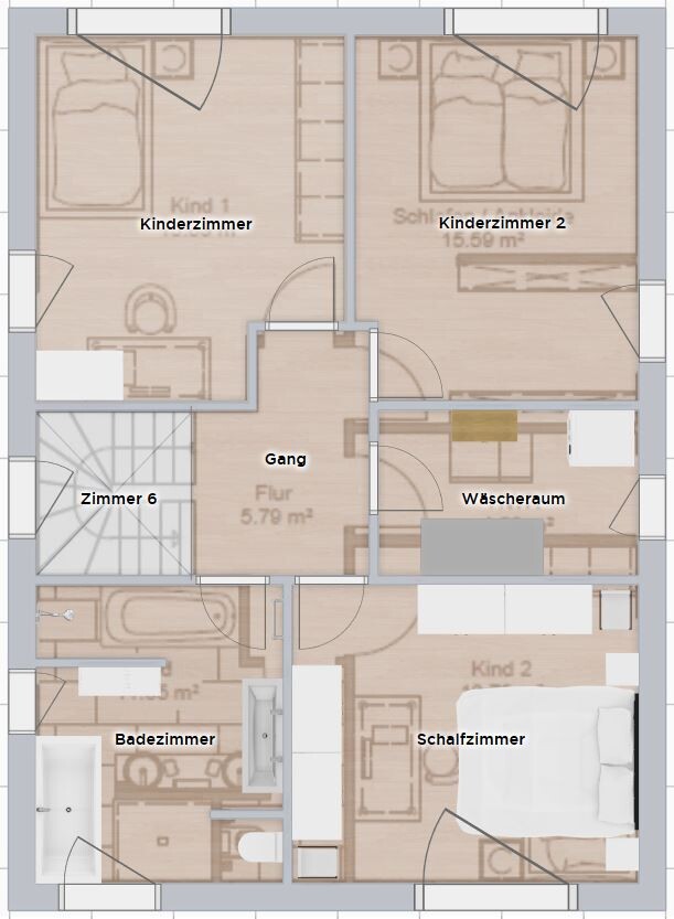

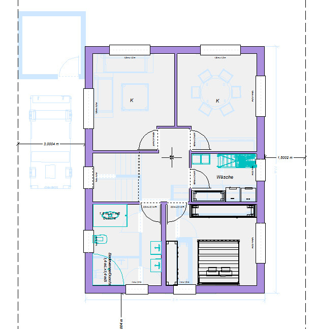

mambo19883 Oct 2019 20:47Good evening everyone,
Thanks again to all of you! Especially to kaho674—the floor plan actually made us reconsider things.
So, we can keep the utility room on the ground floor as is, if the laundry is moved upstairs. That seems to be the general consensus.
Attached is a slightly adjusted floor plan from kaho674. What do you think?
- Are there any further improvements possible? We're still unsure about the bathroom. (The wall next to the toilet should only be half-height.)
- We will need water upstairs in the utility room as well. So, a pipe shaft would be needed from below, right? How much space does such a shaft take up? Where could it be positioned? Or can the wastewater also drain through the floor towards the bathroom?
- The window height in the ground-floor utility room is very narrow. That should leave enough room for the technical installations, correct?

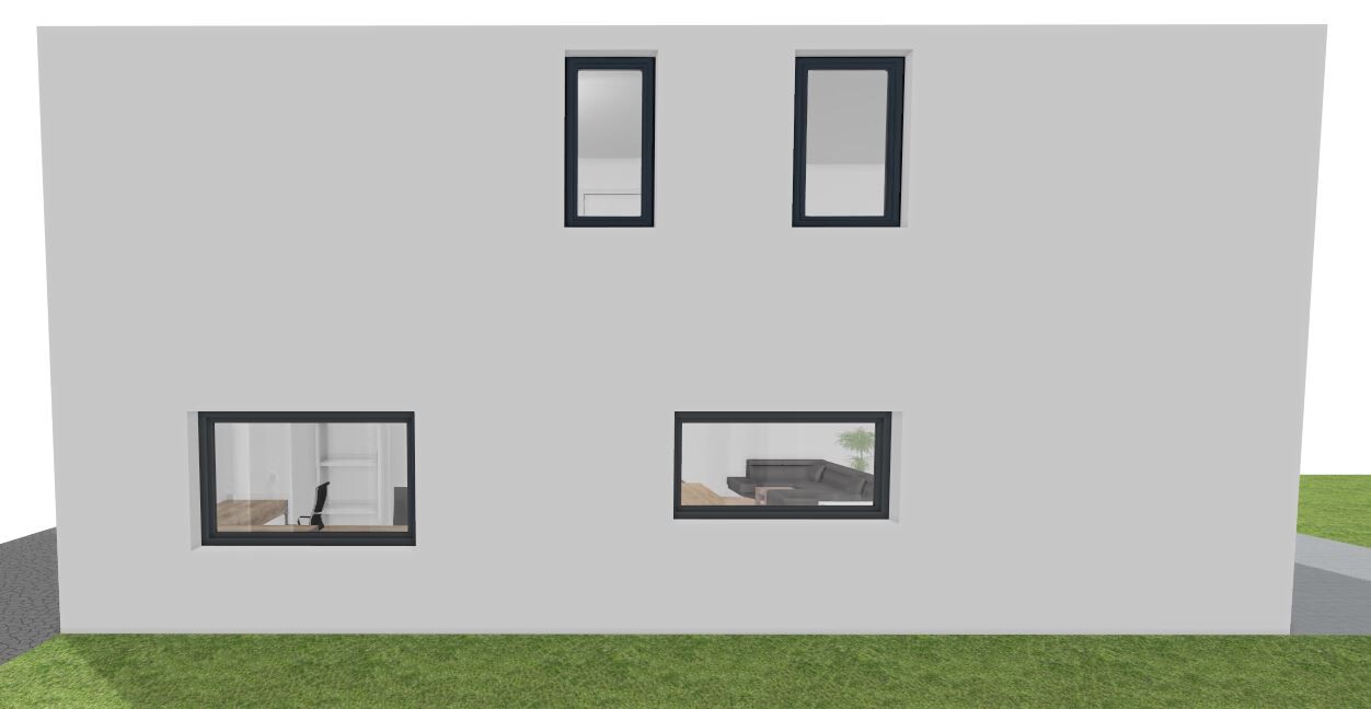

- The positioning of the windows on the right side is probably not ideal. The windows upstairs should be full height. (I can’t quite figure out how to draw that yet, oops.)
