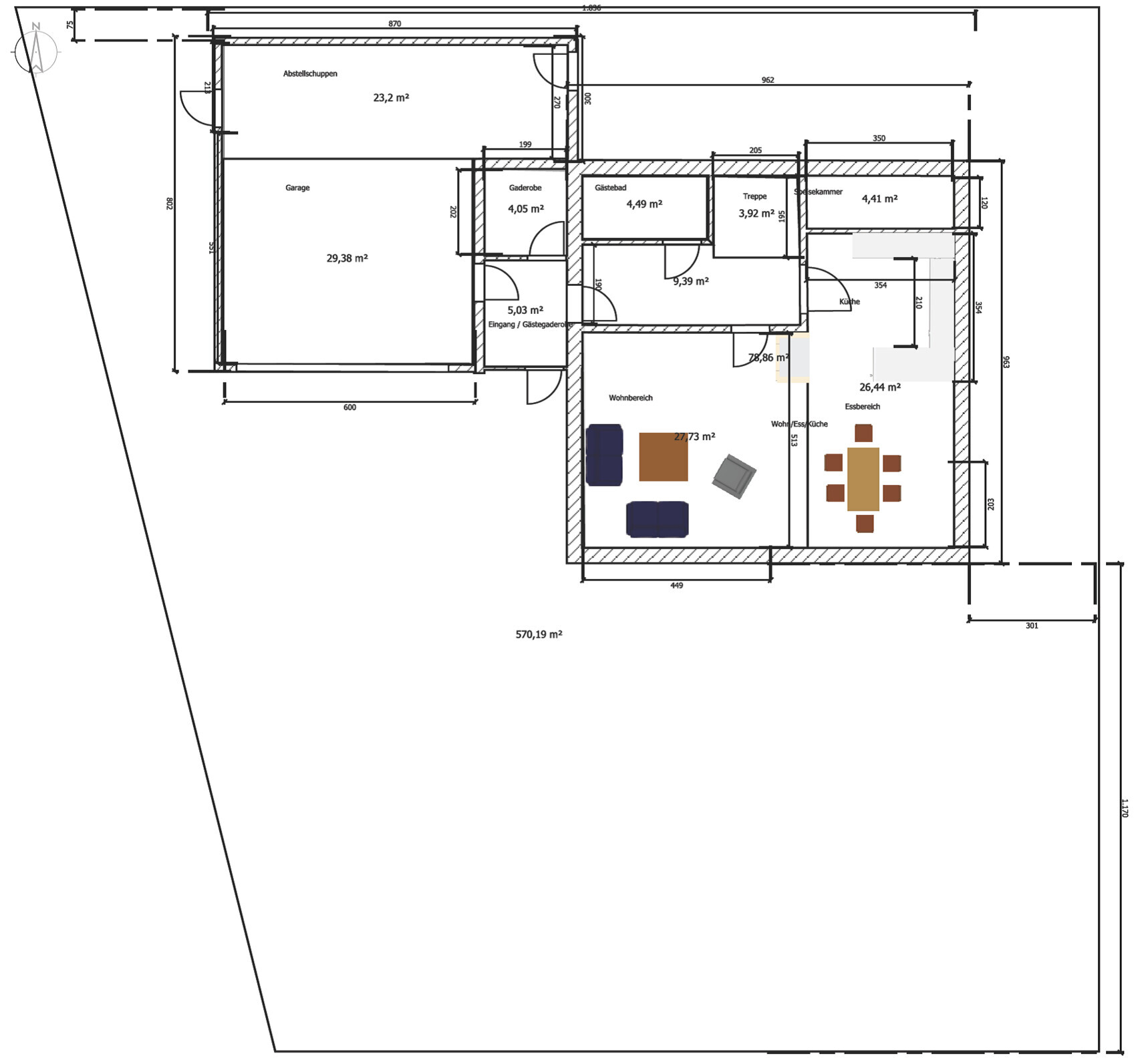

Wugler1978
14 Mar 2019 21:38
Criticism is welcome. That’s why I’m here. We have also created the ground floor with measurements.
I hope it’s clear (the outer frame represents the plot). The pantry is 1.2m (4 feet) deep.
Why does the bedroom have to be rectangular?
The open kitchen is 13 sq m (140 sq ft). Is that enough? We will still discuss this with the kitchen showroom before finalizing.

14 Mar 2019 21:47
I didn’t say that. But with 3.3m x 3.3m (10.8 ft x 10.8 ft), there’s only about 60cm (24 inches) left on each side. That’s almost too narrow to sit comfortably on the bed.
Wugler1978 schrieb:
The ground floor was also created with measurements.
But measurements are missing, and since every centimeter (inch) counts in a pantry with this shape, I won’t comment on it (or are you shrinking things?).

Wugler1978
14 Mar 2019 23:04
The bedroom dimension is an important point that we haven’t considered before. We have now redesigned the house. It is 30 cm (12 inches) wider, and the entire increase goes directly to the bedroom. This means the bedroom is now 3.8 m (12 feet 6 inches) wide. This also benefits the kitchen, which is now 30 cm (12 inches) wider as well.
In the living area, I still have over 4.8 m (15 feet 9 inches) between the south wall and the north wall.
The fireplace is planned to be positioned centrally to the right of the living room door.
The pantry will remain as is for now, but it might get an additional 10 cm (4 inches) later. If necessary, the freezer will be placed at the end wall, but that is a lower priority for now.

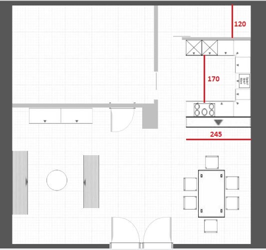

perth
15 Mar 2019 01:02
If you want to represent the ground floor realistically, it works better with the ALNO planner, a kitchen design software, specifically version V15b.
The kitchen should have a sliding door.
The layout is just roughly put together, without any filler panels. A distance of 210cm (83 inches) between the countertops would be too much; the kitchen is positioned too far into the living area, which doesn’t work.
Floor plan of kitchen and dining area: Dining table on the right, kitchen unit, round table on the left, entrance at the bottom.
The kitchen will then look just like most kitchens in square-shaped houses.
