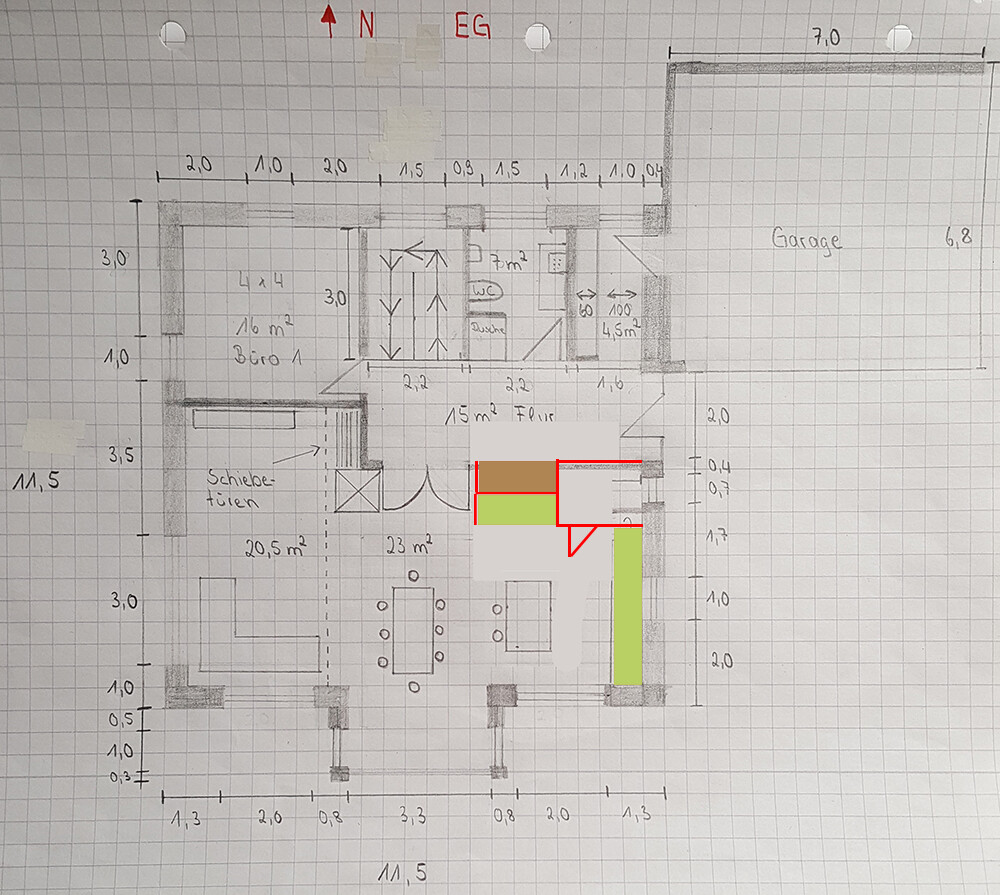

Pretty good overall. The elevations and windows are still a bit of a mess. The placement and size are sometimes oversized and inappropriate. The door and window in the dressing room should be centered. Pantry including window is poorly designed. Maybe something like this would work better:
The large X in the living room is probably meant to be a fireplace? Is it supposed to be in the kids’ room as well? Otherwise, the chimney could likely be placed more elegantly and much smaller there.
I think the cloakroom is fine. However, I would do without the door from the garage. The two steps to the front door aren’t worth it.
The sliding doors in the living room will probably be used so rarely that one should really reconsider whether they make sense.

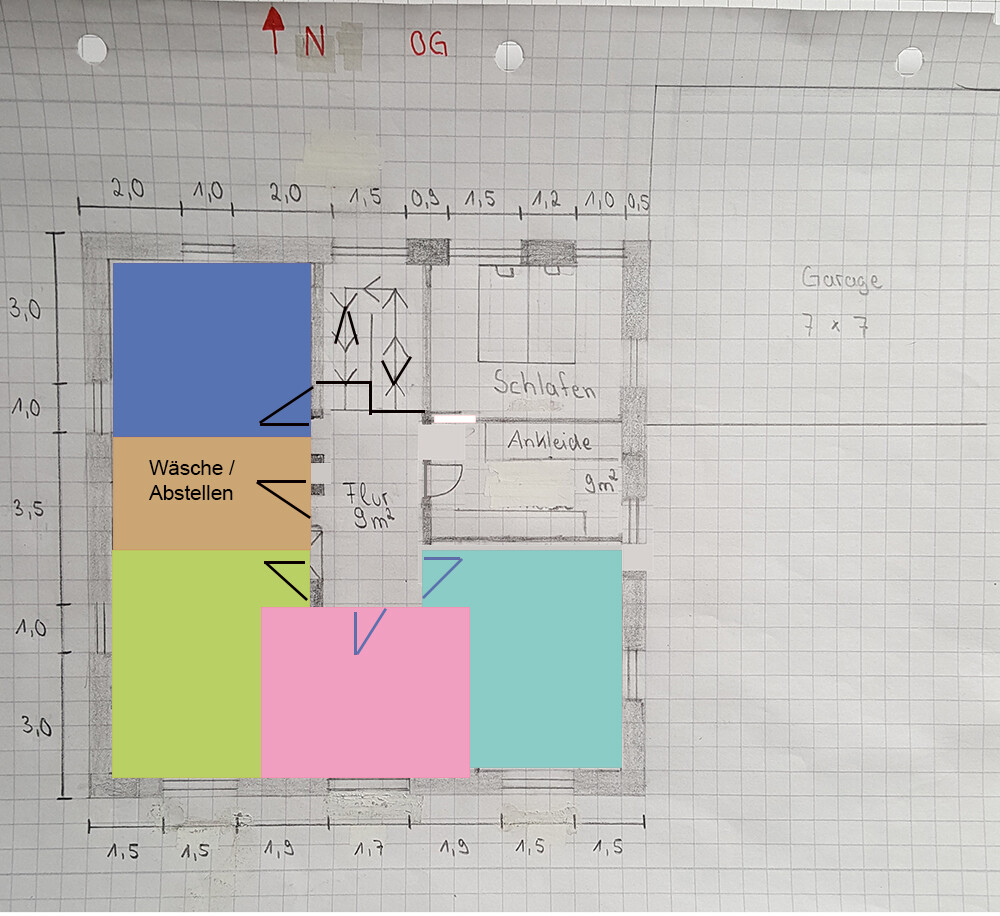

The layout on the upper floor is not optimal. The bedroom is too large – you could save space by entering through the dressing room and shifting the walls accordingly. The bathroom is more likely expected near child 1’s room, and all kids’ rooms should be facing south.
The house is not small. I have my doubts whether it can be done for 450,000 fully basemented. Maybe the financial aspect should be the primary focus first.
Attached is the revised upper floor plan, with dark blue indicating the bathroom. I quickly had to rotate the staircase. Ideally, I would mirror the layout horizontally so that the bathrooms align vertically, which would allow the staircase to remain as is. However, I’m not sure about the preferences regarding the bedroom. The door to the walk-in closet would need to open the other way.
Franzi183 schrieb:
On the ground floor, there is a coat closet niche with a door leading to the double garage.I will never understand the purpose of having this small door directly connecting the steering wheel to the sofa, or rather, what kind of robbery, murder, assault, lion attack, lightning strike, or heavy downpour one would fear on the two-meter (6.5 feet) path outside between the garage door and the interior door.Franzi183 schrieb:
We would very much like to be able to separate the planned dining area from the living area with a sliding door if needed. The question is whether this is even feasible.Counter question: why is this necessary? I prefer looking from the sofa at the dining table with bowls of fruit and nuts than at a multipurpose community hall–style space-reducing sliding door.Franzi183 schrieb:
The fireplace is planned to be placed between the dining and living areas, although we are not yet 100% satisfied with the current location in the plan.Simple solution: remove it. Fireplaces nowadays are rarely used in homes built to energy efficiency standards anyway.Franzi183 schrieb:
The walk-in closet is accessible from the hallway because we didn’t want a door to the bedroom. The reason is the possible disturbance if the other partner is still sleeping.But that’s also possible if only the closet has direct access from the hallway and the bedroom doesn’t have its own door to the hallway. By the way, I wouldn’t recommend placing the windows from the ground floor as mirrors opposite the bedroom.Franzi183 schrieb:
Furthermore, there are two roughly equal-sized children’s rooms upstairs as well as a home office.The home office, however, is the sticking point in the floor plan.Franzi183 schrieb:
We would like a kitchen garden with raised beds,I’m twice your age and I can still easily kneel down and get back up.Franzi183 schrieb:
modified prefab house floor plan with our own room layout and arrangementLeft wings are unwanted here, but you can still reveal the model.https://www.instagram.com/11antgmxde/
