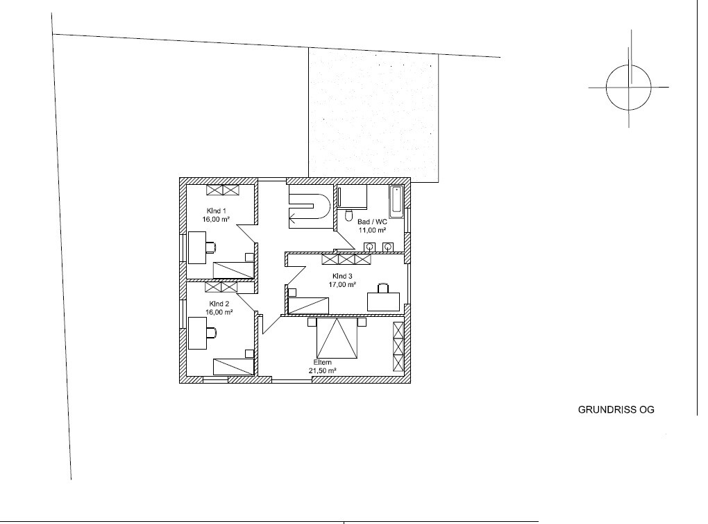

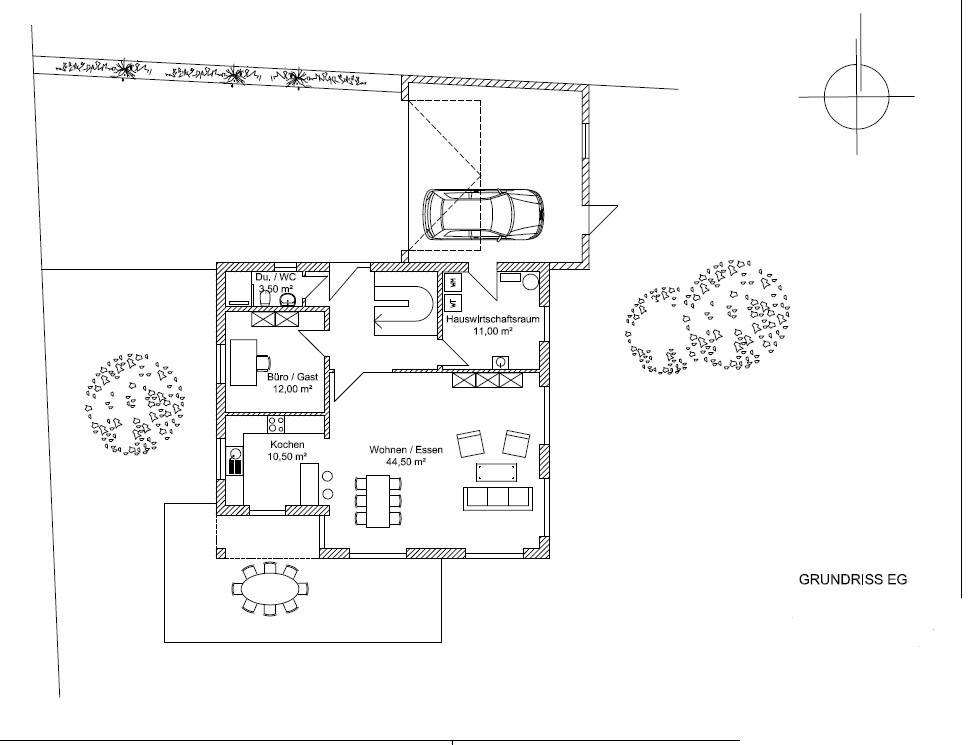

Update:
- new architect
Scale 1:100 ... should be about 180 m² (1,938 sq ft).
The door in the utility room will be removed.
Roof shape is still undecided.
A fourth child is not ruled out, so the guest room on the ground floor was made slightly larger and could possibly be converted into a children's room later.
One idea is to align the kitchen flush, without the canopy, and to separate it from the living room with a separate door (since cooking videos will be filmed).
What do you think about the design? What else could be changed?
Thanks in advance!
