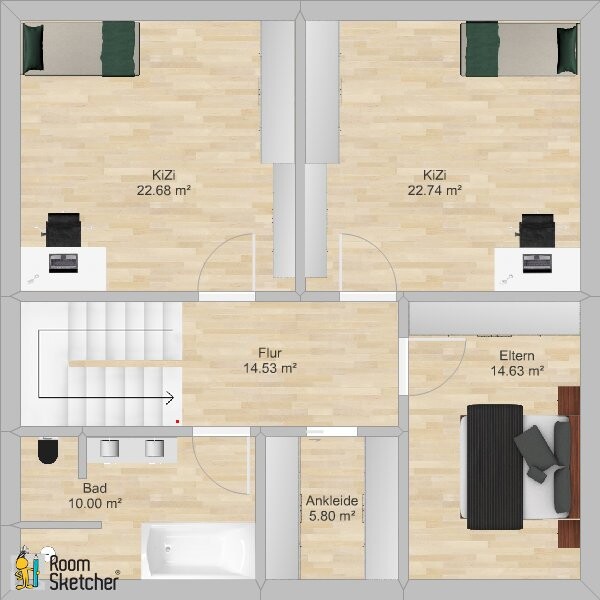

j.bautsch24 Jul 2018 08:10So, not being able to create a functional room layout with those exterior dimensions and just a few rooms is quite an achievement, in my opinion.
I kept the exterior dimensions but used a different staircase, and suddenly there are no more awkward, twisted rooms. This way, you can save a significant amount of floor space. I left out the windows.
When I plan for myself, I fit two more rooms on each floor within the same area (and we’re planning without a basement): technical room and office downstairs, laundry room and a second bathroom upstairs. With such a large kitchen, a pantry is probably unnecessary since the tall cabinets should hold enough supplies.
In my case, north is at the bottom (sorry for the rotation).
