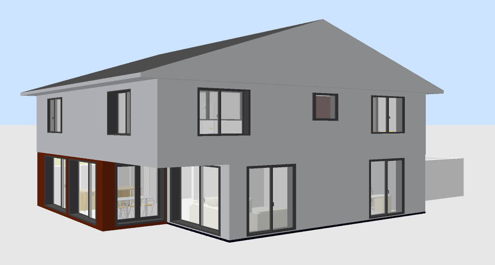

Hello kaho674, thank you for your ideas and for taking the time to create the drawings.
Do you think the house looks that bad? Of course, the windows still need to be adjusted.

I think it's such a shame that the 12.49 x 12.49 meters (41 x 41 feet) design now somehow has to be forced into a gable roof.
I’m all for a really grand villa. My hope is that the "original design"—meaning the house originally planned with the foundation slab—will be more balanced in terms of the architectural relationship between the floor plan and the building structure.

MBS2201 schrieb:
and that a gable roof is mandatory we also know. In my opinion, that is a good argument for a house that suits a gable roof.
MBS2201 schrieb:
Why don’t we just set aside the original design. I’m not as fixated on that as you are on the slab foundation. But I consider the original design at least equally worthy as designs L to Z to be considered as an option.
MBS2201 schrieb:
I see the exterior as rather secondary. I agree on it being secondary. But it doesn’t have to perfectly fit like a glove either.
Original draft at least equal in status to the other drafts It has been requested.
However, I would prefer not to wait and do nothing while possibly receiving a draft that doesn’t fit—either inside or outside.
As I have already mentioned, the construction company wants a clear answer soon. I don’t want to lose another week waiting for the drawing only to find that it is just as unsatisfactory as the one from my architect.
