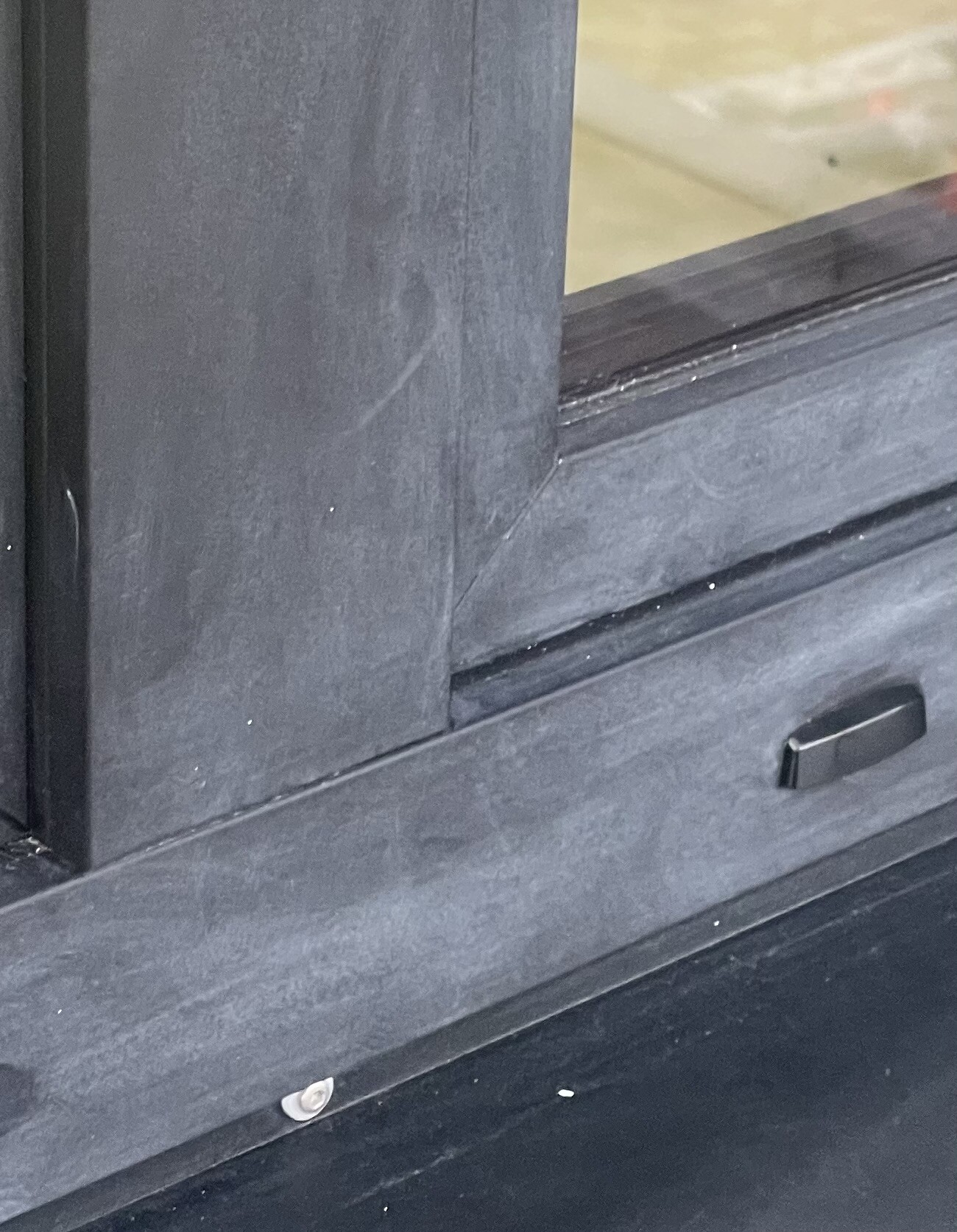

Hello everyone, we have the same problem. It almost seems like it only appears where the exterior plasterer cleaned afterward. I have already tried quite a few things; do you have any new solutions? I’m really desperate!
Thank you very much!

Let’s be honest. These aren’t stains; the surface looks completely ruined and like it has been on the south side for 30 years.
11ant22 Feb 2024 23:05
Honestly. Those are not just stains; the surface looks totally ruined and like it’s been on the south side for 30 years.
Yes, there are also spots that look like paint splashes. I suspect the surface is a stonewashed leopard print foil meant to "imitate" a roughly sawn silver-gray stained wood pattern (?)
