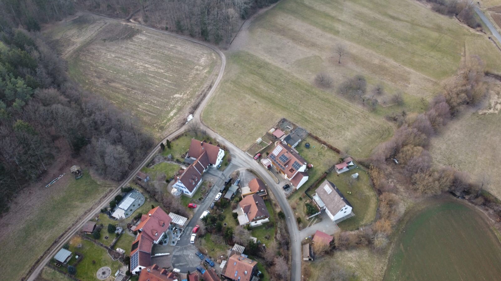

What kind of location is this? A village? A main road?
J
J.H.S.H.
27 Feb 2021 10:31
The plot is located on the outskirts of a small village with 350 residents.
The road ends at the plot; beyond that, there is a forest track leading into the woods. The road on the right ends in a small residential area with a turning circle.
Aerial view of a small locality: houses, roads, fields, and forest at the edge.
