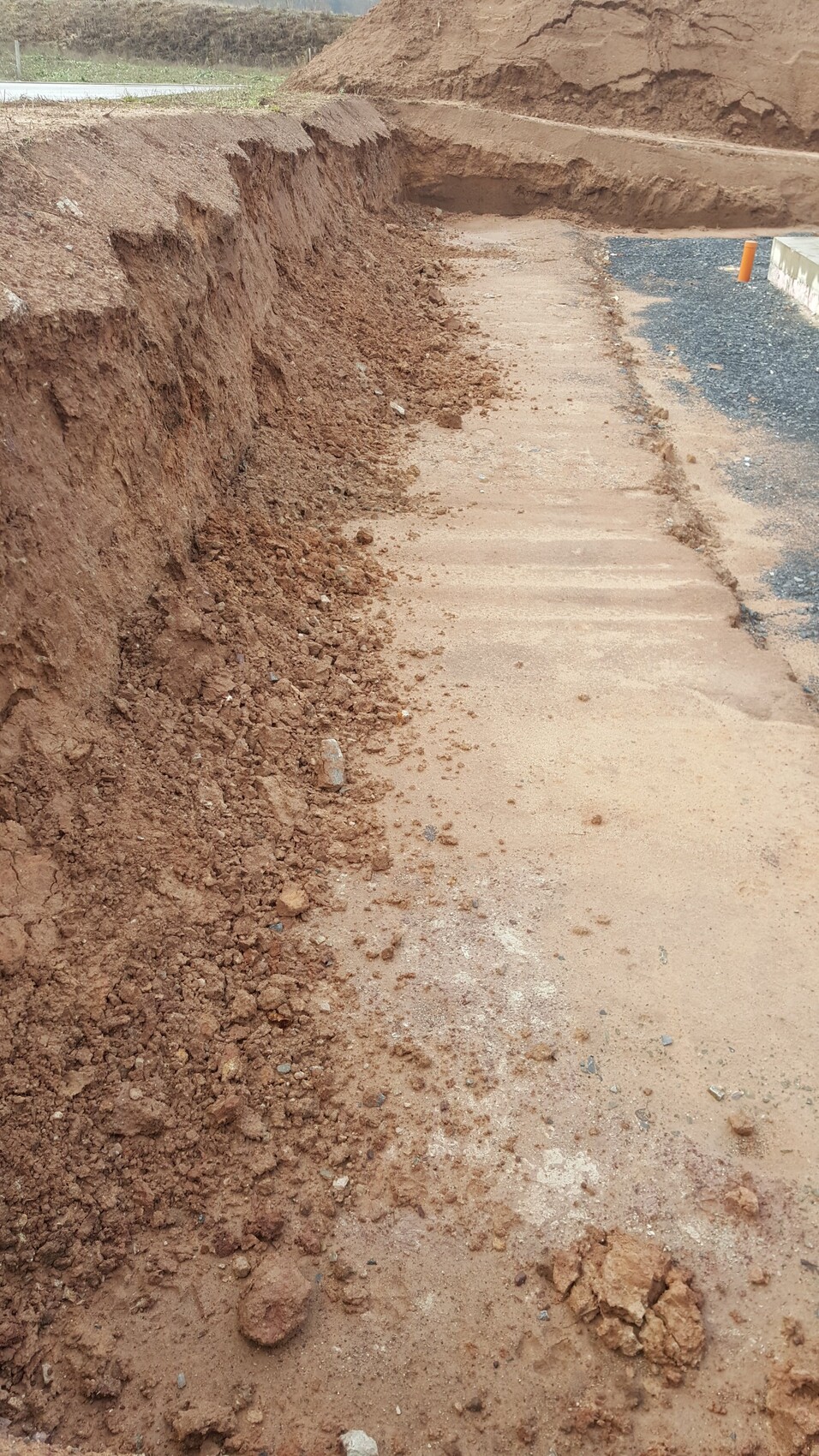

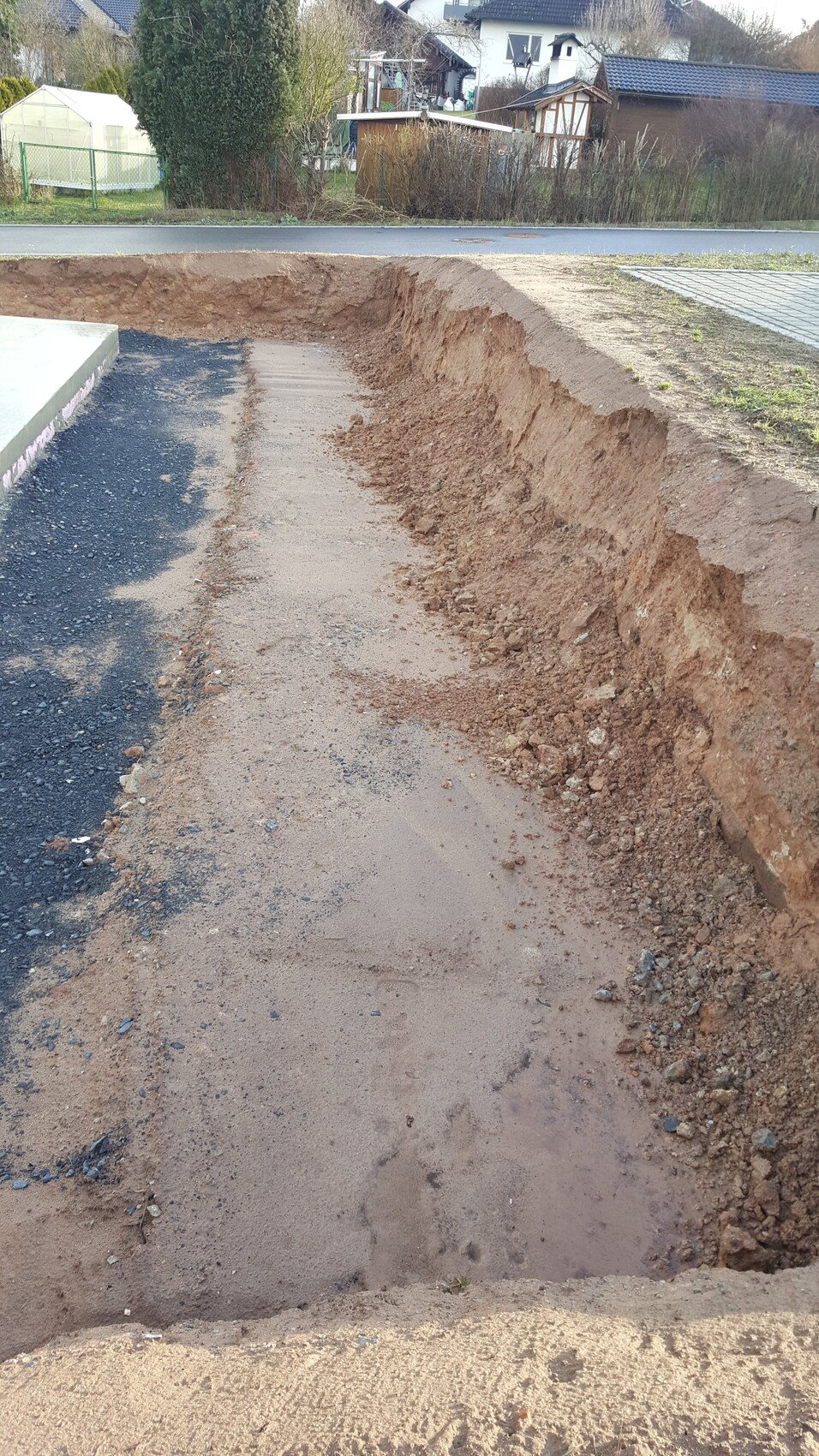

Hello dear forum,
I am new here and have a question for you! We are currently building a house and the foundation slab is already in place.
Our land has a slight slope, so there is an earth wall on one side of the property. Of course, there will be a retaining wall built there later. But now I am worried because some soil is breaking away. Is this normal? The wall is about 1.4 meters (4.6 feet) high and 15 meters (49 feet) wide.
Is it possible to build such a wall yourself, or is it better to hire a professional? It is not a retaining wall.

By the way, your civil engineer should not have carried that out at all. Here, the building authority is very strict about ensuring that embankments with a height difference over 1m (3 feet) are constructed with a slope ratio of 1:1 (45°) and covered with plastic sheeting. This is precisely to prevent such erosion.

This slope is not secured against falls; I don’t see any safety fencing anywhere. As the property owner, you are responsible for ensuring that nothing can go wrong.

What do you mean by "let’s keep things realistic"? A 1.4m (4.6 ft) height difference without a slope is dangerous. It was just a warning, not that I’m rushing off to the accident insurance board.
