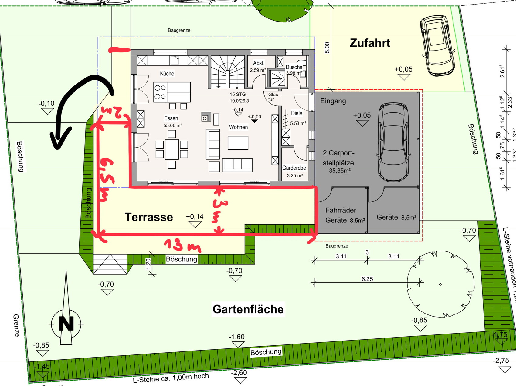

I need your input because our eastern neighbor has disrupted our landscaping plans. We had planned to stabilize the area with two rows of 1 meter (3 feet) L-shaped retaining walls. Now, our neighbor intends to build three full stories facing the garden, meaning they will want direct access from the basement to the garden.
This makes our original plan obsolete since we intended to add fill while they plan to excavate. This would leave us with 2.5 meter (8 feet) tall L-shaped retaining walls on the side, which none of us want.
So now the question is, do you have any idea what it would cost to construct the terrace on a supporting framework, possibly including the tool shed? See the screenshot. We would need to expose the basement wall facing the garden, but then we wouldn’t need to install the L-shaped retaining walls, which would cost around €26,000.
Would wood or steel be advisable?

Something like this would be what I have in mind That’s how I understood it as well, and I meant that the most practical approach would probably be to plan and design it together with the carport (using the same materials).

Knallkörper4 Jun 2018 11:19For a steel structure made of galvanized HEA beams, I would estimate around 7,500 euros. I assumed 45 meters (150 feet) of HEA 100 beams for this. The material cost alone is about 2,500 euros; the rest covers structural engineering, assembly, delivery, and corrosion protection. Then, add the shed or carport and the foundation work.
I would not build something like this from wood, as the maintenance effort would be too high for me.
Knallkörper schrieb:
For a steel structure made from galvanized HEA beams, I would estimate around 7,500 euros. I assumed 45 meters (148 feet) of HEA100 beams. Pure material costs are about 2,500 euros, the rest goes towards structural engineering, installation, delivery, and corrosion protection. Then you still have to add the shed or carport and the foundation work.
I wouldn’t build something like this from wood, as the maintenance effort would be too high for me. Thank you for your assessment. I also believe we will no longer consider the wood option.
I just spoke with my architect. At least we agree that a kind of terrace structure is currently the most sensible solution and that we will not be installing more or taller L-shaped concrete blocks (also known as lintels or retaining blocks). However, he thinks that the carport and storage room should not be included in the terrace structure, as that would simply become too expensive. In my opinion, this construction would be the most cost-effective (like above, but without stairs). The carport will then have to be partly supported by 2.5-meter (8 feet 2 inches) L-shaped concrete blocks. The required length still needs to be determined. See the screenshot. About 3 meters (10 feet) should be enough for a garden table (widthwise) with chairs.
I have an appointment with the metalworker on June 12 and will inquire about the costs of this idea.
