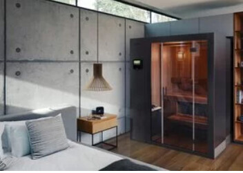

No picture available at the moment, but I can take one once the unit is fully installed in December ;-) Wow, 30,000€ (about $33,000) is quite an amount. That should be enough. If money isn’t an issue, I’d visit the local Klafs dealer to see the S1 and get some advice. Bring your floor plan with you; they’ll then provide a customized offer. They come in different sizes and materials. Depending on the configuration, you’re likely to end up somewhere between 18,000 and 25,000€ (about $20,000–$28,000). Klafs is pricey, but the retractable solution is just really cool. Thanks for the info. Klafs is definitely one of the manufacturers we are considering.
