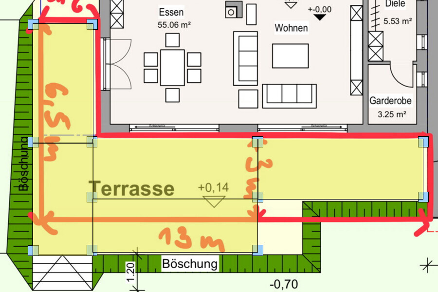

I will outline an alternative concept for the supports and spans as I envision them:
Floor plan shows terrace next to living and dining area with garden space
Z
Zaba12
4 Jun 2018 13:56
I’ll sketch out how I imagine the supports and spans:
Are the blue blocks supposed to represent the steel columns? If so, the L-shaped blocks at the carport could potentially be "repurposed" as supports or beams, right?
The idea also has some merit and would almost match the "old terrace size."
11ant4 Jun 2018 14:41
Yes.
Zaba12 schrieb:
Then the L-shaped concrete blocks at the carport could be "misused" as supports or beams, right?
Exactly.
