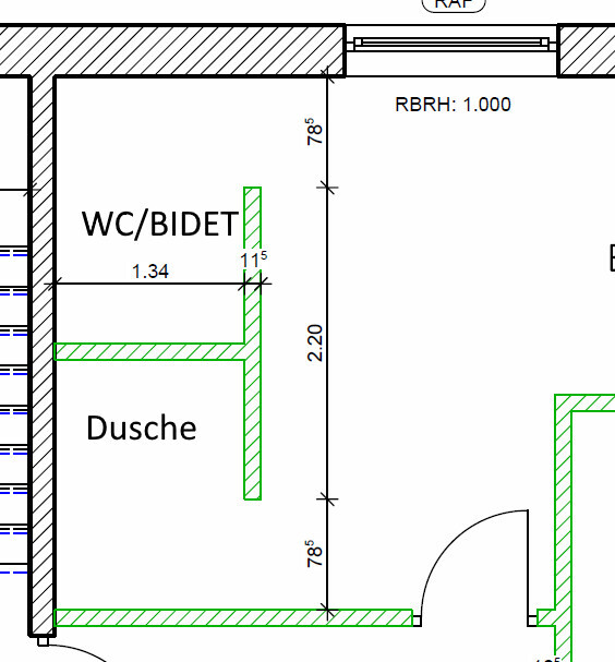

a quick question about our bathroom. We are installing a T-junction (please no debate on whether it’s good or bad, we like it ), and we’re thinking about the best way to divide the measurements. On the upper part of the plan there will be a toilet and a bidet, so the shower will go in the lower part. We will increase the width to 1.40m (55 inches).
The question now is how to best allocate the length. We are considering 1.28m (50 inches) for the shower and 0.8m (31.5 inches) for the toilet/bidet. Does that work?

If you change the T-joint to an L-joint and move the toilet to the upper left corner against the wall, you would have a significantly longer shower and the sink wall would be shortened by 20–30cm (8–12 inches).
As you have planned it now, you still need to account for the wall-mounted installations in the shower and toilet area, which means the wall you have drawn will definitely become thicker.

Where exactly are the 0.8?
I don’t see your measurements in the drawing.

I still don't understand how the bidet/toilet layout is supposed to look. Placing them side by side might be quite tight, right?

We have now decided on the layout attached. The 65cm (25.5 inches) toilet/bidet is not ideal—I'd prefer 80+cm (31.5+ inches)—but I think it’s manageable.

The plan is not fully dimensioned ..
but the shower and toilet niche could probably be about 150 cm (59 inches) wide instead of 134 cm (53 inches) – right?
