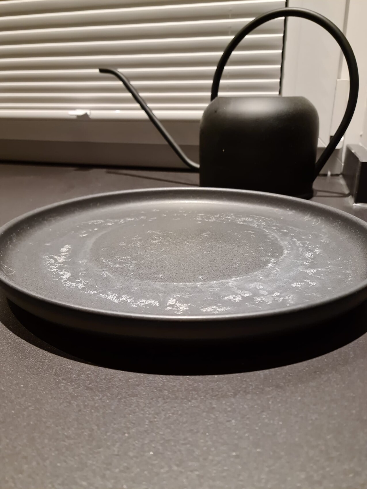

I hope this is the right section of the forum for my question. We have an extension and have installed a water softener from Grünbeck from the start, as the water in our area is quite hard (16° dH). Previously, we lived a few kilometers away with a similar hardness level but without a softener, and we regularly dealt with limescale stains.
To prevent exactly that in our new home, we had the softener installed. It is set to 5° dH, which I check regularly. Everything seems fine so far. However, we are experiencing significantly more deposits here than in our previous apartment. We could clean our glass shower screen every day, the glasses come out spotted from the dishwasher (which is correctly set), and we have to descale the kettle weekly using citric acid. Attached is a photo of a plate. We poured about 0.5 liters (0.1 gallons) of tap water onto it and let it evaporate over three days. We also noticed that these deposits are easier to clean off than typical limescale.
Is this normal, or what kind of deposits could these be? Possibly any health risks? We are wondering how it is possible to have much stronger deposits despite having a water softener. Thanks in advance!

To prevent exactly that in the new house, we had a water softener installed. It is set to 5° dh,Such a low level is not necessary. Even at 7-9° dh, there are no significant limescale deposits. However, since only hardness is reduced, other substances can still cause stains.As this issue is well known (also by Grünbeck), here is an explanation from Grünbeck themselves:
"Water softening using the cation exchange process replaces the hardness minerals calcium and magnesium in the water with sodium. This changes the salt composition of the water. The total salt content remains unchanged. However, the total water hardness and thus the amount of limescale decreases.
After water use, water droplets always remain on fittings and surfaces, which then dry and leave all dissolved salts as solid residues (water spots). With hard water (high calcium and magnesium content), these deposits form relatively quickly and mainly consist of poorly soluble calcium carbonate (limescale). Even with low hardness after a water softener, deposits can still occur, but they develop more slowly. In addition, with soft water (low calcium and magnesium content), deposits mainly consist of easily soluble sodium carbonate. This can be removed much more easily by mechanical means compared to calcium carbonate."
My advice to you is not to soften the water too much. Try a hardness level of 8° as a test. You should get fewer stains that way.
