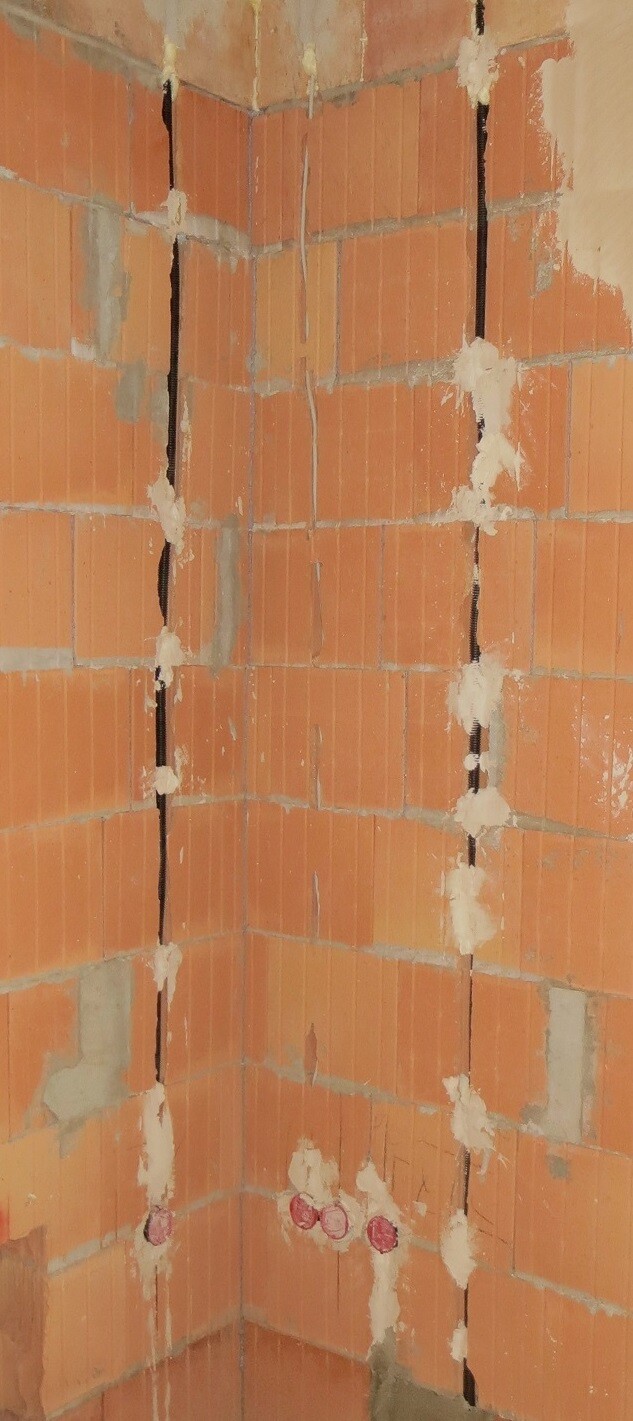

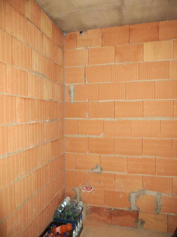

Why not completely avoid dust generation.
Unfinished room with brick walls, corner, pipes; crate on the floor.

AOLNCM16 Dec 2016 11:49
zod schrieb:
No conduit, no deal.
Areas that are no longer accessible afterward (e.g., suspended ceilings) should of course be equipped with conduits.
The same applies to cables with shorter expected lifespans, such as intercom wiring (in case a replacement needs more than 4 wires), antenna cables (due to bends or higher signal loss), network cables (for example, if CAT6 or CAT7 is later replaced by fiber optic), and speaker cables.
Also, connection cables between important distribution points, such as electrical cabinets on each floor or from the main distribution board to the garage panel (for example, if three-phase power is upgraded from 16A to 32A later), should be installed in conduits as well.
A regular power cable inside a room is unlikely to be removed again quickly; repairs typically take place locally. During major renovations, everything is usually taken out anyway, and the room layout as well as the positions of switches and sockets are changed.
When routing conduits to the outside (for outdoor sockets, antennas, intercoms), keep the blower door test in mind.
