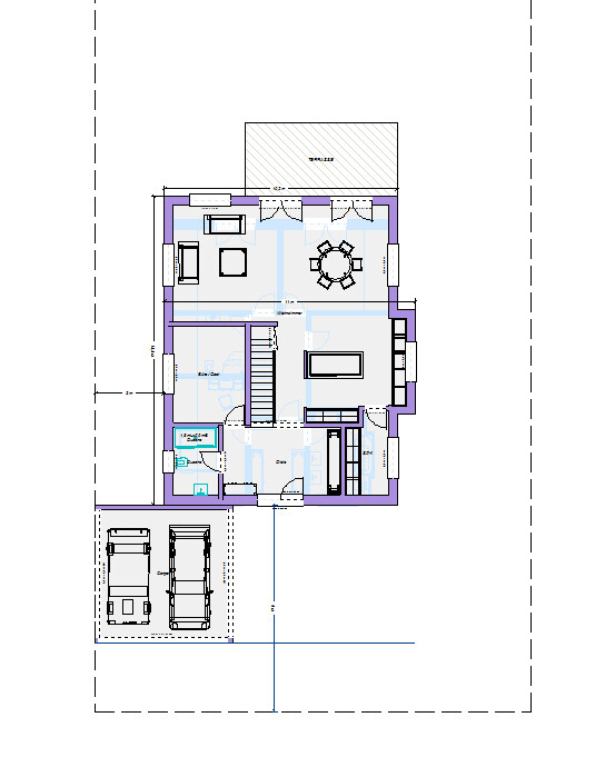

Site plan of a residential plot layout with parcels, streets, and north arrow.

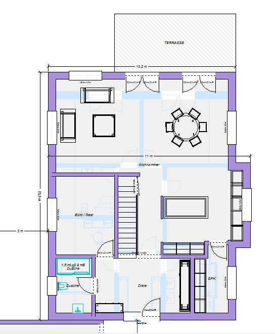

Ground floor plan of a house with living/dining area, kitchen, hallway, coatroom, and bathroom.

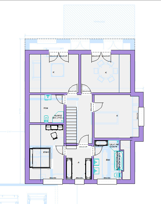

Attic floor plan with 3 rooms (Child I/II, bedroom), bathroom, shower, loggia, staircase.
kaho67413 Dec 2019 09:01
As mentioned, the floor plan isn’t bad, but the house opens onto the neighbor’s fence instead of the garden. I think that’s a mistake, especially since there’s another 50m (165 feet) behind where the kids play. Instead of watching them, you’re stuck peering at the fence on the edge. Of course, it’s a matter of priorities.
Here is a suggestion on how to open the house toward the garden and also park properly:
Floor plan of a house: living room, dining area, kitchen, bathroom, bedroom, stairs and garage.
Floor plan of a house: living room with dining table, kitchen, bathroom, hallway, terrace.
Floor plan of a house with central staircase, rooms, kitchen, bathroom; exterior walls in purple.

I like the floor plan. I wouldn’t include two sinks in the children’s bathroom. Kids usually only use the bathroom together when they are toddlers; my two never used it at the same time, so the second sink just wastes space. I would rather plan for a cabinet there.
Personally, I would prefer to design the kitchen fully open without partition walls. It feels much more spacious, and with three children, I doubt the double doors will ever be closed.

Thank you very much for the design! I generally like it a lot. I find it a bit impractical that visitors always have to go through the kitchen to get to the dining room and living room. One reason for having a closed kitchen is so that pots or dishes can be left out without worrying about guests seeing them. That wouldn’t be possible here.
Also, just to clarify since it came up: we definitely want a closed kitchen. We currently have an open kitchen, and every time something is fried, the whole living room smells like a fast food place for hours.
