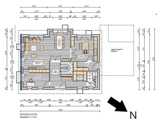

Dear Housebuilding Forum Community,
I have been following the forum for some time now and we’ve already gathered a lot of ideas and inspiration here. As our house planning has become more concrete, I thought now is the perfect time to ask for your expert advice. We would really appreciate your (honest) feedback. Please be kind to us nonetheless

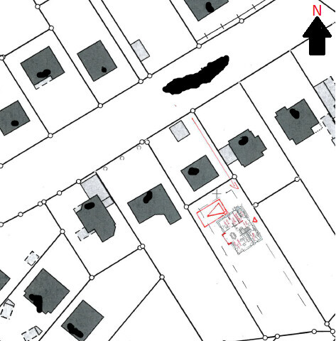

Plot size: 1100m² (11840 sq ft)
Slope: no
Floor area ratio: n/a
Floor space index: 0.3
Building envelope, building line and boundary: 11 x 14m (36 x 46 ft)
Edge development: no, except garage/carport etc.

Style, roof shape, building type: Preferred city villa, but from our and the architect’s perspective, this is not feasible with our space requirements on the building plot within one full floor. Second choice is a gable roof (knee wall 125 cm (49 inches), 40° pitch) with a captain’s gable, as currently planned

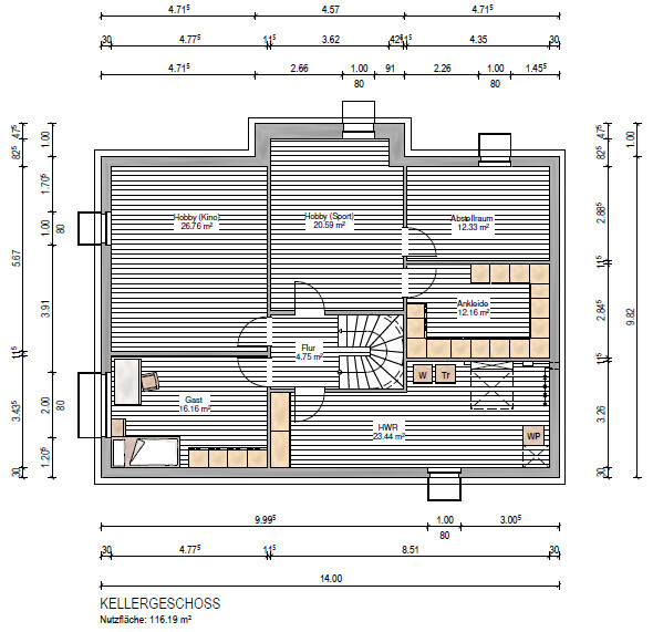

Basement, floors: basement, ground floor, attic

Ground floor: living room, kitchen (with pantry), guest toilet, cloakroom, office

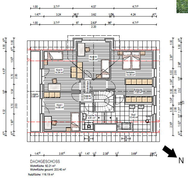

Upper floor: 3 children’s rooms, master bedroom, bathroom, children’s bathroom. Walk-in closet for parents would be nice but is not a must

Balcony, roof terrace: not desired but required by development plan
Garage, carport: carport

What do you dislike? Why? We find it unfortunate that the children’s rooms are relatively small compared to the parents’ area. We haven’t really come up with a better solution to enlarge them meaningfully

- could you not give up: basement, 3 children’s rooms
Standard design from the planner adapted to our wishes and needs
Basically, the floor plan is very practical from our point of view and covers our requirements. Whether the few weaknesses we see (possibly pantry too narrow, cloakroom too small, children’s rooms too small) can be solved given the building plot and its conditions, we somewhat doubt. But maybe you have ideas?
Is the floor plan practical in your opinion? Do you see any weaknesses we may have missed, anything missing, and how could these be solved? Is there a way to enlarge the three children’s rooms without creating awkward rooms upstairs?
The furniture shown in the floor plan is from the construction company; we would arrange some pieces differently and move some doors. Our main concern is to have the floor plan and overall concept critically reviewed here by the forum
kaho674 schrieb:
That probably won’t work, as it would otherwise compromise the single-story design.Wow, does it really have to be that expansive? But okay... if that’s what you like... then you’ll be giving up the garage there.
Hamburger202015 Mar 2020 20:07kaho674 schrieb:
That will probably not be possible, as it would compromise the single-story design.Correct.
It also has nothing to do with being able to do it, but rather whether we really want to. You have to save somewhere at some point...
Hamburger202015 Mar 2020 20:09ypg schrieb:
Wow, does it really have to be that large?
But alright... if you like it that way... then you’ll just skip the garage there. It doesn’t have to be curved, of course, but the size of the rooftop terrace is fixed. We think the curved shape looks quite stylish. However, the idea didn’t come from us but from the architect.
Hamburger202015 Mar 2020 20:23ypg schrieb:
The bedroom on the upper floor is too narrow at 3 meters (10 feet). I would reconsider that. Currently, the bedroom is 3.19 meters (10.5 feet) wide.
What do you think would be a good width? If it were 3.40 meters (11 feet 2 inches), there would be about 70 cm (28 inches) of space on each side. Or should it be even more?
