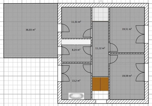

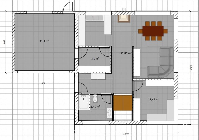

As I mentioned, I wasn’t very happy with the first draft, and after searching extensively for a program that allows you to easily design a floor plan, I gave it a try myself. It’s causing me bigger problems than I expected. But this is where I am currently:
We somehow moved away from the straight staircase. We can’t manage to design a floor plan where a straight staircase fits well. Especially not without having an unattractive view into the basement...
Forget the small open space — the idea might seem nice, but in reality it mainly means drafts, cooking smells spreading throughout the house, and noise traveling from room to room. Such a gallery is only effective once it reaches a certain size—otherwise, it’s just a black hole.
If you don’t want to have a view down the basement stairs, then just put a door there—that’s been the standard solution for centuries and it works well. It’s better to separate the hallway end with doors and have additional storage space (cleaning supplies, bedding, suitcases).
I would also prefer to have the washing machine, dryer, and ironing board on the sleeping floor—this way, you don’t have to carry laundry all over the house, and during the early childhood years you can iron upstairs while the children play, do homework, or sleep. For that purpose, I would place the machines at the end of the hallway next to the bathroom and create a play/work corridor between the children’s rooms. The children’s rooms would then be reduced to a standard size.
Later, a computer area for the children can be set up there as well—this helps prevent children from sitting alone and unsupervised in front of their computers.
