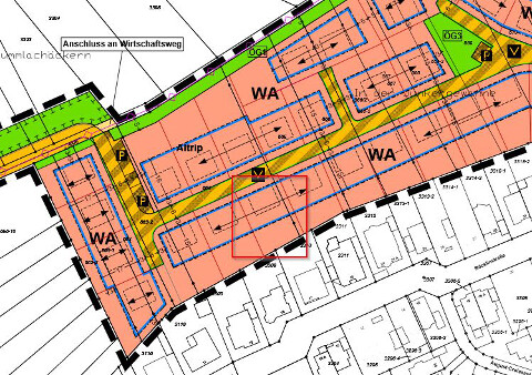

Plot details:
Key zoning plan specifications:
Our basic wishes:
About us:

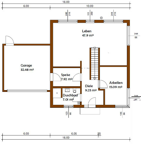

We visited the prefab house center in Mannheim several times. Based on online research and recommendations from acquaintances who have built with this company, we had an appointment with Fertighaus Weiss GmbH. The consultant took a lot of time for an initial meeting (5 hours) and planned a first draft house with us. It’s basically a first idea based on what we have expressed as our wishes. As a first draft to see what is roughly possible on the plot, I think it’s okay. But it’s not yet something that convinces us. Here are just the ground floor and upper floor:

Plot details:
- 540 m² (approximately 5800 sq ft)
- 19 m (62 ft) wide
- Garden facing south
- Flat terrain
- Currently undeveloped
- New residential area (30 plots) in Rhein-Pfalz district
- High groundwater expected (requires waterproof basement construction, “white” or “black” tank)
- Floor area ratio (FAR) 0.3
- Total floor area ratio 0.6
- 2 full stories permitted
- Maximum wall height 4.5 m (15 ft)
- Maximum ridge height 9.5 m (31 ft)
- Gable or hip roof with pitch between 30° and 45°
- Dormers may cover up to half of each building side’s width; each individual dormer may cover up to one third of the building width, maximum 4 m (13 ft)
- Garage must be at least 5 m (16 ft) behind the street building line
- Garage allowed on only one side of the building
Comments:
- The width of 10 m (33 ft) results from 19 m (62 ft) plot width minus 6 m (20 ft) double garage (boundary building) and 3 m (10 ft) clearance to neighbor
- Negative ground floor aspects:
- No entrance vestibule
- Passage from hallway to living area too narrow
- Lower right area of living space (right next to staircase / above “office”) is too narrow (we have a large sofa)
- Ground floor
- Arrange shower bathroom and pantry vertically
- Access to pantry from kitchen side upstairs
- Position office horizontally instead of vertically
- This allows moving the staircase to the left wall of the pantry, creating more space for passage and living area
- Upper floor
- Moving the stairs causes a problem upstairs that I have not yet solved
- I generally like the upper floor layout, but because the stairs access is on the left side, I cannot reach the walk-in closet anymore
- I do not want the walk-in closet to be a pass-through room (!)

Hmm... where was north again? I’ll just say north arrow.
Guest bathroom... 151 cm (60 inches) for shower and toilet. How wide should the shower be?
I would still skip the storage room on the ground floor and instead create a 65 cm (26 inches) deep niche for cabinets accessible from the hallway.
Whatever is intended as the master bedroom, I’d like to see it furnished. If it’s room 3, the window needs to be moved further down on the plan, because no wardrobe fits at the top of the plan. Where is the bed supposed to go?

Sorry, north is this way:
The planner made a mistake with the measurements. The 150 cm (59 inches) is not correct. It should actually be 90 cm (35 inches) for the shower and 90 cm (35 inches) for the toilet.
I am still discussing the storage room with my manager. I haven’t convinced her to remove it yet. I think the niche for cabinets would be more practical.
Rooms 2 and 3 are children's rooms. Room 1 is the bedroom.
As mentioned, a few walls will be shifted slightly. Also, some window positions will be adjusted to ensure everything fits properly with the bed, cabinets, and so on.
