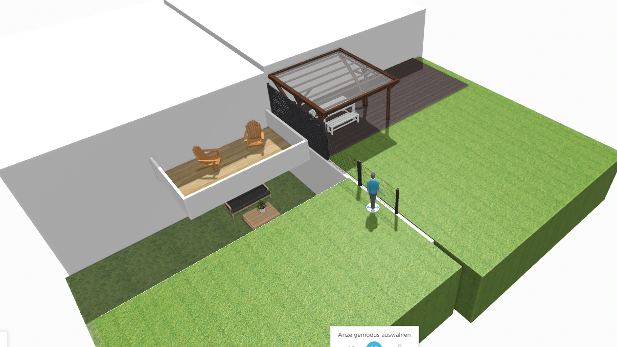

hanghaus20232 Apr 2026 11:07Thanks @ypg. That’s exactly how it is. The privacy screen like this can’t be approved. Regardless of the costs, a 3m (10 ft) high privacy screen? I would plan a stepped retaining wall made of gabions instead. That way, you end up with a 3m (10 ft) setback. It’s all a matter of budget.
Could you please move the privacy screen forward to match the neighbor’s privacy screen and extend the screening as well? That way, you’ll get a better idea of the desired outcome.

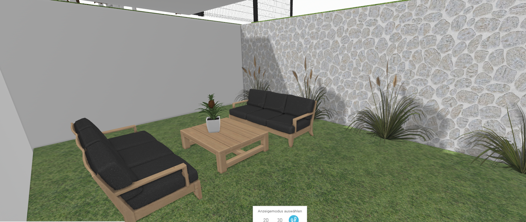

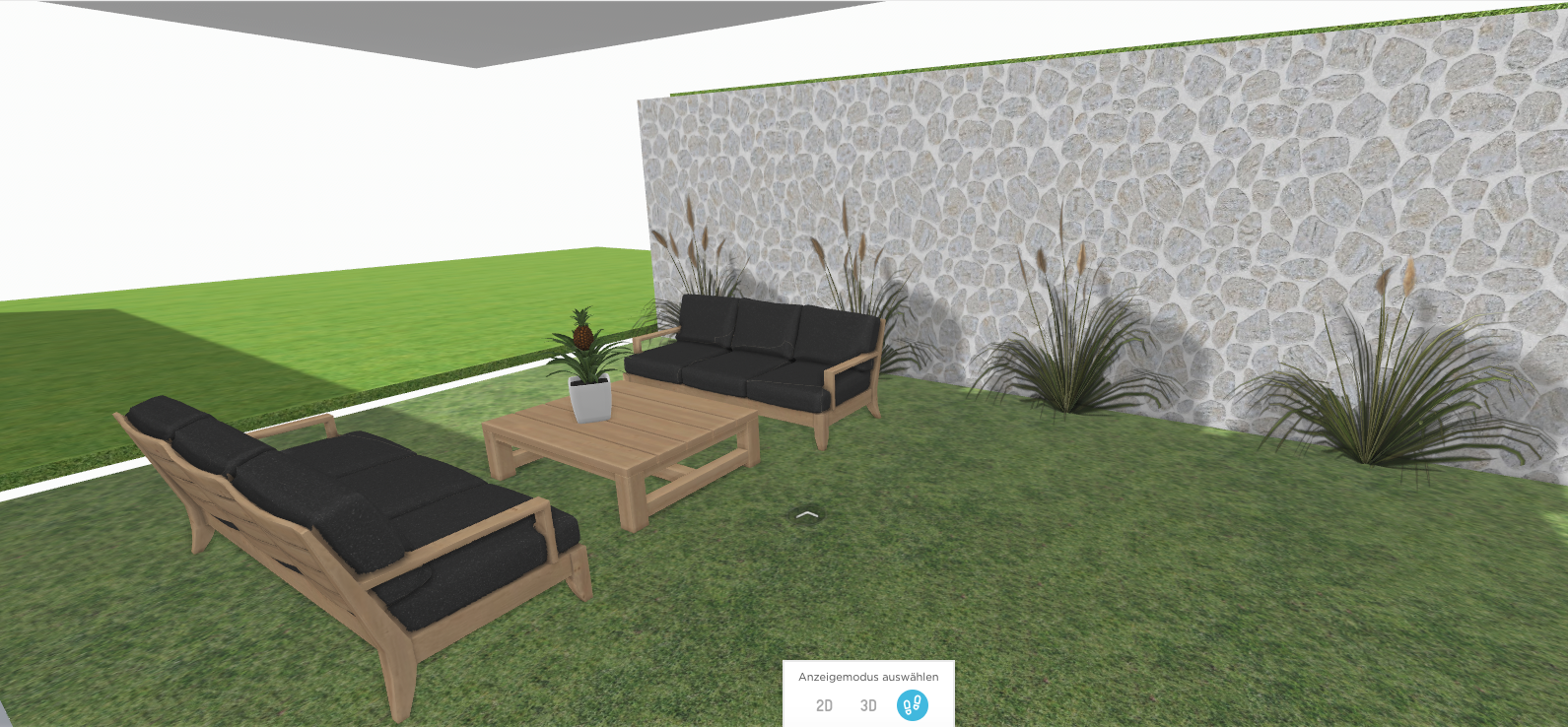

Could you please move the party wall forward up to the neighbor’s party wall and the privacy screen as well? That way, the desired layout becomes clearer.I am able to do that, but I have taken over the planning so that the gap is visible. Unfortunately, it is shown in green here because I am using a simple tool.
The terrace roof and the privacy screen fit within the 4 meters (13 feet).
Current and planned situation (ignoring the slope on the neighbor’s side)
And CURRENT and TARGET (slope next door not taken into account) 1) So the TARGET image already shows the current situation (without our house etc.), the neighbor has already built a retaining wall on their side exactly like this (about 20 years ago).
Their terrace (I might have incorrectly described it as a balcony) also covers the entire "gully" up to the shown grass, meaning they have already created this situation themselves.
They know our plans and we are absolutely agreed that a privacy screen will be installed between our terraces. Therefore, we do not expect any legal building issues.
If it were as in your depiction, that would be quite unfortunate.
And their house definitely has a pitched roof.
Regarding costs:
The quote for the exterior works (€115,000, I mistakenly mentioned only €100,000 at the start) includes the retaining walls to the neighbor and our house, underpinning of the neighbor’s retaining wall, L-shaped concrete blocks / support for our terrace after 10m (about 33 feet) upwards towards the slope, terracing of the southern outdoor areas, and groundwork.
I take it you consider this completely unrealistic?
