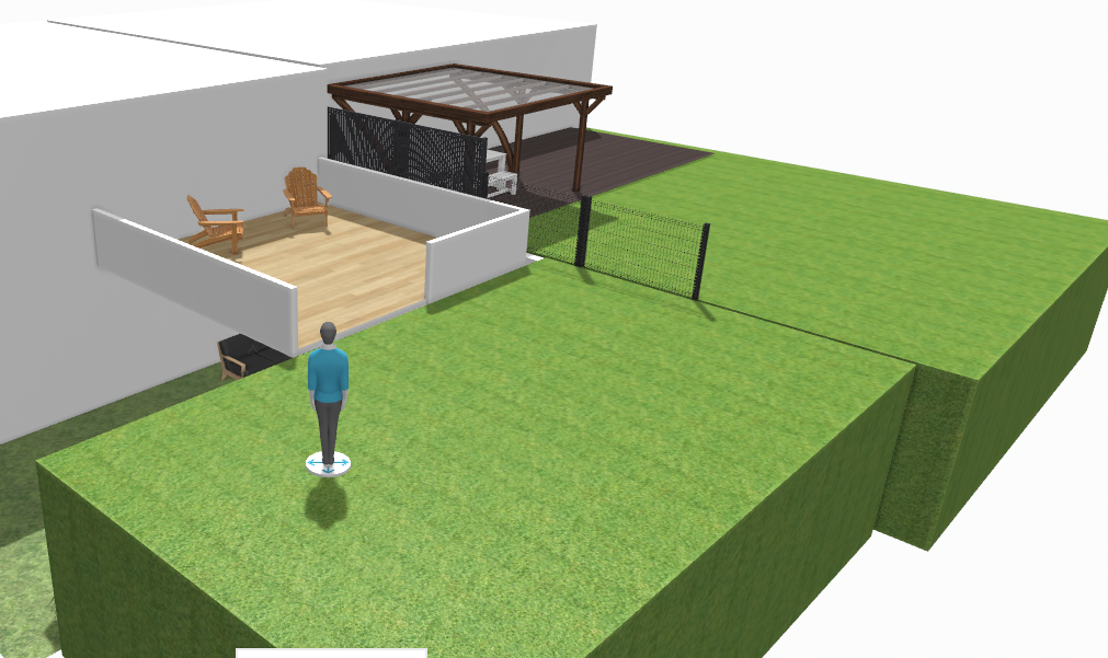

The offer for the exterior landscaping (€115,000, I mistakenly mentioned only €100,000 at the beginning) includes the retaining walls along the neighbor’s property and our house, underpinning of the neighbor’s retaining wall, L-shaped concrete blocks / support for our terrace after 10m (33 feet) uphill towards the slope, terracing of the southern outdoor areas, and groundworks.
Am I correct in understanding that you consider this completely unrealistic? Yes, I don’t think the groundworks are included.
Are you saying that it currently looks like this at the neighbor’s place (or similar)?
Glad we didn’t scare you off and that you’re still giving feedback.
You mean that it is now like that with the neighbor (similar)? Yes, and he also has a canopy.
Yes, I don’t think the groundwork is excluded. Basic excavation work is included according to the general contractor, provided the excavation material can be temporarily stored. However, we have also budgeted 36,000 for landfill disposal costs for uncontaminated soil, as included in the offer. Both the general contractor and we believe a significant amount can be reused for backfilling.

I didn’t quite understand the neighbor’s current situation. Are there no photos of the property with the neighbor’s house?

I didn’t understand the neighbor’s current situation. Why not? The original poster (OP) confirmed it as I described. Only that he also has a roof over his balcony. Exactly where Barnaby wants to have his terrace roof. Basically, Barnaby is adapting with his semi-detached house. It was just poorly communicated at the beginning.
