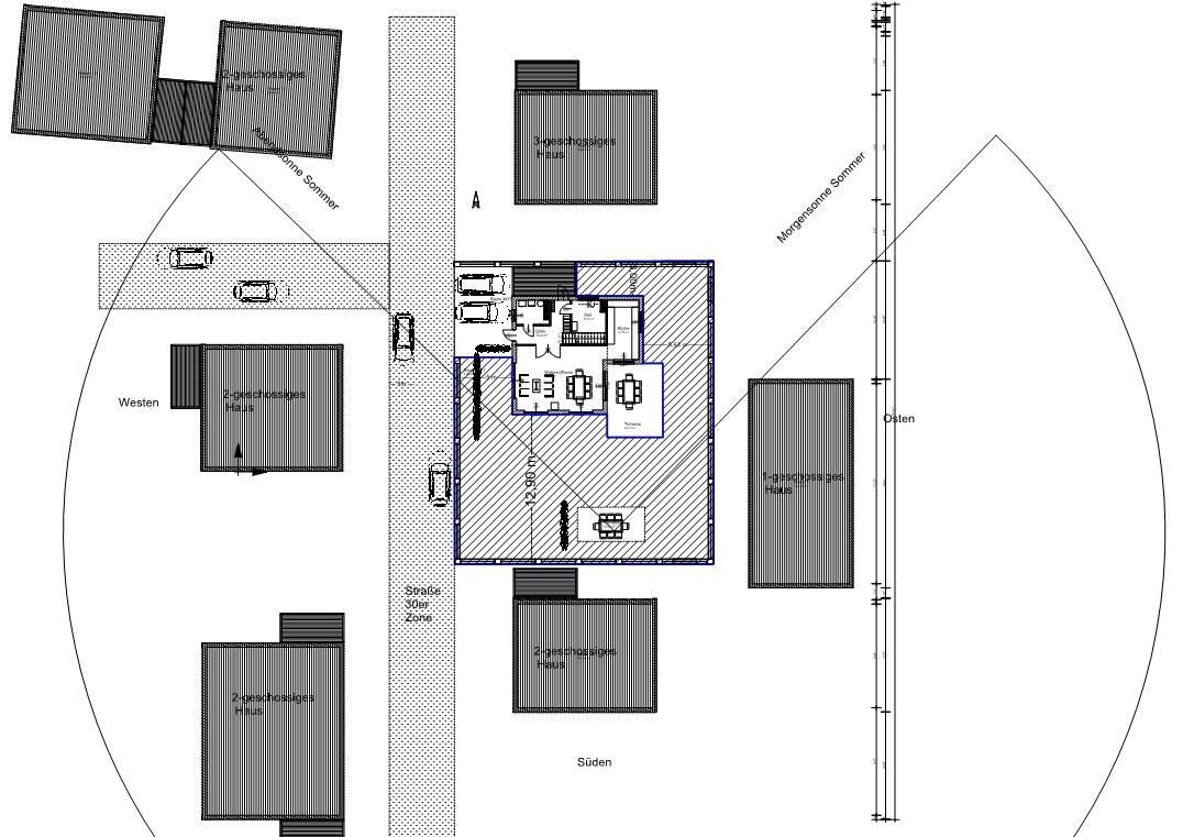

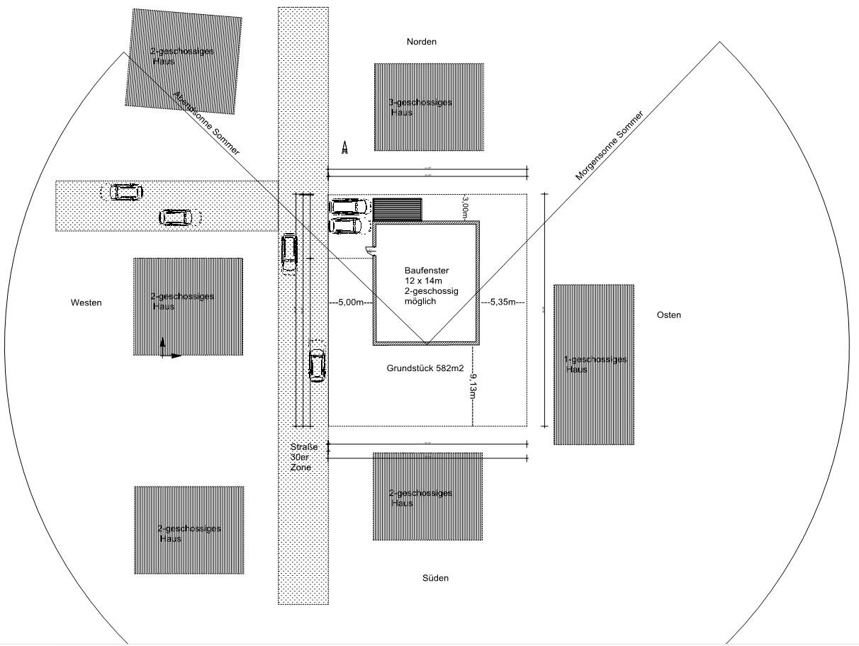

I have tried to accurately draw the surroundings of our plot to scale because we are having a hard time deciding where we would like to place the terrace and our living spaces.
The plot has a street with a 30 km/h (about 20 mph) speed limit zone on the west side. This is a street in a new development area that will consist of 40 single-family homes, so all the corresponding cars will be passing by our property. Our car parking spaces must also be located in the northwest.
I have often read that the terrace is preferably oriented to the west if you enjoy the sun. We do. However, for us, west would mean having the terrace facing the street side. We are somewhat unsure about the noise from the cars. It is hard to assess that with a 30 km/h (about 20 mph) zone.
There is also a maximum 80 cm (about 31 inches) high fence allowed, so people would be able to see directly onto our plates if the terrace faced west. The same would apply if we placed the dining room on the west side. And ideally, we would not want to be watched so much in the living room either...
I know the perfect solution (sun from morning until evening plus total privacy) does not exist...
Still, we would be interested in where you would place the garden terrace if you were in our position and which rooms you would locate on the west side of the house.
Looking forward to your ideas and suggestions.

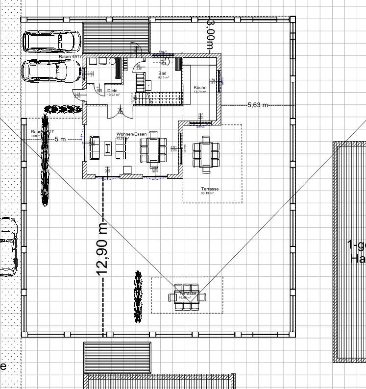

Thank you very much for your valuable ideas. I have attached an updated diagram showing the approximate room layout regarding privacy screening as we are now imagining it. However, we are still not entirely sure...
There are two types of 30 km/h zones: streets that only serve to access a residential area and are not useful as shortcuts or for avoiding traffic lights by commuters (and that don’t lead to supermarkets) tend to be quiet.
It is a street that only leads into a newly developed residential area. A traffic study on the traffic load for this new development is also available. It is estimated that a minimum of 196 and a maximum of 391 car trips will be made daily.
And with low fences, speedy drivers are afraid you can clearly see their license plates, so they tend to comply with noise limits.
I can understand that. However, the garden remains visible.
kbt09 schrieb:
... besides, a wide terrace on the south side fits perfectly here, also receiving sun from the west. On the west side, a narrower terrace with an evening sun bench.
The west side feels too close to the street for us, even for just a bench. We would prefer to create a second smaller terrace for the evening sun. In the updated diagram, I included an idea from us: we could make a second, somewhat smaller terrace in the southern part of the garden with space for grilling and seating. If we want the evening sun, we could simply move there. Or do you think that’s a bad idea?
We also considered planning a larger terrace on the south side with a retractable awning. It would be nice to have sun in the morning, at noon, and in the afternoon. We would only miss sun in the evening.
Or like this. The main terrace is closer to the kitchen here. Arrows indicate possible sightlines. For the evening sundowner, people usually add an extra seating area in another corner of the garden from where they can see their house.
Well, that was your idea too — having another corner for later switching to the evening sun. We like that as well.

That is indeed a major advantage of this option: you can rotate the terrace by about "half a compass point" off the ridge line/house axis.
Sarcasm? Half a step doesn’t sound like much. Although the floor plan would not allow windows on the west side exactly as is.

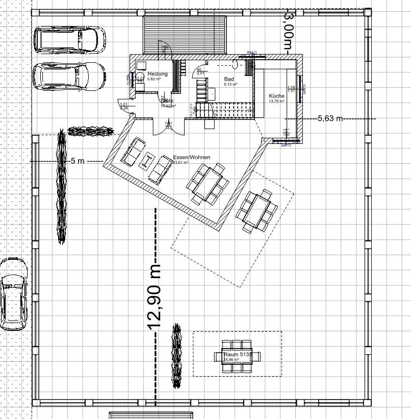

No irony intended. I meant that by rotating the floor plan by 45°, instead of having only a choice between a terrace oriented along the eaves or the gable side, you now have twice as many orientation options thanks to half-sized intermediate steps between the alternatives.
I'm not quite sure what is meant by the 45-degree rotation. I'll upload a picture. Is this the idea you have in mind? I think I don’t fully understand what you mean by rotating 45 degrees...

24 Apr 2017 20:14
The latter sight really gives me the creeps.
But whether the orientation is straight or angled: you will also get the morning sun from the east when building in the south, and since people usually spend more time in the evening than early in the morning watching the sunrise, I would place the recess on the west side and generally focus more attention there.
However, before you get into the details: the floor plan needs to be revised anyway – you have no storage or utility space on the ground floor, so there’s nowhere for beverage crates, empty bottles, tools, cleaning supplies, mop buckets, and vacuum cleaners. You probably haven’t planned any compensation upstairs either?
Anyway: the utility room is too small, the bathroom too large... but those can be swapped easily.
The door in the carport won’t work with a car, and you should also think about where you will actually enjoy the sunlight inside the house.
