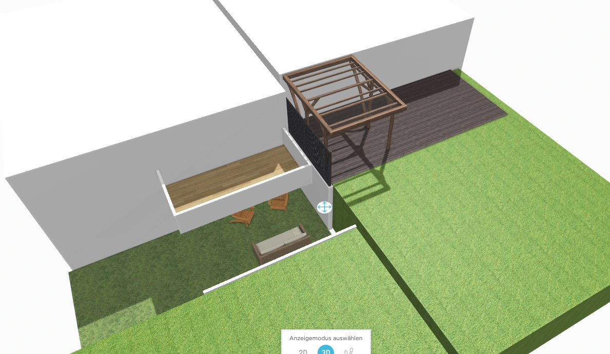

hanghaus20232 Apr 2026 10:08The neighbor does not have a gable roof house. It looks like a staggered shed roof.
hanghaus20232 Apr 2026 10:15ypg schrieb:
This is subject to neighbor law in the context of semi-detached housing. I agree. That’s why I have doubts whether the building authority will approve the plan.I see the costs skyrocketing! 1 million is definitely possible here.
hanghaus20232 Apr 2026 10:18ypg schrieb:
However, I also notice that in the basement utility room and the ground floor master bathroom, a window well is planned in each case, but these are limited by the design of the terraces (ground floor bedroom and upper floor kitchen). I also see some pointless solutions there.ypg schrieb:
There is no need for a simulation to show that the neighbor’s light will be significantly impacted. Quick and dirty sketch done briefly.
hanghaus20232 Apr 2026 10:47To somehow stay within the budget, build an extension onto the neighbor’s house. Keep the terrace at the same level. That should also be approvable under local building regulations/planning permission. Basement + ground floor + upper floor, no more is feasible. What was possible to build 30 years ago for a fraction of the cost can be seen in the neighbor’s house.
