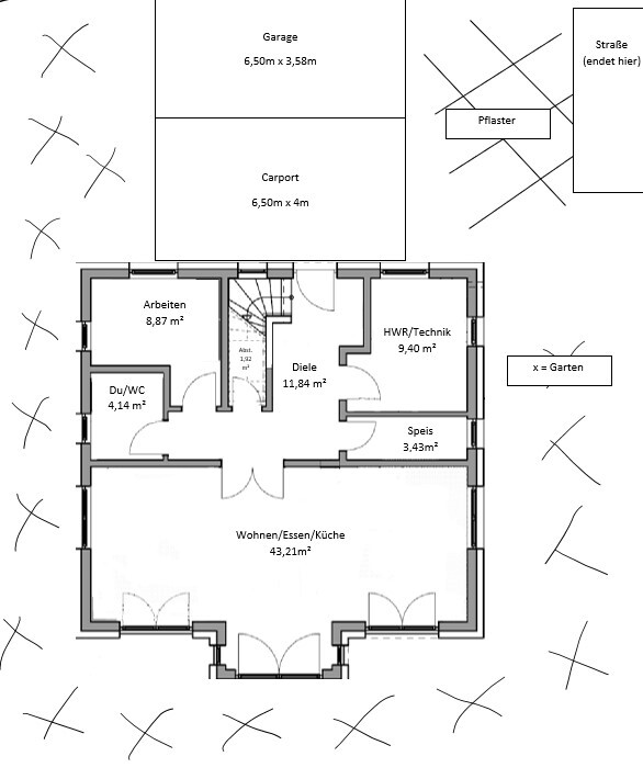

Bauherrin202418 Apr 2023 15:13ypg schrieb:
Where exactly should the mentioned items be located?
For that, we need at least a section drawing, including the roof pitch, knee wall height, etc.
Regarding the idea: redesigning the upper floor with a utility room in the attic. It would be nice if all family members or children could enjoy the great view and natural light.
Ps: especially the sightline from the entrance toward the open-plan living area door. The offset door doesn’t make sense in front of the storage room under the stairs.Thank you for your detailed input! Attached is a quickly sketched overview of the outdoor areas. The garage is positioned to the north, right on the property boundary. I forgot to include the side door from the garage to the carport in the drawing.
I have already added the section and roof pitch in the previous post; maybe you can give some advice regarding the attic.
I understand your concerns about the gable bedroom, but I’m not sure if my partner’s request is negotiable. He has set his mind on this idea firmly. However, I’m open to suggestions to present to him 🙂 Moving the door downstairs and relocating the utility room to the upper floor is a very good point, thanks for that! So, you would separate the technical room and utility room, right? Then perhaps the mudroom could be integrated into the technical room?
If you have a section drawing, please upload it, or should we redraw it? In general, I think the 2m (6 ft 7 in) lines from the attic are already correct.
Also, just a few exterior measurements of the entire house unfortunately don’t provide a clear overview. That means you have to estimate or measure each room dimension yourself.
How often is the study actually used for work?
And I’m really interested in the bedroom layout, since there is a support column planned right in the middle of the room.
