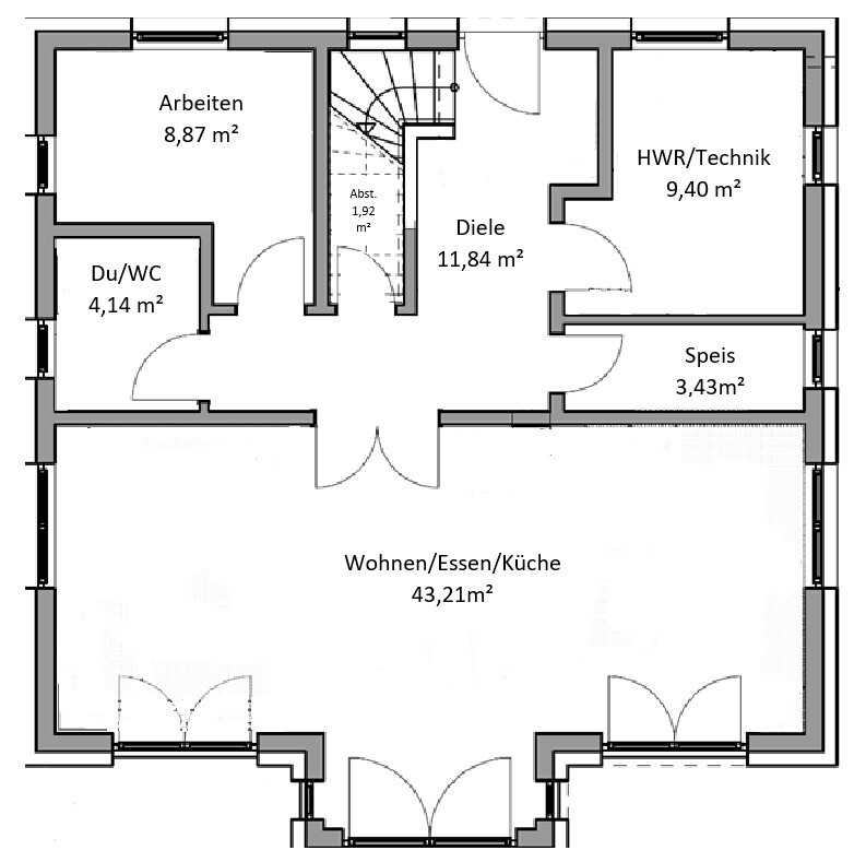

1.: What was forgotten: our big wish for a “mudroom.” We have a dog, horses, and a goose, so we come home with dirty shoes and pants (some of which also smell a little). We quickly dismissed the idea of extending the garage and putting everything back there to change, because our things need to dry there (= heating). My dream would be a second entrance from the garden or carport leading into a separate room, ideally adjacent to the utility room (with a door, as I don’t want my riding boots drying next to the white laundry). I just haven’t had the perfect idea yet on how to implement this elegantly.

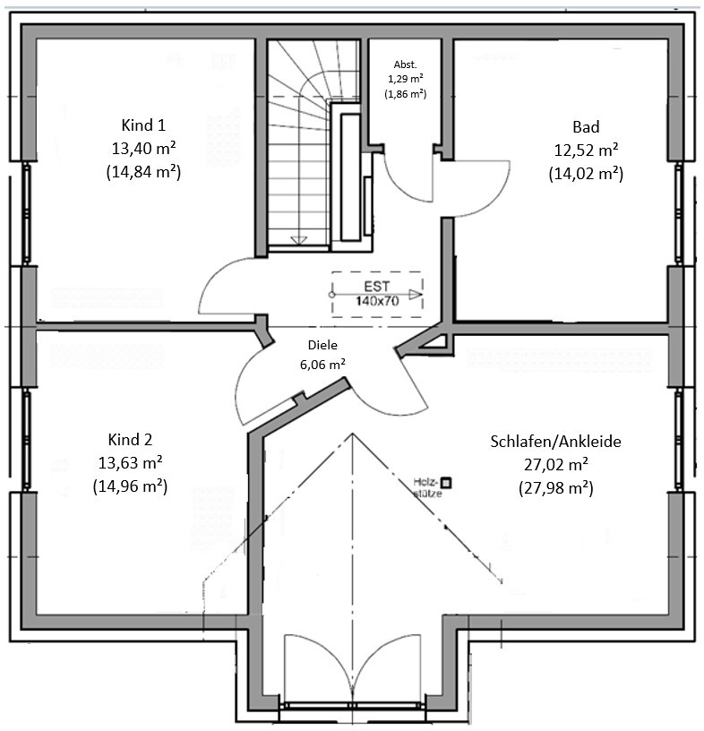

2.: The bedroom is too large. We want the entire gable as a bedroom because we have a fantastic view. However, 27m² (290 sq ft) is huge, even with a walk-in closet. Do you have any ideas on how we could redesign it?

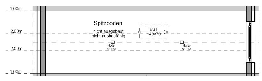

3.: I had hoped that the attic could possibly be used later as an additional office/dressing room or similar. Now the building planner told us that the attic is too small for such purposes and therefore did not include a fixed staircase. This surprised me a bit, as I find the attic in a similarly sized house at a friend’s place quite spacious. Am I missing something, or am I misreading the drawing? Are the 2m (6.6 ft) lines the exterior dimensions or actually the (insulated) ceiling height inside? Is there really no way to make use of the attic space with these dimensions?

Thank you for your explanations. Maybe I can still get some general tips here in the thread on how to incorporate a mudroom into a floor plan. For general ideas, the exact measurements are not really that important. You have received both a suggestion from me and an objection (freezer chest doesn’t fit in the pantry) explaining why the measurements are indeed important.
So far, I’m still waiting for your feedback on this. What are the dimensions of the pantry? How is the freezer chest supposed to fit in there? Why wouldn’t a side-by-side refrigerator be sufficient?

I hope you have noticed that I have thanked each constructive contribution with a like and verbal appreciation, and have always tried to provide relevant information when asked. I am truly very grateful for your objections. For example, I really appreciate the concern about whether a chest freezer would even fit in the pantry (we would like it mainly for storing homemade dog food, which I prefer not to keep in the refrigerator). I must honestly say that, especially due to your questions, objections, and criticism of the planner, I am becoming increasingly dissatisfied with this "ruined standard floor plan." The more I calculate, adjust, and plan based on this floor plan, the worse the solution appears. Without going into more detail about the floor plan I uploaded: what would be the best approach for me to achieve better results on a second attempt?
I have now acquired floor plan software and am currently redrawing our wishes, combining them with your valuable advice (all individual dimensions are included here). Should I share my new plan with you again? Or would you rather advise me to "please go back to the planner/somewhere else and have everything redrawn"?
I must say I am somewhat disappointed with the outcome of our draft. Of course, we said it would be great to have the bedroom occupy the entire bay window, perhaps with a slanted wall so that the other rooms wouldn’t be so small, but that this would be implemented exactly 1:1? Actually, the whole point of hiring a planner was that I have no expertise and that they would show me with their knowledge if my approach was wrong or if they have a much more efficient solution.

As an example, I’m really glad about the comment questioning whether a chest freezer would even fit in the pantry (which we would like to have just for preparing raw food for our dog, something I don’t want stored in the fridge). I have to honestly say that, especially because of your questions, objections, and “complaints” about the planner, I am becoming increasingly dissatisfied with this "messed-up standard floor plan." We’re glad if we were able to highlight the poor performance of your planner and that you are now on your way to becoming a more demanding consumer of planning services. After all, a carelessly designed house doesn’t cost any less. The fact that I currently have to give a new cookie consent for every single (!) page refresh makes me a bit lazy to check again—but at least it feels like the info about the dog being fed raw food is new to me. Such seemingly minor details can be essential when it comes to advising you appropriately.

I have to say I’m a bit disappointed with what came out of our design. Of course, we said it would be great if the bedroom occupied the entire bay window, maybe with an angled wall so the other rooms wouldn’t be so small—but that it would be implemented exactly 1:1 like that? Actually, I am using a planner because I have no clue and expect them to show me with their expertise if I am on the wrong track or if they have a much more efficient solution. It’s still unclear to me what input you provided for the plan shown here, and where you felt you were not listened to properly. Planning expertise is rarely found with a building contractor; for that, you need to go to a proper architect. In some cases, that might not be necessary, and I’m happy to guide you to alternative approaches if those are more efficient for your project. What never works well, as I said, is to take a standard design and then try to “stuff” additional wishes into it (which inevitably happens when you just add more wishes without increasing the overall size). Such an angled wall as in your example leads to unnecessarily complicated connections between building elements. The professional (or even a crime scene photographer or a pet shop assistant) should be able to come up with a better solution.
hanghaus202324 Apr 2023 09:09You can try searching on American websites, for example using "house with mudroom floor plans." There are plenty of options available.
