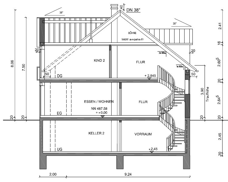

What will be the stair pitch?I’m not sure now. Can it be calculated from the section based on the room height? The screed will include underfloor heating.

No, you can’t fully determine that from the floor plan. The ceiling height is 284 cm (112 inches), and I only counted 14 risers, which equals about 20.2 cm (8 inches) each—relatively high. However, the tread depth of the stairs is also important.
