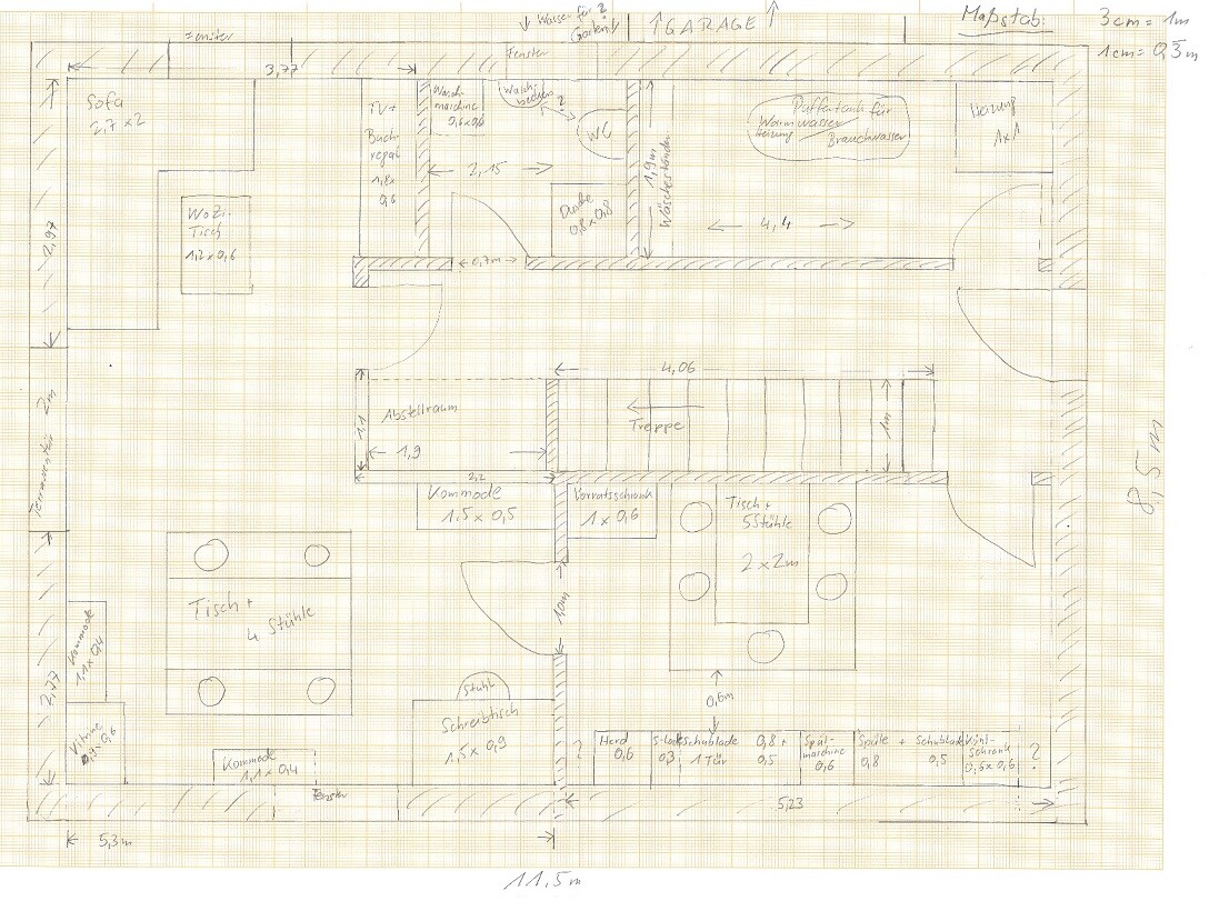

Vali-Hausbau30 Aug 2020 21:16Hello to the forum community.
A few weeks ago, we received approval to purchase a plot of land (No. 10) and are now considering the best way to design our house. We plan to build with a general contractor (GC) using solid brick construction. In 2-3 weeks, we have several appointments with GCs who have been recommended to us by multiple acquaintances based on their own experience.
The GCs would like us to provide a rough draft so they can prepare a concrete offer.
Some information about the pictures:
- The small triangle on the development plan indicates the designated garage driveway.
- The development plan is oriented north – a small footpath borders our plot to the north.
- The windows are not yet finalized, only roughly drawn.
- Most existing furniture, including the kitchen, is drawn to scale. The children’s furniture will likely be rearranged several times. The kids' rooms should have space for one bed, one wardrobe, and one large desk. Additionally, a cabinet will be included as storage for less frequently used toys. The bathroom fittings are still flexible.
- We currently have the living room/dining room layout with a frequently used PC desk and have experienced no disturbance among adults.
We look forward to feedback, questions, and suggestions from the forum community.

Can the upper floor be modified to include a practical small spiral staircase to the attic? Currently, a folding ladder is planned – making the attic usable only as a storage space accessed about once a month.
Is it possible, within the height restrictions (ridge height, max wall height on eaves) and possible roof pitches (20-35 degrees), to convert the attic into an actively usable storage area? We only require about 2.50m (8.2 feet) ceiling height on the ground and upper floors.
Why have two such large dining tables? I don’t think a workspace right at the dining table is very appealing since it’s not always tidy, is it? I would rather set aside a separate corner so that bills or similar items don’t have to be quickly cleared away when guests arrive. Also, there is a lot of wasted space to the right of the table in the kitchen.
I also didn’t understand the idea of having two dining tables. And the kitchen overall is unclear to me. So much space for a single kitchen run, which apparently isn’t properly integrated? It looks like an existing run that is slightly too small.
The two bathrooms upstairs don’t seem optimal either. Both rooms have a lot of free space, so the layout could be more efficient. Perhaps a utility room could still be carved out upstairs?
3 bathrooms for 3 people?
Dining areas where at one of them, people are squeezed between the table and the cupboard?
No cloakroom, washing machine and dryer stacked on top of each other due to lack of space, the workspace squeezed into a corner.
Why not one less bathroom? Children can also use the stairs while getting ready at the same time.
Why not have just one dining area in an open-plan kitchen?
I have two more points: The topic of "storage space" seems very important to you. Do you currently live in a house with a basement, or do you have hobbies that require extra storage? Of course, it’s important to find space for your belongings, but sometimes people just accumulate things they don’t really need. Unused toys can be stored in the attic, and you could also consider giving away or selling some items.
On a second review, I still find your floor plan unbalanced. You’re wasting space in some areas while your dining room is overcrowded. With all the cabinets and the additional desk, it would feel cramped and uncomfortable to me.
Second: Your budget isn’t exactly generous. Does it include additional construction costs and landscaping? Financially, I don’t quite see the conservatory fitting in there.
