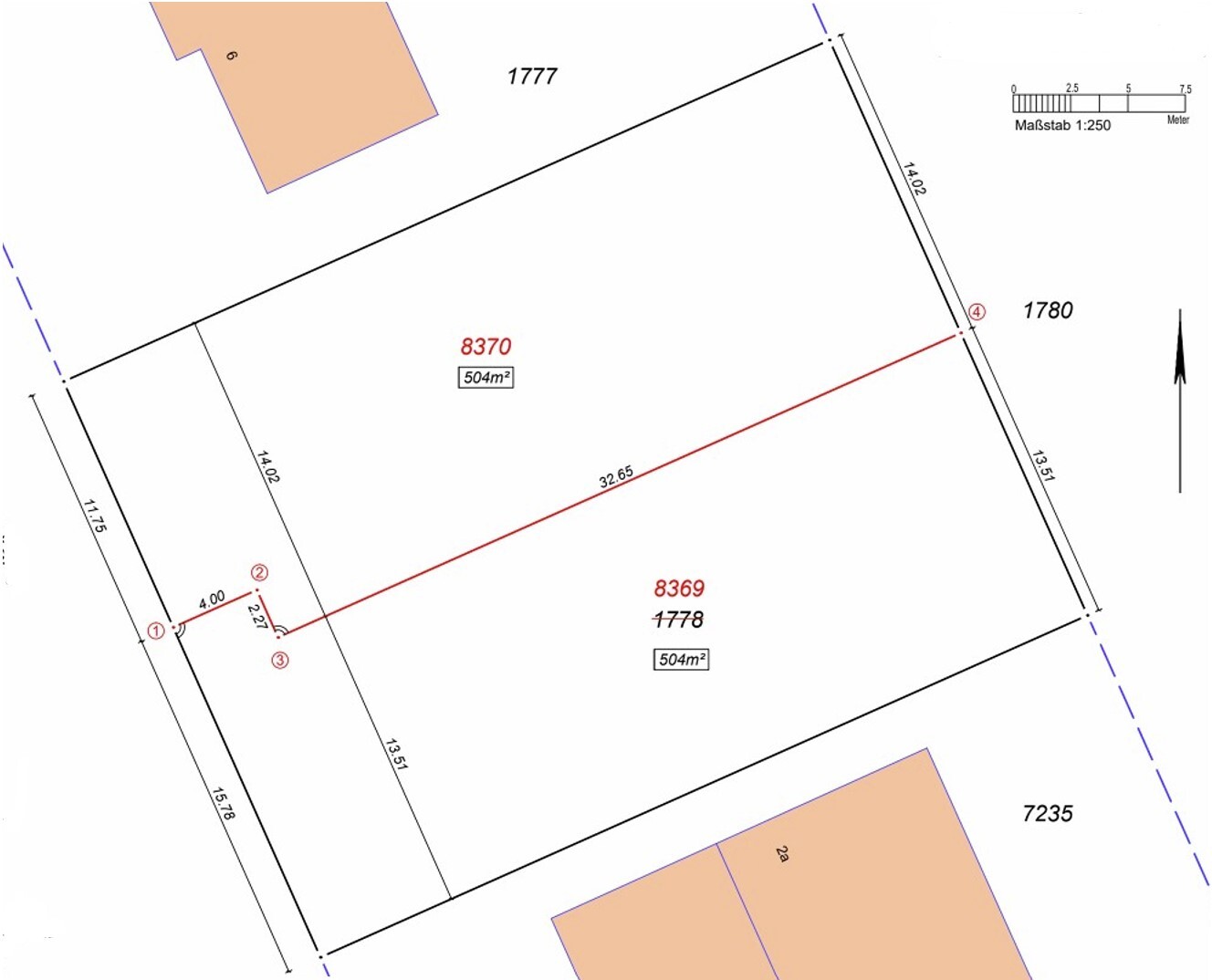

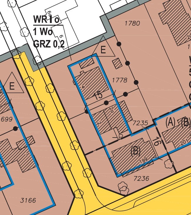

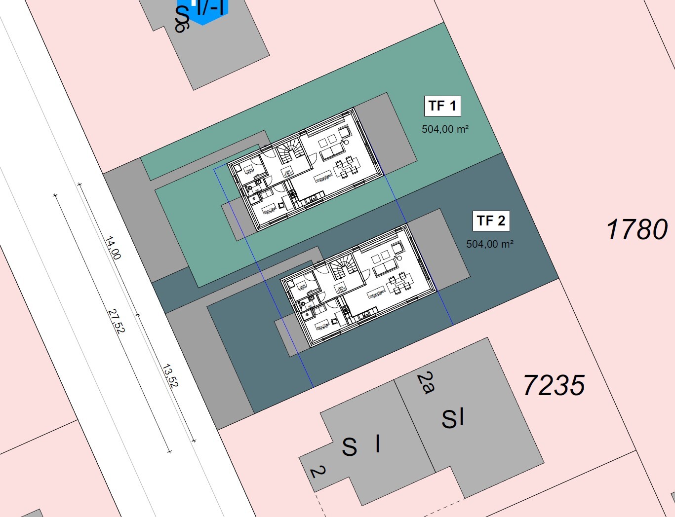

My wife and I purchased a plot of land in Hamburg in October. The financing is secured, a general contractor (production home builder) has been selected, and now we are working on the fine-tuning (or maybe a complete rethink?) of the floor plan. The 504 m2 (5,420 sq ft) parcel (lot 8370, see subdivision plan, lot 1778 in the development plan, TF) is part of a larger property and was found through a project developer who carried out the concept design. Here is the initial questionnaire:
  • Plot size: 504 m2 (5,420 sq ft), dimensions as per subdivision plan
  • Slope: no
  • Site coverage ratio (floor area ratio): 0.2
  • Floor area ratio: none specified in the development plan
  • Building envelope, building line, and boundary: Based on the building envelope depth of 15 m (49 feet) and the plot width of 14 m (46 feet) after subdivision, minus setback distances (2.5 m / 8 feet on the right and 4 m / 13 feet on the left, as it is the end of the building envelope), a buildable area of 15 x 7.5 m (49 x 25 feet) results. Due to the site coverage ratio of 0.2, a house with external dimensions of 13.60 x 7.35 m (45 x 24 feet) can be constructed. The project developer who planned this (double) plot recommended leaving a 15 cm (6 inches) tolerance to the full width.

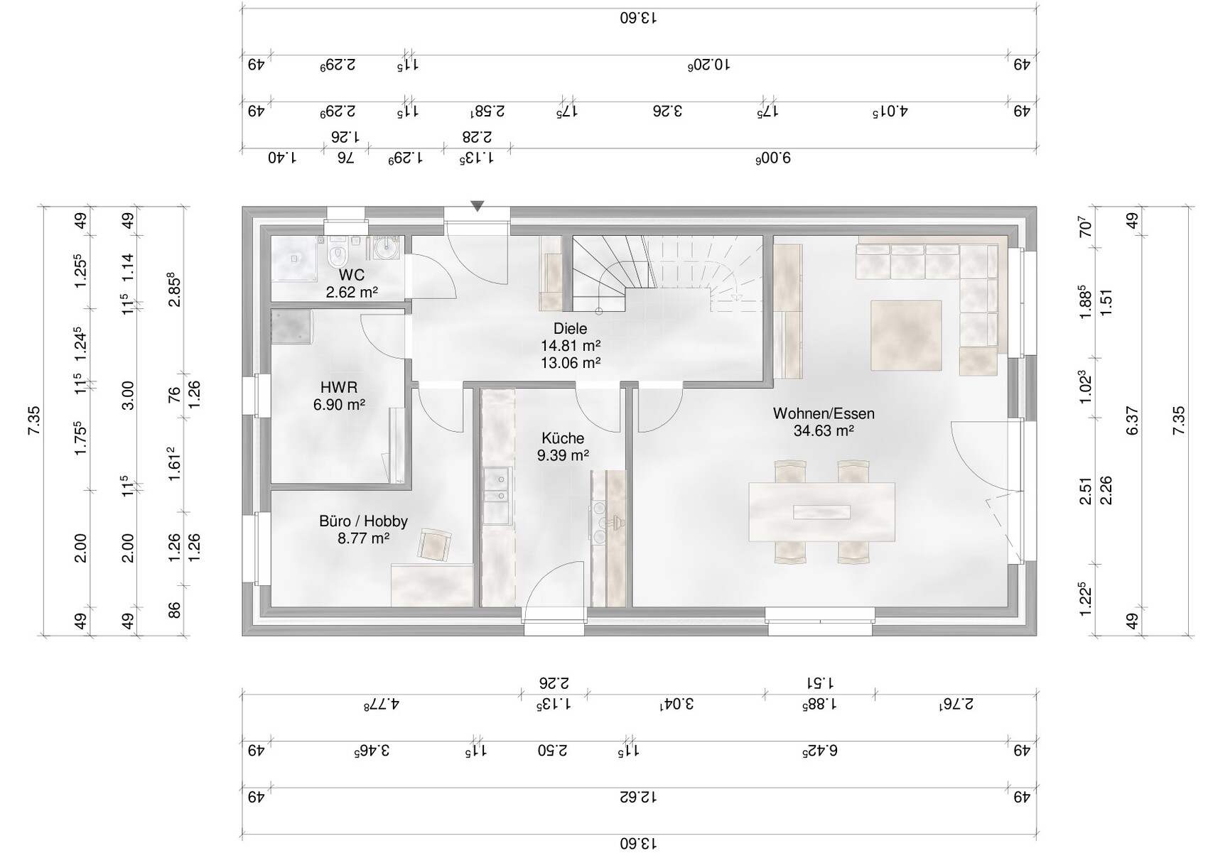

  • Space requirements on ground floor:
  • Living/dining room, shower bathroom, utility room/technical room, kitchen, office/hobby room (space for a desk and a drum set approximately 2 x 2 m / 6.5 x 6.5 ft)

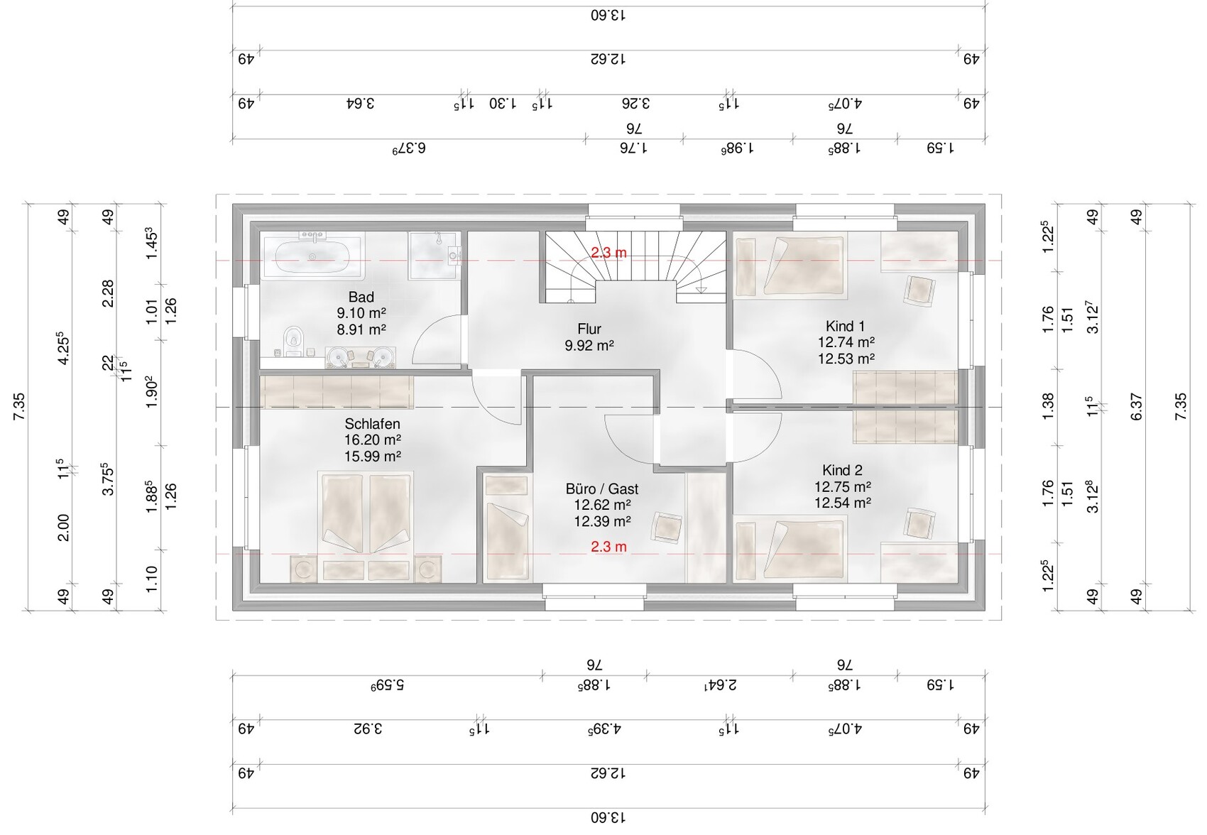

  • Space requirements on upper floor:
  • Bedroom, 2 children’s rooms, full bathroom, office/guest room (space for desk and a double guest bed, likely a fold-out sofa)

  • The office/hobby room on the ground floor is only 2 m (6.5 ft) wide as it mainly needs to fit a drum set roughly under 2 x 2 m (6.5 x 6.5 ft) and a desk.
  • Additional storage space is planned under the stairs on the ground floor and in a niche to the left of the stairs on the upper floor, to be enclosed with drywall partitions later as a DIY project. This is not currently shown in the floor plan.

  • L-shaped living room
  • Room layout upstairs (bedroom not directly adjacent to children’s rooms)
  • Elongated kitchen shape – we do not like corner cabinets :p
  • Space for wardrobe (to the right of the entrance)
  • All required rooms are included
What do you dislike and why?
  • The kitchen could be somewhat larger
  • Access routes to the ground floor office/hobby room and the upper floor office/guest room and second child’s room require relatively large circulation space. We are currently looking for ways to use the available floor area more efficiently.

148 square meters (1,593 square feet) is not a lot of space for 4 people, and I think this floor plan is quite well designed for that.
The ground floor feels too compartmentalized for me—I would remove the wall between the kitchen and living area, and I would also remove the short wall between the living area and stairs. However, that would create an open-plan space, which I would recommend for a ground floor of this size.
Finally, I would try to untangle the "junction" at the back of the ground floor between the utility room and office somehow...

Overall, I find the floor plan quite good. There are three points I would like to mention:
1. If you plan to put something that is 2m (6.5 feet) wide in a room, you should allow for slightly more than 2m (6.5 feet) in width. These are often rough construction measurements! Whether it’s baseboards or minor construction inaccuracies — if I know I want to place something 2m (6.5 feet) wide, I would plan for around 2.05m (6.7 feet).
2. The route between the kitchen and living room would drive me completely crazy in everyday life. If you want to design this as a closed-off space, I would suggest optimizing the path a bit.
3. The utility room seems very small to me. Are you sure everything you want to put in there will fit?
Which brings me to my conclusion: I would rearrange the entire area of kitchen / utility room / hobby space a few times and possibly plan it out with actual furniture.

To create a bit of storage space, we opted for a 35° gable roof with the highest possible knee wall (1.85 m (6 ft 1 in) from the raw floor).
Why isn’t a full additional floor possible as an upper floor?
I doubt the placement of the shower upstairs with a knee wall height of 1.85 m (6 ft 1 in) from the raw floor! This also results in the narrow slit windows on the long sides.
The 2.30 m (7 ft 7 in) ceiling height line also seems a bit optimistic to me.
On the ground floor, I would swap the kitchen and living room so that the living area faces the terrace. Regarding the other layouts, I agree with @Papierturm.
