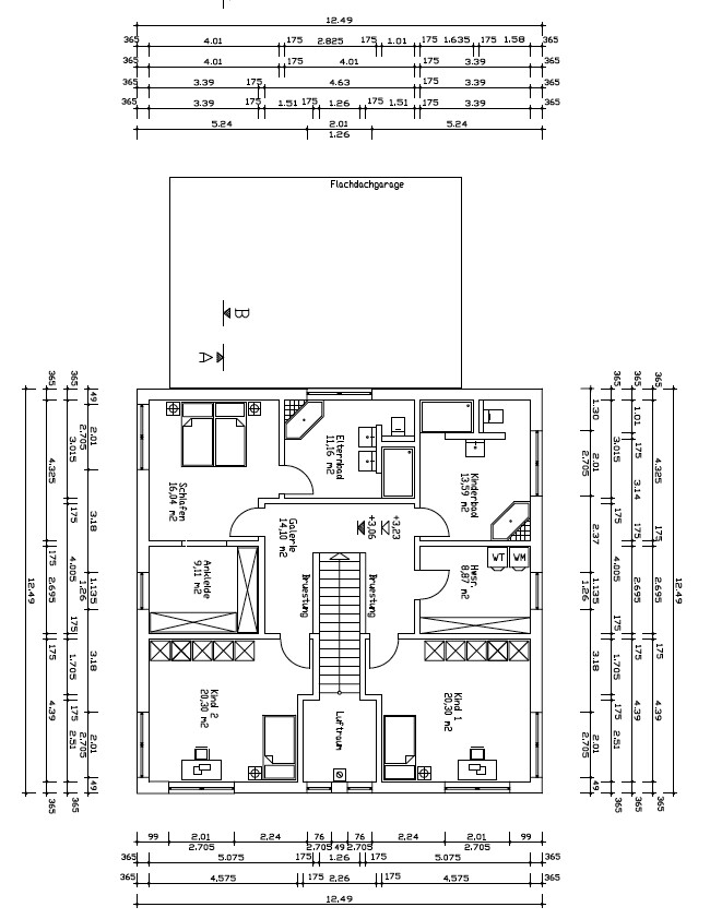

I would like to start a new thread regarding the initial design planning.
Previous thread: Single-family house – Opinions on our design
https://www.hausbau-forum.de/threads/Einfamilienhaus-Meinungen-zu-unserem-Entwurf.25622/
Here are the main points:
The foundation slab is already in place: 12.49 x 12.49 m2 (41 x 41 ft2) and 30 cm (12 inches) thick.
The foundation slab was inspected for quality by an energy consultant and a structural engineer – no issues were found.
The locations of the underground drainage pipes are marked in the image titled "Foundation Slab - Drainage Pipes."
The house is planned to be built on the existing foundation slab. Demolition is not planned.
The house needs to be constructed as a one-story plus attic (E+1) with a gable roof at a 22° pitch.
The original submission plan from the previous owner was applied for but has not been received yet.
Our own submission plan from the architect exists but was mostly rated as unsatisfactory.
Negative points in the submission plan:
Our specific requests:
We like the ground floor and its room layout quite well. However, the half-landing staircase should be replaced by a space-saving alternative.
The staircase was placed centrally to allow the desired rooms to be created.

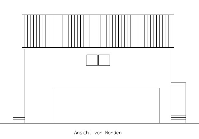

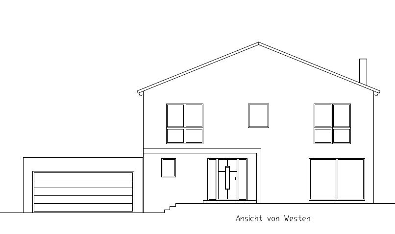

- See east elevation under the image “View all sides”
- The balcony was extended because the upper floor protrudes 70 cm (28 inches) beyond the ground floor, covering the resulting overhang. In the previous plan, the balcony was only above the bay window.

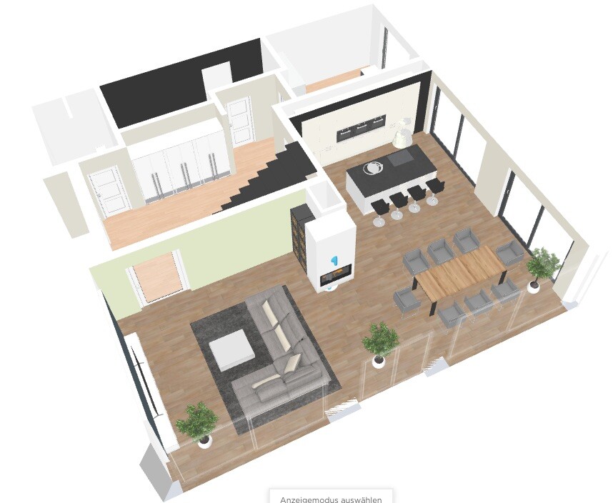

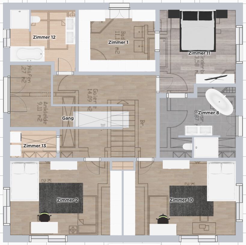

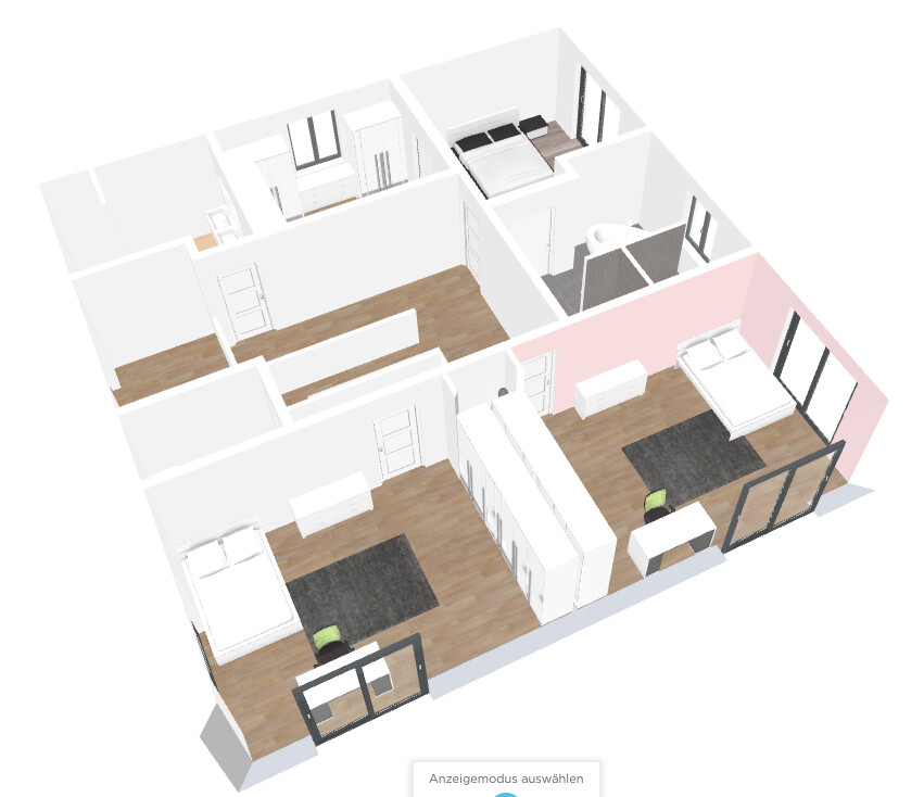

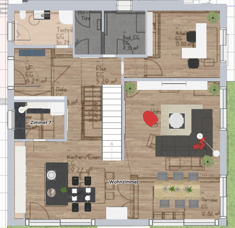

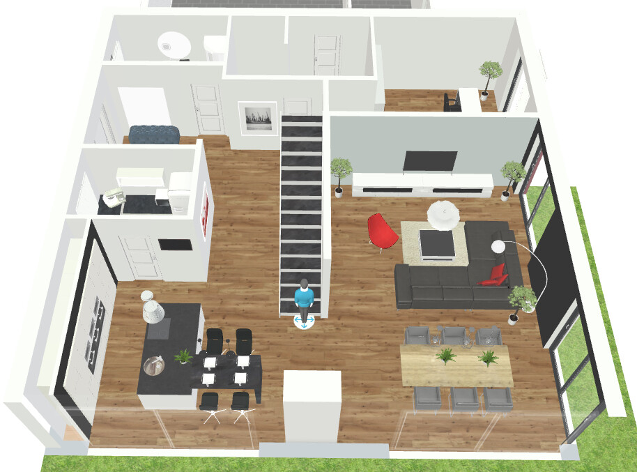

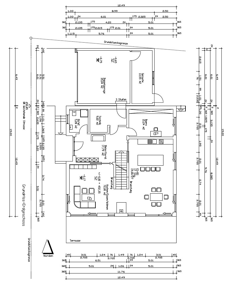

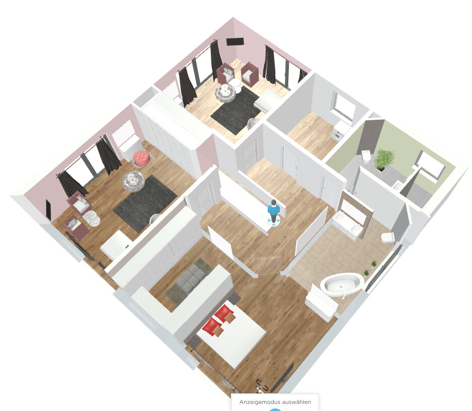

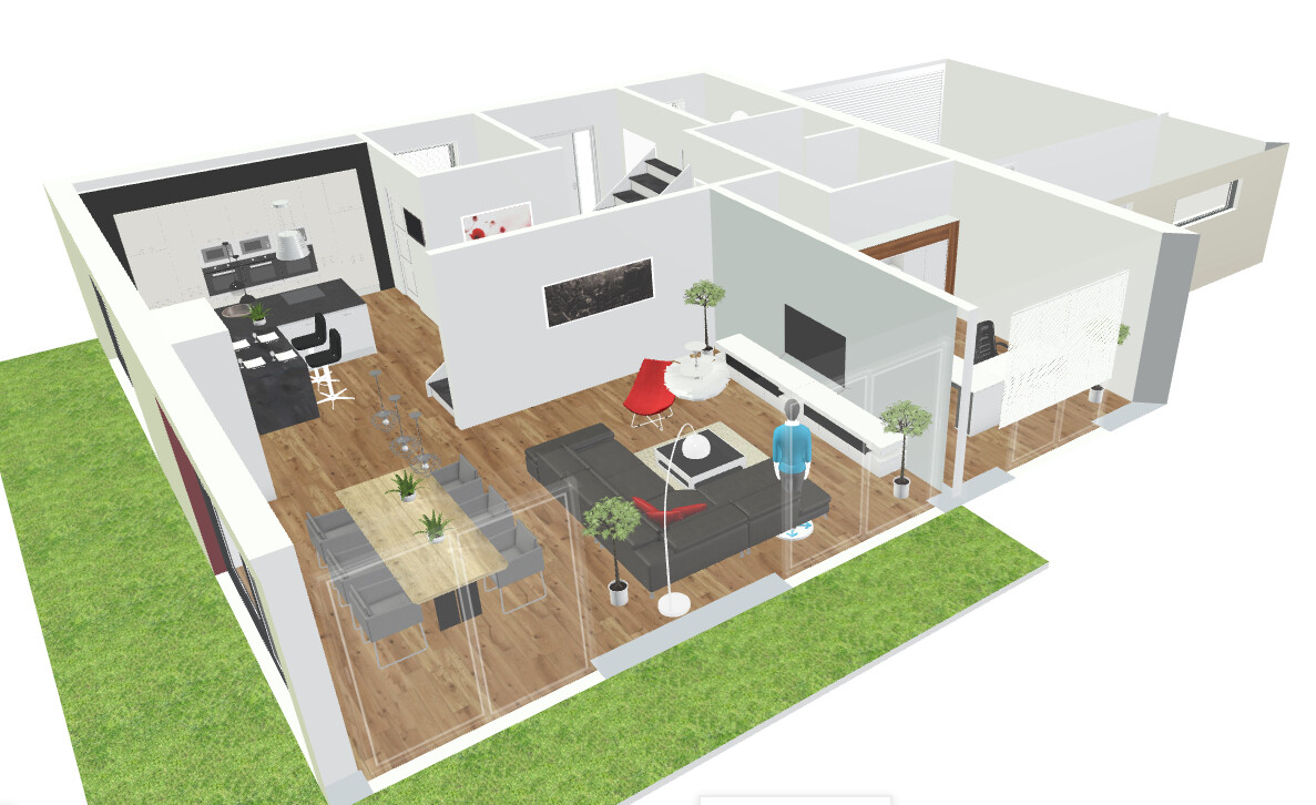

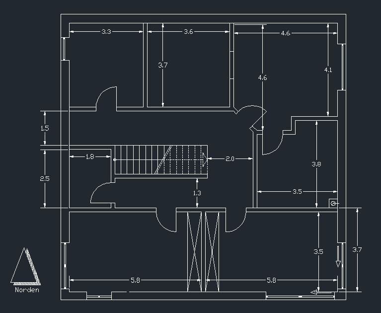

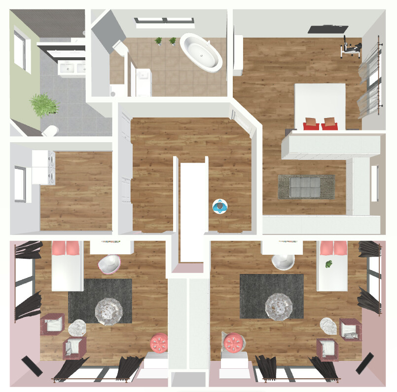

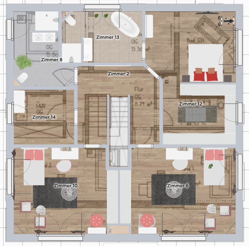

Hello, thank you for the many responses. As several of you have mentioned, we are also considering relocating the fireplace toward the living room and installing windows with a width of 1.20 m (about 4 feet) at the gallery.
The open space is intended to bring light into the stairwell and the upper floor. A dark stairwell has always bothered us in the earlier designs.
We will enlarge the utility room slightly to have space for boxes and the vacuum cleaner. For the other items, we have planned a separate room in the garage.

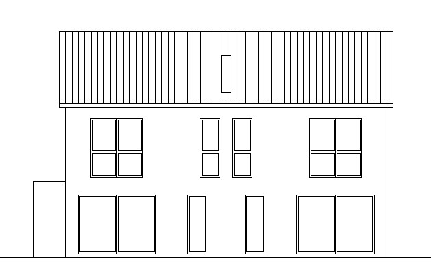

If I think about it further: why is the staircase so set in stone here? Wouldn’t it make much more sense to rotate it by 90 degrees? The staircase itself has already been significantly changed. To me, the only thing set in stone seems to be that it has to be a staircase worthy of an architecture magazine. I would probably opt for a quarter-turn L-shaped staircase with the first step located just behind the front door.
I’m also not happy with the chimney, which ends too low in the drawings. I assume there is an attempt to get an exemption from the required 5:4 aspect ratio of the building volume specified in the regulations — I definitely welcome the removal of the small balcony for the children’s room. Otherwise, I see the latest design more as a commendable fresh start than as a final result.
@11ant --> Nothing in the drawing is set in stone. We have already changed everything anyway. Because of the missing thermal break (Isokorb), I decided to cancel the originally planned bay window. Insulating or cutting through the foundation slab seemed too risky in terms of potential long-term damage. Now we need a special permit from the district office.
