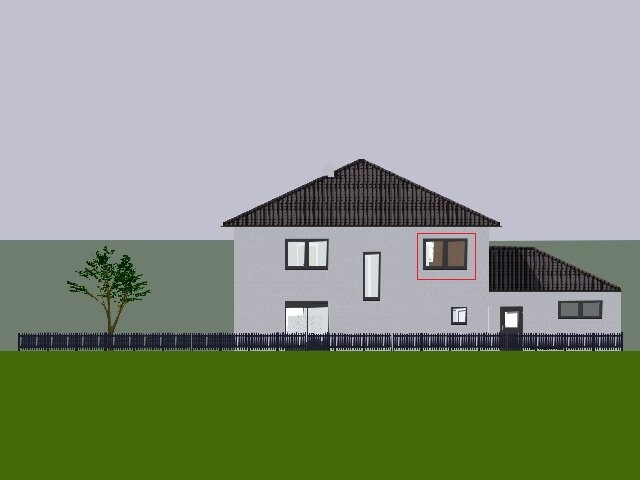

Edit: In the east elevation, you can see two odd stairway windows. Please imagine these as a continuous window strip or something similar – my software struggles with the ground floor ceiling and won’t allow a continuous window there.

@BeHaElJa, it would probably look something like this, couldn’t change or display it differently with a basic graphics program.
Two-story house with tiled roof, garden fence, tree on the left and green lawn under a gray sky.
At the moment, I’m leaning towards extending the garage roof further east. This way, it would create a kind of covered space / wood storage area.
I recently saw this with friends who have already added onto theirs after 5 years. What do you think? (regardless of potentially higher costs due to the larger roof area).

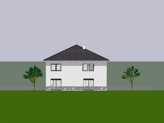

but that would already be hinted at, or did you mean the width as well?
Two-story white house with dark roof, flanked by trees, garden with fence.
A two-story gray house with a dark tiled roof, extension on the right, windows, garden fence, and tree.
For example, I’m still considering a floor-to-ceiling window in the master bedroom on the upper right... or would that be too much?
