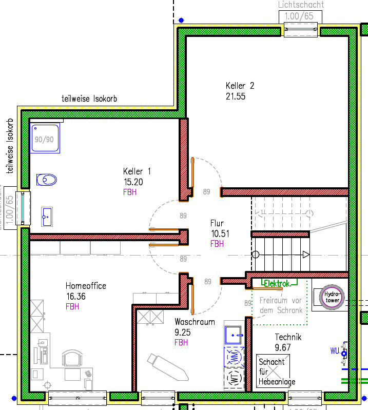

Could you please upload the latest ground floor plan again? Because that’s where your mentioned shower toilet is supposed to be, at least I don’t see it in the basement.
Also, it’s important right now since you need the load-bearing elements. I’d say: once the ground floor is optimized, the basement has to be adjusted accordingly.
Could you please share the latest ground floor plan again? Because that’s where your mentioned shower toilet is supposed to be; at least I don’t see it in the basement.
Also, it’s important right now since you need the load-bearing elements. I would say: once the ground floor is optimized, the basement has to adapt to it.The shower toilet in the basement is planned right next to the home office.
We have placed the toilet and shower freely in the space for now; a more detailed plan hasn’t been developed yet.
I would like to have the home office there because I want to benefit from the natural light coming from the light well.
Current challenges:
- The “living basement area” should include a sofa bed
- Since the home office will also be my hobby room, I would like to set up a TV
- Plus a sofa bed
- We find the toilet/shower area too large for the entire “Basement 1” space, or put differently: we don’t want to dedicate the whole room to the toilet/shower
- We considered an access door from the home office
- We find the room layout somewhat awkward, especially because of the spatial complexity
- The load-bearing walls are the walls of the basement corridor
I would swap the laundry room with the bathroom in the basement.
You don’t necessarily need the natural light from the light well in the laundry room.
By the way, the loops of the underfloor heating in the laundry room don’t need to be laid as closely together. My wife always complains that it’s too warm in the laundry room...
