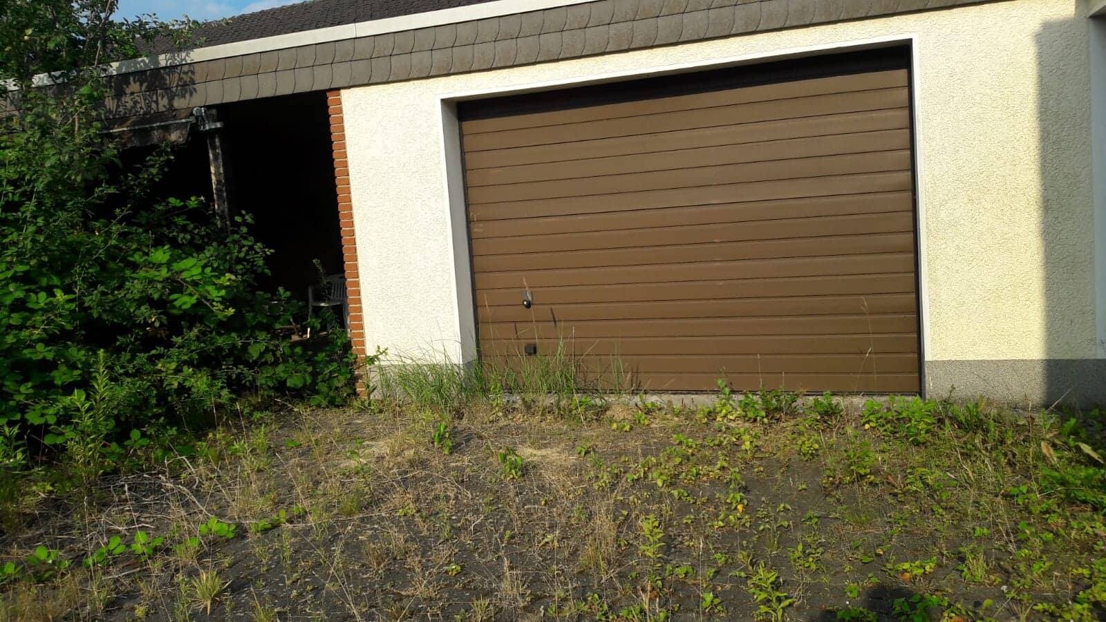

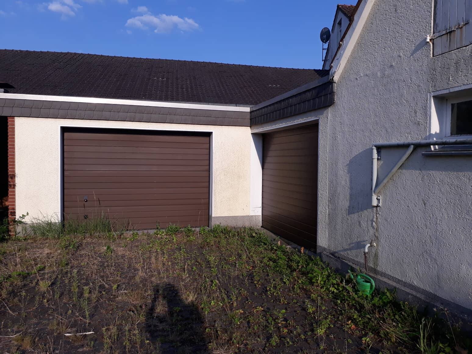

tumaa
3 Oct 2018 18:10
You can leave the existing structure as is – what reason would there be not to?
Without a lawyer... I mean an architect, I wouldn’t plan anything there at all. At least not the location on the plot!
I have uploaded some photos of the garages... the roof belongs to the neighbor.....
Brown garage roller door in front of a neglected driveway area with weeds and shrubs.
Exterior view of a house with two brown garage doors and an unkempt front yard.
3 Oct 2018 18:13
tumaa schrieb:
I uploaded some photos ... the roof belongs to the neighbor .....
What is this now?
I really don’t understand how someone can not remember the dimensions of their plot by heart.
