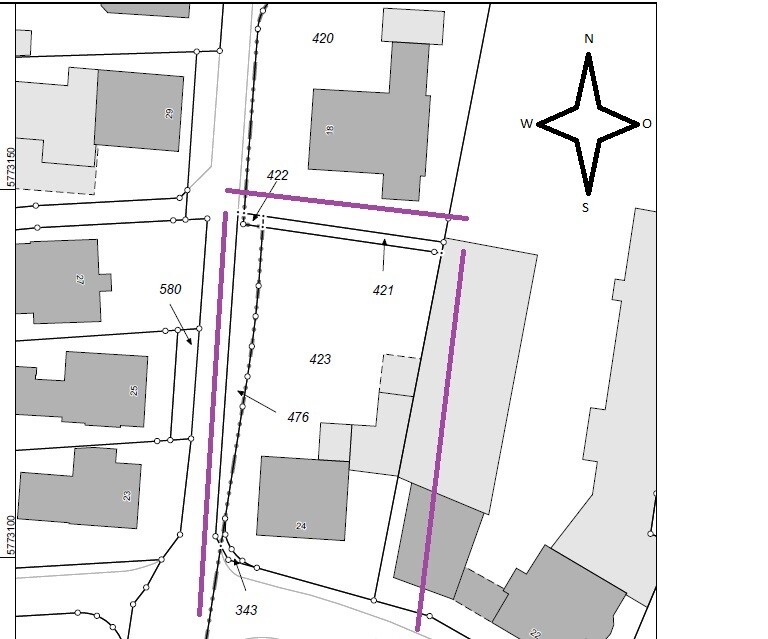

A few details about the plot (there is still an old building on it, which will be demolished, see property 24):
- 1170 m² (0.29 acres)
- no slope, flat
- site coverage ratio & floor area ratio (I’m on the road and need to check these later)
- next to it is a carpentry workshop and the carpentry’s storage hall; a 5 m (16 ft) building setback must be observed.

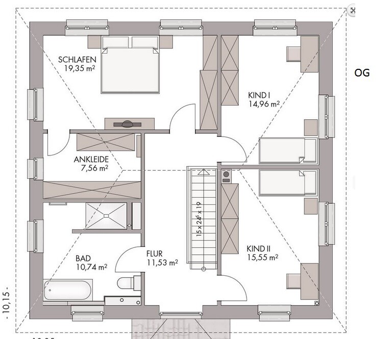

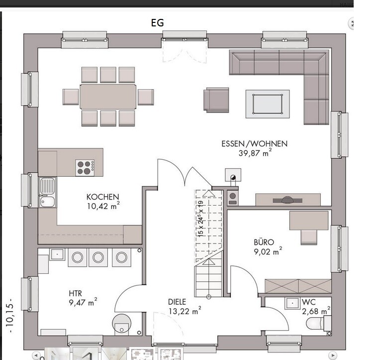

- We like this sample plan (see attachment). What do you think of it? (The attic is not included, the room layout fits well.)
I appreciate any useful comments .... (probably also a matter of taste)

1) The economy town villa floor plan is designed for one less child.
2) Trying to fit it into a steeper roof will be a Pyrrhic victory in terms of cost compared to the traditional method of simply increasing the floor area sufficiently.
3) If the architect considers this floor plan a solid basis, they would fail the test of “a good architect must be able to set the client straight.”
You also have to be able to read criticism. And then it says, quite constructively:

Why don’t you build a house with 3 children's rooms instead? So without the roof option? It’s generally better to have everything on two floors!
However, 150 m² (1,615 sq ft) with 3 children’s rooms is already quite tight! It’s all new territory for us…. Since we’re building without a basement, our idea was to find storage space somewhere—so the attic came to mind, possibly with an additional bedroom. We haven’t looked into how feasible that is yet.

@tumaa ... you seem to misunderstand. The floor plan you posted typically fits with a relatively shallow hip roof.
A cross-section would look roughly like this:
As you can see, you barely get 2 m (6.6 ft) of height, and that’s only in a simplified line drawing without insulation, etc. So: these types of roofs are not suitable for living space, and only conditionally for storage.
That’s why I suggest considering other house shapes that usually feature gable roofs.
Unfortunately, there are no dimensions on the floor plan ... the kitchen seems a bit tight, especially if YouTube recordings are planned there.
A key factor for finalizing the floor plan is also knowing how deep the building setback (building permit / planning permission) area is on the plot.

Building 24 will be demolished... what about the light gray parts of the building?
Is access possible from the west and south? To the east, there is a 5 m (16 ft) distance... is that just for the house or also for a garage?
Could you please provide the approximate width and height of the plot?

Username_wahl3 Oct 2018 11:40We have a building footprint of approximately 10 x 10 m (33 x 33 ft), with 2 full floors. The ground floor includes a shower (having 2 showers in the house is advisable for 5 people). On the upper floor, there are 3 children's bedrooms, each at least 16 sqm (172 sq ft), and a pitched roof with a spacious attic, which is necessary if you don’t have a basement and where no one would want to live in summer due to the heat.
