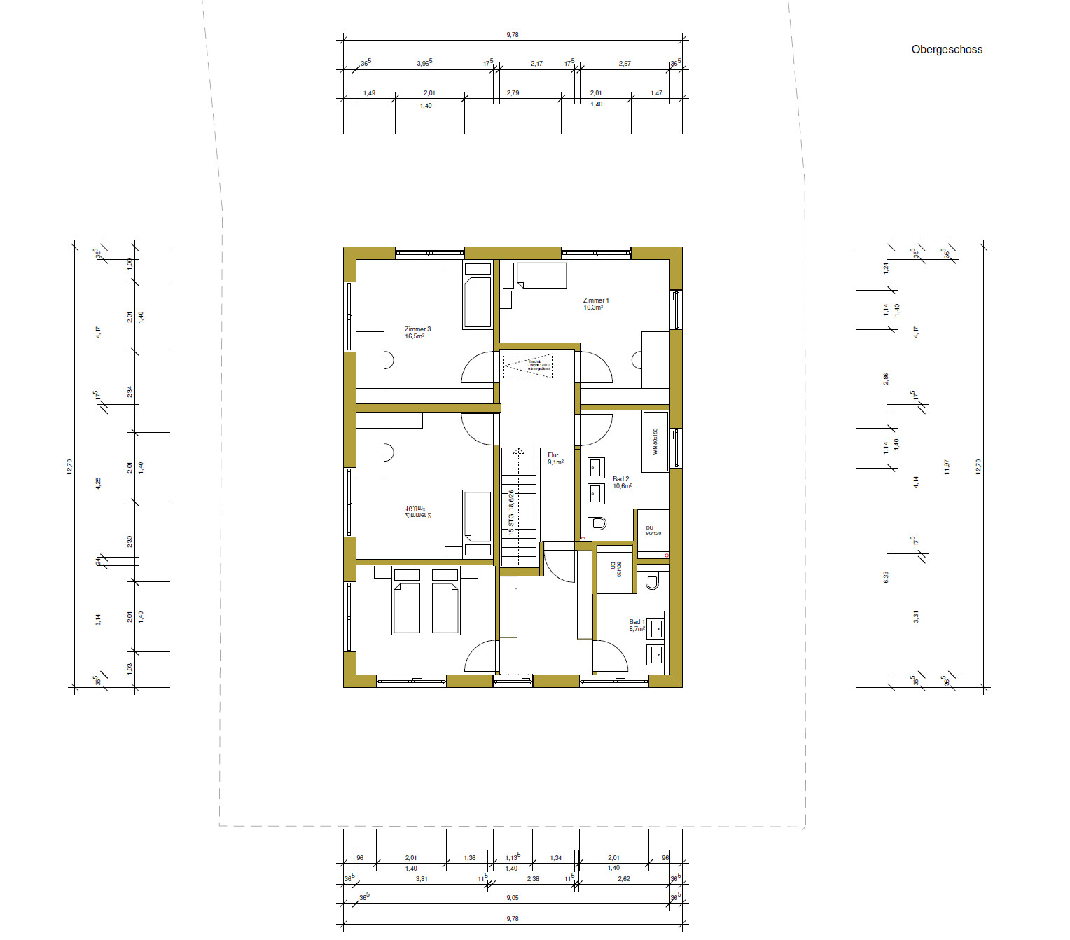

What do you like most? Why? We like almost everything in the floor plan very much, especially the option to use the office upstairs while the children are small and move the office downstairs, and then later move it back downstairs when the children are older.
What do you not like? Why? Only minor details that we would still like to adjust. As nothing will be revised over Christmas, feel free to point out anything we might have missed.

Since we are now slowly moving towards signing the contract, I would like to get your feedback on whether it makes sense to change or add anything and include it in the offer, or if we should reconsider the floor plan entirely.
Thank you very much in advance for your feedback!

With three children, I would never want the staircase to be open within the living area. That’s why I tried to move the staircase downwards so that it ends at the top level in a hallway. I find the reading nook unnecessary; it probably resulted from a lack of options. I would place a home office there instead. Instead of the pantry, you could also create a second small office. Alternatively, reduce the size of this room, move the guest toilet (WC) upwards, and create more space in the utility room. The kitchen is also larger in my plan, which is beneficial for a family of five.
The upper floor layout has also changed due to the shifted staircase (one stair step is now built over). You would have a slightly larger bedroom and a bigger walk-in closet. The bathrooms have hardly lost any space. The windows have not yet been adjusted.
