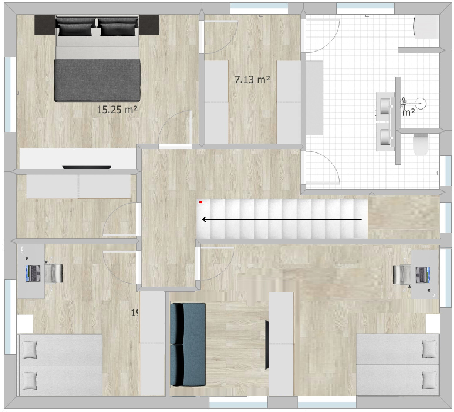

Drasleona11 May 2020 11:17Of course, the space requirements are a bit confusing, sorry.
The office downstairs is my actual office, where I will also work professionally three days a week. It will have a large desk and a large filing cabinet (both already included to scale in the floor plans), as well as a small shelf for the printer. The office will also be used for some private paperwork, that’s all.
The room upstairs is not an office but more of a workspace. My partner has a side job that involves some handiwork, including soldering. There will also be a PC on the table for entertainment while working and for managing private photos and videos. Additionally, this room will serve as storage space, which is why there is a large cabinet planned. Furthermore, it will occasionally be used as a guest room for our parents a few times a year. We plan to have a pull-out bed for this. It normally has a width of 90cm (35 inches) and can be extended to 180cm (71 inches) if needed. Overall, this room functions somewhat like a basement replacement.
I like the idea of frosted glass doors in the bathroom and the storage/workshop room, I have to say! Of course, this is a makeshift solution compared to a proper window, but it would help.
I think it would be quite reasonable to leave the small area "behind" the staircase open and install a window there. Possibly even a tall, vertical window strip stretching from the ground floor to the upper floor. This would bring in more natural light than glass doors and avoid their disadvantages. Additionally, I would position the son's large room in the southeast to reduce wasted hallway space. Attached is an idea for this. Here, you could use a wardrobe as a room divider to maintain a good distance between the sofa and the TV!

New attempt, staircase not built overAnd how do you span a floor with 13 stair steps?

In the last design, everything would fit except for the hallway.This is the point where you have to decide: reverse direction or the Shiny86 method.https://www.instagram.com/11antgmxde/
Drasleona11 May 2020 13:53Curly schrieb:
And how do you bridge one floor with 13 steps?
SabineThe staircase is planned to be 4.10 m (13 feet 5 inches) long. The number of steps is definitely not correct, but that’s not really the point here.
Würfel* schrieb:
I would find it quite acceptable to leave the small area "behind" the staircase open and place a window there. Possibly also a long vertical strip window from the ground floor up to the upper floor. That would bring in even more light than glass doors and avoid their downsides. Also, I would place the son’s large room on the southeast side to use less hallway space. Attached is an idea for that. Here you could use the wardrobe as a room divider to keep a good distance between sofa and TV!Thanks for the draft, that looks pretty good! So you don’t think the light source would be too far away then?
That’s the point where you have to decide: backward step or the Shiny86 method.I would actually like to avoid the Shiny method! But do I understand correctly that you don’t like all these considerations and would rather go back to the large hallway?
