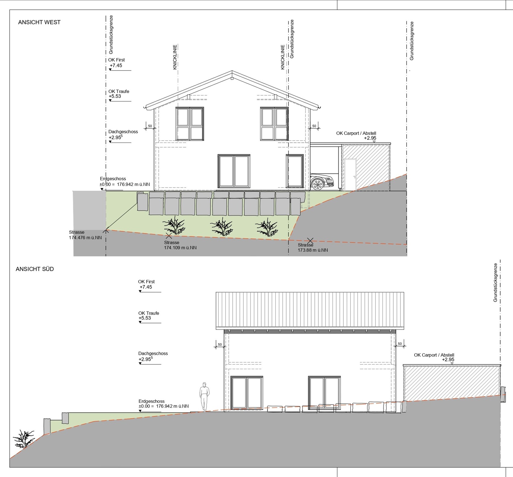

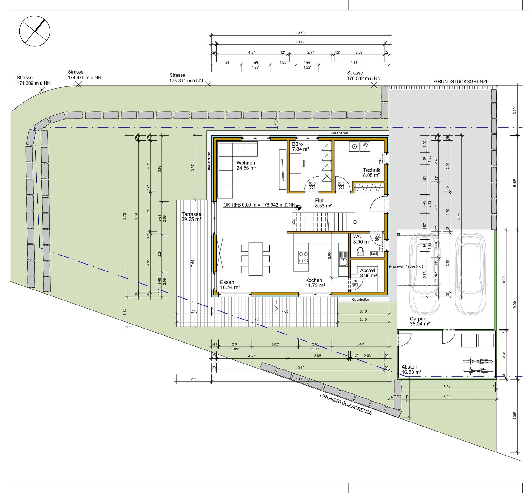

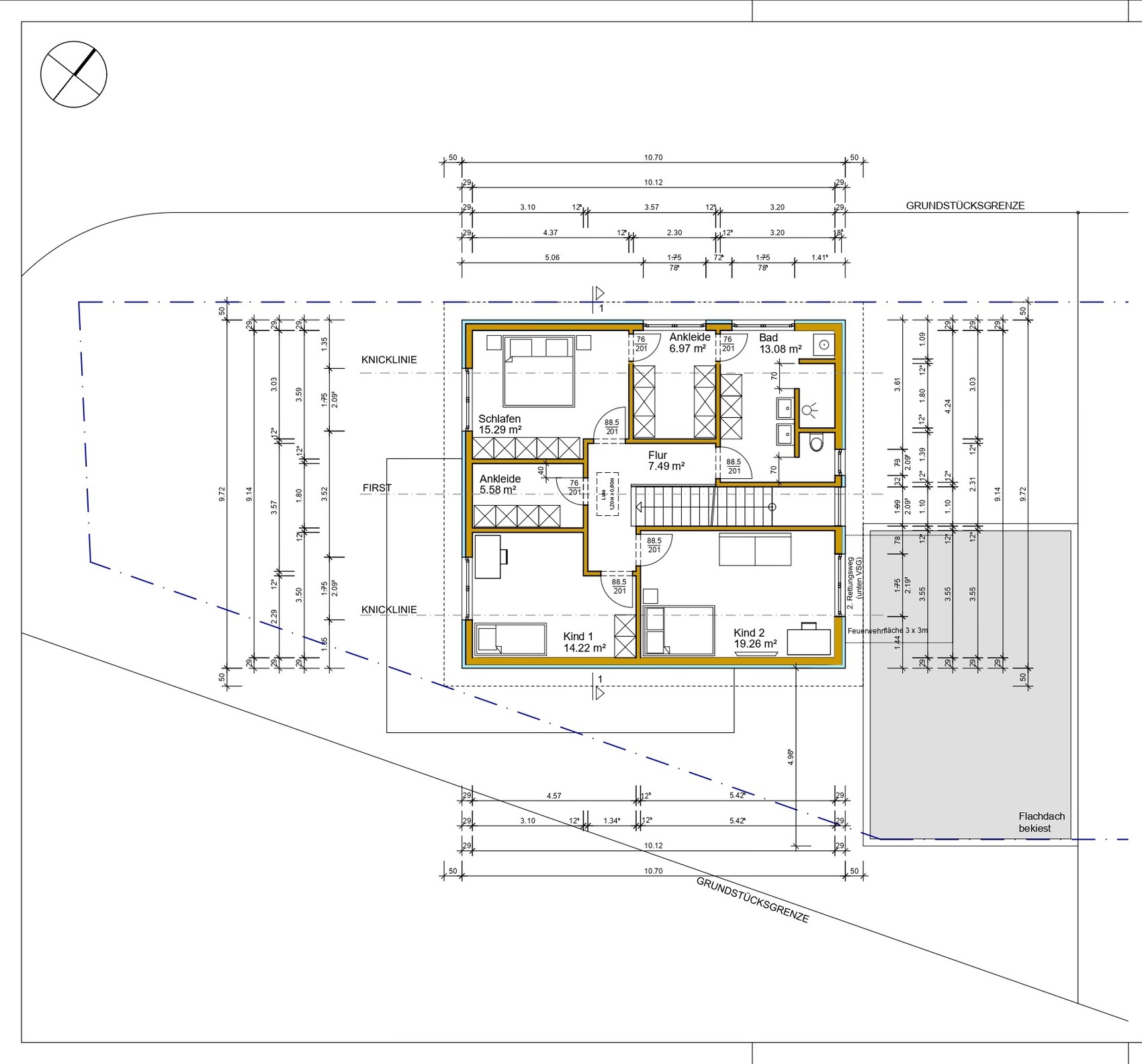

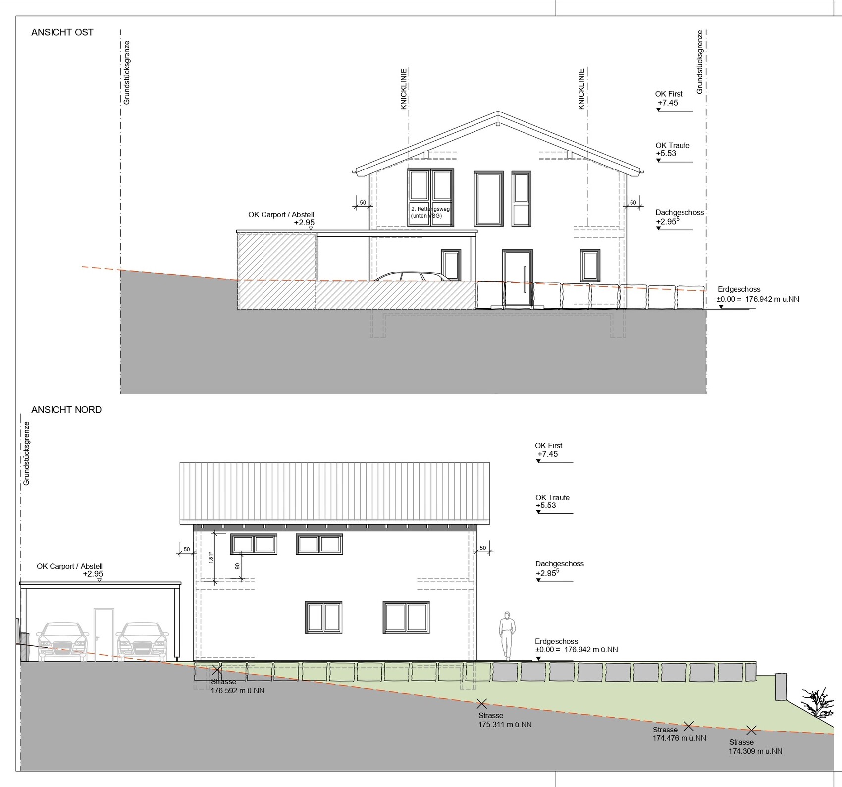

Drasleona1 Jun 2020 09:03Hello everyone,
attached are the current architect’s plans. What you see in the pictures is the architect’s first proposal regarding the design of the plot. We are not completely happy with the details yet.
We know the northeast view is not ideal, don’t worry... but we can’t really think of any suitable options to improve it.
We are currently considering installing two fixed corner windows where the dining table is located, each 2m (6.5 feet) wide and 2m (6.5 feet) high. Perhaps you have some opinions on this?
