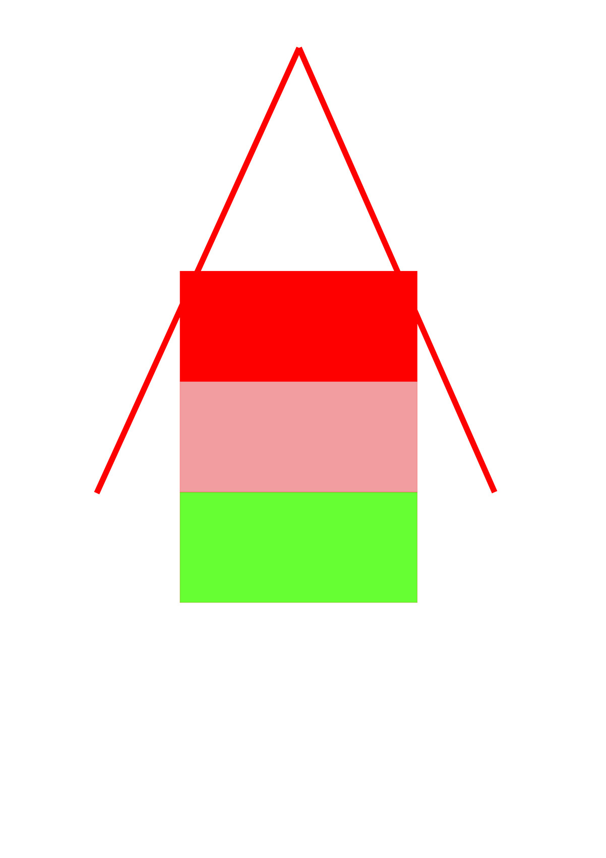

kaho6746 Nov 2019 14:57
Melo_36 schrieb:
"Our eaves point is defined in the development plan, check my first thread where I quoted this from the development plan."
Are you sure your interpretation is correct? That way, you could build something like this, right?
Red triangle over three colored rectangular stripes: red, pink, green.
Scout
6 Nov 2019 15:01
Well, the roof pitch is unlikely to be that generous. Overhangs often fully count towards the gross floor area starting from 50 cm (20 inches)...

Apparently, the designer lacks the understanding that legally, the eaves height does not refer to the top edge of the gutter but to the theoretical intersection line of the exterior wall and the roof covering.
6 Nov 2019 18:34
The eave height is measured from the ground/soil level up to the point where the roof meets the exterior wall.
With a room height of 2.75 meters and a ceiling thickness of 25 to 30 cm (10 to 12 inches) measured from the top edge of the finished floor level (OKBP), you already reach your maximum of 3.00 meters (10 feet).
