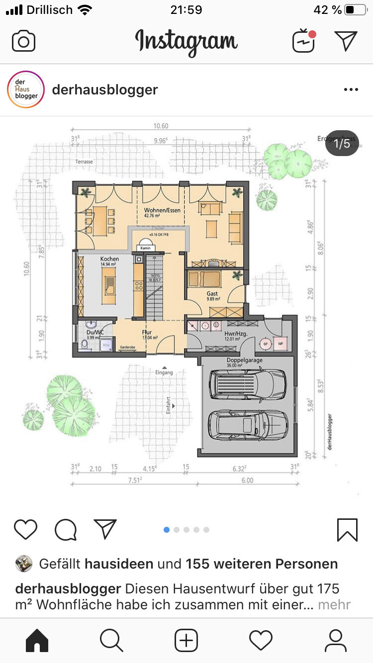

6 Nov 2019 14:15
Thank you all so far for your answers, thoughts, and ideas!
However, I’m still not fully convinced by the sauna suggestions...
Would it be possible, as shown in the following picture, to extend the exterior shell of the house and integrate our guest bathroom with sauna into the utility room? That’s where the original idea of the walk-through toilet came from...
Floor plan of a house with living/dining area, kitchen, hallway, guest room, double garage
