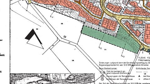

So far, we’ve considered pushing the basement forward so that a terrace could be extended like a kind of balcony in front of the house at this offset. We enjoy the evening sun. Otherwise, I’m holding back ideas and waiting to see what the architect will answer tomorrow to the questions that have come up during the planning process.
Do you know floor plan designs with similar restrictions (slope, floor space index 0.7, eaves heights 3 m/6 m)? Or any other useful tips? The zoning plan is from 1978—can we negotiate with the city about these requirements?
Aerial view of a residential area with parcel boundaries, numbers, and surveying lines.
Aerial map: red-marked plot 577/578 beside street, surrounded by parcels 574, 710, 714.
Excerpt of zoning plan with streets, parcels, and yellow-marked building area.
Zoning plan Rehweg-Hasenwinkel: colored zones, street layout, and legend.

It would be practical to know the textual provisions of the land use plan, especially regarding the boundary line between plots 578 and 577. Two full floors are allowed according to the floor area ratio to site coverage ratio, but a building height of 3.00 m (10 feet) likely conflicts with the city villa requirements. I am confused about the orientation of north here: normally, north is "up" on both cadastral maps and aerial images, as well as on land use plans, but here the cadastral map and the land use plan appear to be rotated 180° relative to each other (???).

The zoning plan indicates north with two overlapping arrows (black and white). Why the plan is rotated... no idea.
Knödellinie? 577 is a land parcel that the city exchanged with the owner back then (to be able to build the road). There are no building encumbrances or easements.
