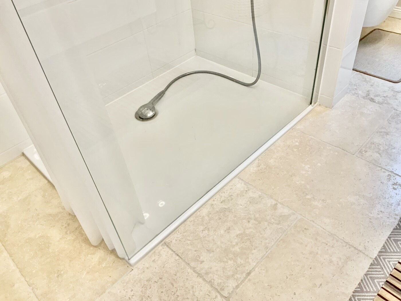

It is/was a 1.20m (4 feet) wide sliding door. Hmm... I can’t quite imagine that a sliding door wouldn’t fit. It would just overlap a bit more... Do you really KNOW that your door doesn’t fit, or are you just THINKING that?
I had similar concerns with our shower wall. The tile installation reduced the original 120cm (47 inches) dimension as well. The delivered 120cm (47 inches) panel was actually narrower and ended up fitting with plenty of space. The side mounting provided enough adjustment to compensate for this.

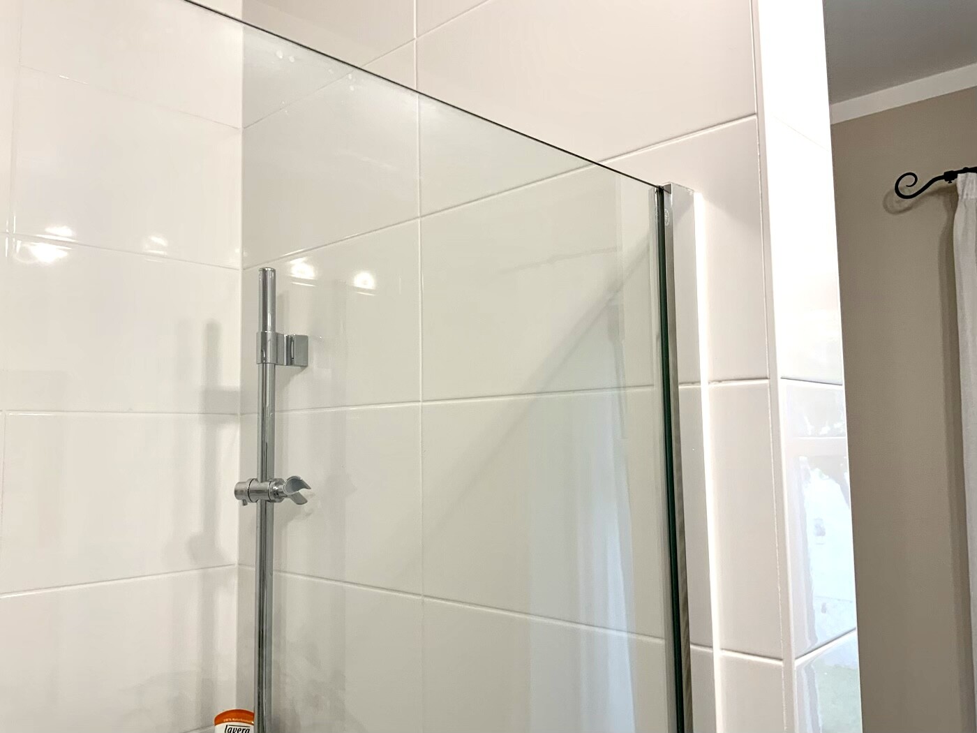

I just measured… our "120" shower panel actually has a glass dimension of only 115 cm (45 inches). The glass is held in place by a metal strip on the side. The glass extends about 2 to 3 cm (1 inch) into this strip (there is still room for more). So there is a lot of clearance… I would bet this is quite common and is used generously to compensate for tolerances.
The measurement service was only added after we raised concerns. The shower enclosure we selected has a tolerance of just 1.5cm (0.6 inches). The plumbing company confirmed again today that the standard model wouldn’t fit.
Thanks for double-checking measurements, @Steffi33, maybe your model is more flexible.
