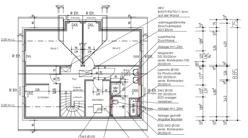

we are nearing the end of our build with a general contractor and have encountered the following issue:
The width of the shower niche in the family bathroom measures only 117.9cm (46.4 inches) after tiling. The rough opening was specified as 124cm (48.8 inches). The shower enclosure we selected for 120cm (47.2 inches) wide niches has a tolerance of only 15mm (0.6 inches) and, based on our current understanding, will not fit. This tolerance seems to be typical, as we haven’t been able to find any alternatives quickly.

Myrna_Loy21 Jun 2021 22:46I would ask how the 3cm (1.2 inches) build-up height of the wall covering was determined. I suspect that there was already an error in the initial structural measurement.
Well... Rough opening is 124 cm (49 inches) – about 3 cm (1 inch) of plaster – double tile thickness plus adhesive, so I’m only at around 118 cm (46.5 inches). Besides, you can never get a rough opening measurement accurate to the millimeter. Who determined the 124 cm (49 inches)? Who coordinated the choice of the shower door?
