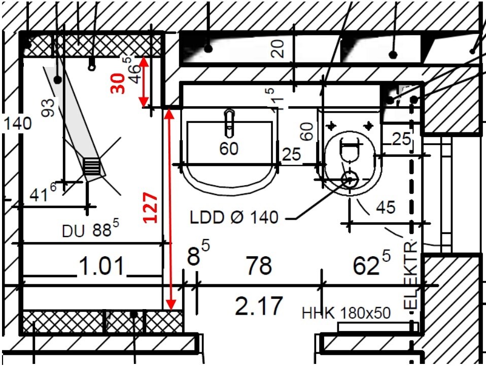

I would like to ask for your experiences or advice regarding a shower enclosure.
Attached is the floor plan of a small bathroom with a shower. To the right of the shower, there is a side opening of 1.27 m (50 inches) leading into the bathroom. What kind of shower enclosure would be suitable here?
1) A fixed glass panel, for example 67 cm (26 inches) wide.
This would leave a passage width of 60 cm (24 inches). Is that enough?
This would cover 97 cm (38 inches) of the shower area on the right. Is that sufficient?
Or would water then splash into the bathroom in the remaining 60 cm (24 inches) where the open entrance is?
2) Or is a glass sliding door with a fixed glass section needed, allowing for a passage of about 60 cm (24 inches)?
3) Any other ideas?
Thank you in advance for your input.

hampshire5 May 2019 11:08On the wall of the shower area, opposite the shower, there is something drawn that looks like a chimney. If that is a projection, the 60cm (24 inches) passage will be tight.
Go to the glazier and have a custom-made unit with a fixed panel and a hinged door made to measure. That costs hardly more than a DIY store solution.
hemali20035 May 2019 20:05We have something like option 1, and it works well. After showering, you just need to wipe away about 30 spots, and everything is fine. It’s better than doors with seals, joints, etc. We don’t have any glass or a door at all, which makes it wonderfully low-maintenance.
